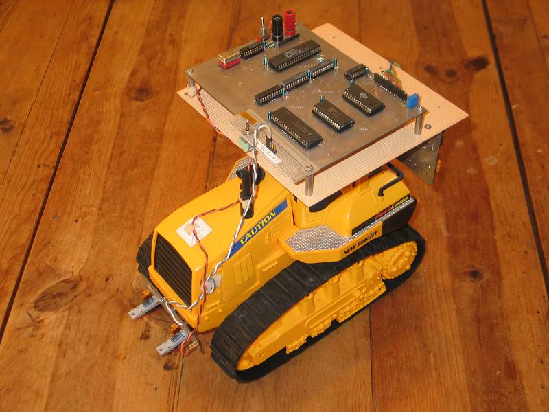

Greetings All,
Here is my first robot, a line following robot (black line). Its based on the Intel 8088 microprocessor and was built for a class I was taking at college. It has photo-interrupters for line detection and a pair of H-Bridges for motor control. I chose to fabricate the printed circuit boards rather than use wire wrap because I had access to an LPKF M60 circuit board plotter and I knew it would be more reliable as well.
The bulldozer platform was a Toys-R-Us wired RC control toy purchased for $20. If I recall the blade of the dozer was not controllable. I think I'll modify it over this Christmas so that it can be run by a Freescale (Motorola) MC9S08QE128 DEMOQE128 low-cost evaluation board I recently received for attending the Freescale Coldfire V1 Seminar. You can get the same evaluation board from PEmicro.com or any number of electronics distributors for $99.

ORIGINAL: Access
Intel 8088... I haven't seen one of those in 15 years. When was that built?
. The curricula at Cal State Long Beach had everyone using that processor for their junior level Microprocessor design course. They have since switched to a Philips 8051 variant, I think it was the P89V51RD2 and now they are using another 8051 device variant made by Atmel.I'm assuming that the reason they force the students to use the 8088 is because you have to use support chips to access the lower 8-bits of the multiplexed address and data bus along with the bus decoding and interface duties you're required to implement. I guess it makes for a good introductory academic exercise in hardware and software development.
