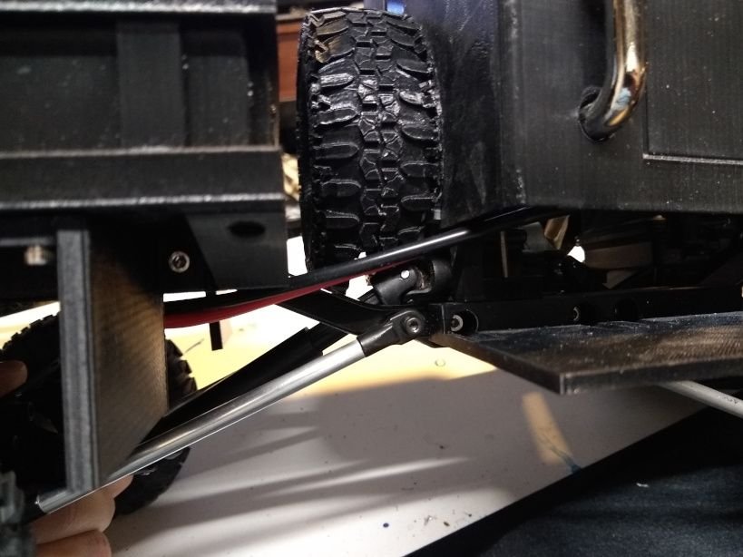

Well made new rear rail extensions
I found a piece of c-channel I salvaged out of a no-name broken food vacuum storage thing a few months back, and held it upto to an axial rail, and was shocked how well they fit together. So I cut it in half, and it was literally the PERFECT length to the point if it was 3mm's shorter it wouldn't have worked..
Anyways drilled holes in them. I drilled the one side, and then I took the other ,and just taped it together, and drilled through to mirror them perfectly
I decided to paint them black... but yea that was pointless as you can see in the pic below as the paint scratched up to high hell even, and didn't bond well in others. Might be cause the primer can was real old, or due to the extremely high humidity and temps, but not like it matters as it is completely covered anyways.
I had to redo all the chassis stiffeners, and even the leaf spring mounts as the c-rail is a bit wider then it was with the bronze tubing. But yea this also brings the leaf springs into alignment with the mounts on the axles where prior it was a little bowed.
It is now really solid, and perfectly straight. The bronze tube wasn't perfectly straight, and it was crushed in at points a little bit, and would wiggle a bit back and forth so the wheels weren't' even perfectly straight. Also the holes on the bronze tubes I used weren't perfectly aligned with each other
Also the bed I made barely fits. I thought I might have to cut a bit of it up underneath, but its such a close with the screws that you can't even get a fingernail in between the screw of the leaf spring shackle, and the beds rail

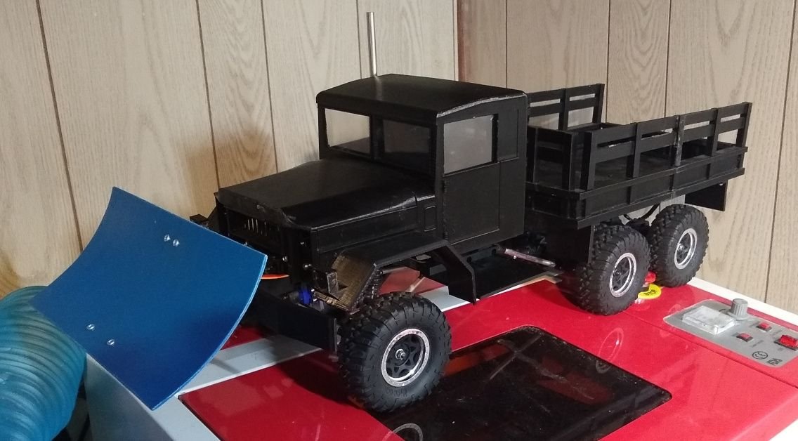

#29
well cab is basically done. I need to get some magnets for the hood as I decided to make a bracket, and screw the cab to the front bumper.
instead of being glued, and looking like crap like the old one I took all the parts that were scaled in the cad program, and assembled them so there were less parts to print, and assemble. I also modified them to screw together.
Basically the sides, front windows, rear, and roof are all one piece, the front grill is a separate piece, the front fenders are separate, and the hood. The fenders are held on with 5 screws each to make them secure, and the front grill screws into a bracket(4 screws from the front) that connects the 2 sides, and borrows 2 fender screws on each side to make it nice and rigid. The bracket that holds the front grill on I made it to screw into the front bumper mount, and drilled 2 holes in the bumper mount to make it nice and solid.
I made the turn signal bracket that screws to the front fenders they just aren't put on yet
I also have to find the front headlight parts I planned to use, and try to figure out where I put the exhaust pipe that screws on the cab side
The painting is going to have to wait until spring as its now too cold to paint around here.
The vehicle in the bed of it is a 18th scale HPI Mini Recon showing how big this sucker is
Funny how I started it 10 years ago, and basically scrapped the majority of what I did in that time to redo a good chunk in the last 4 months >.>

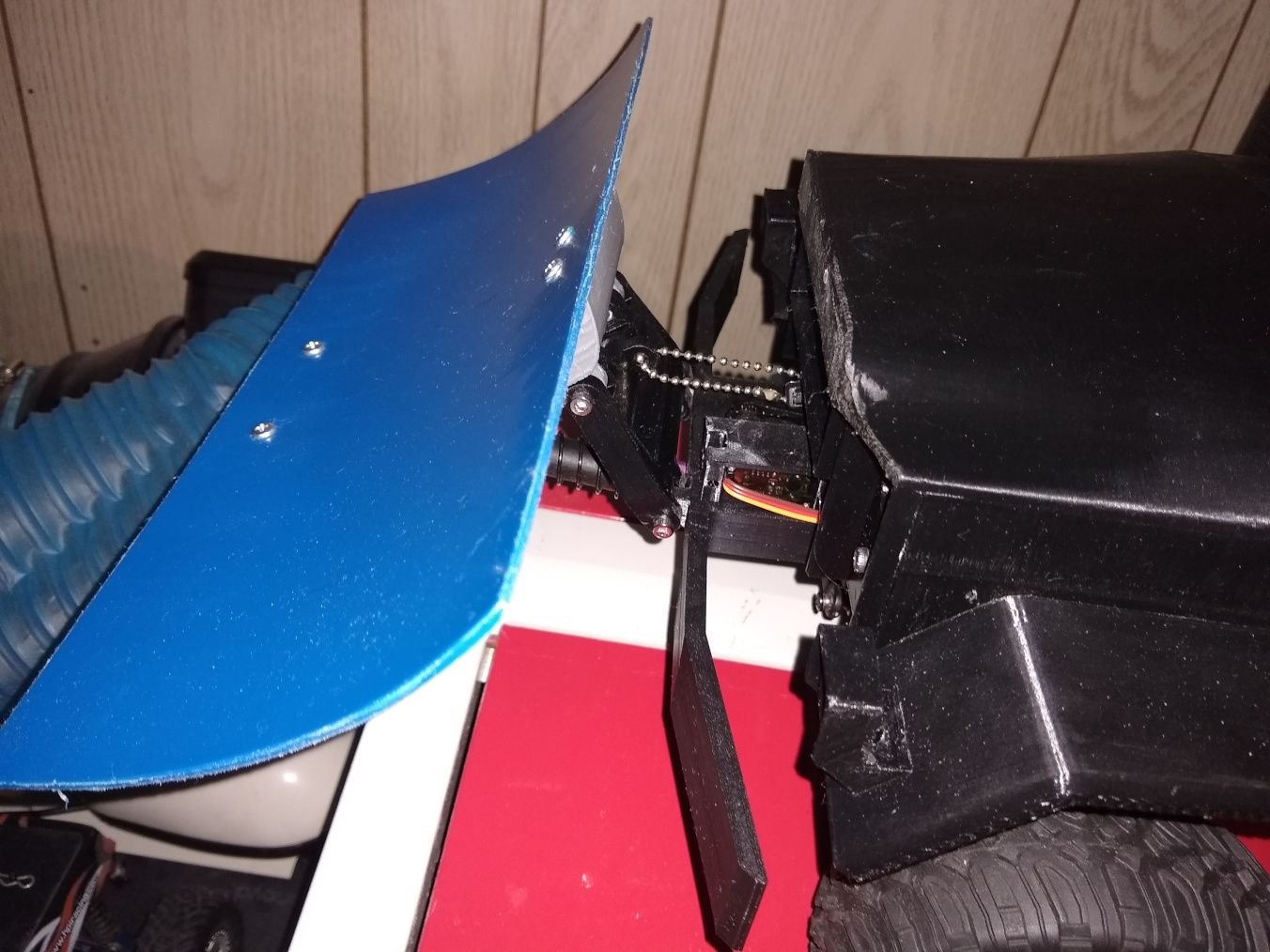

I made a new bumper with a mini servo mount that sort of looks like a winch in the spot a winch should go, and I put 3 mounting spots on the bumper for a snow plow, or other accessory. Snow plow attached currently.

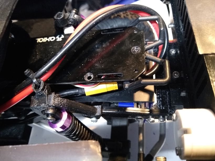

You can also see the bracket for mounting the back of the cab to the chassis in the bottom pic, and how I also had it make a shelf to mount things to like it was in the original picture.

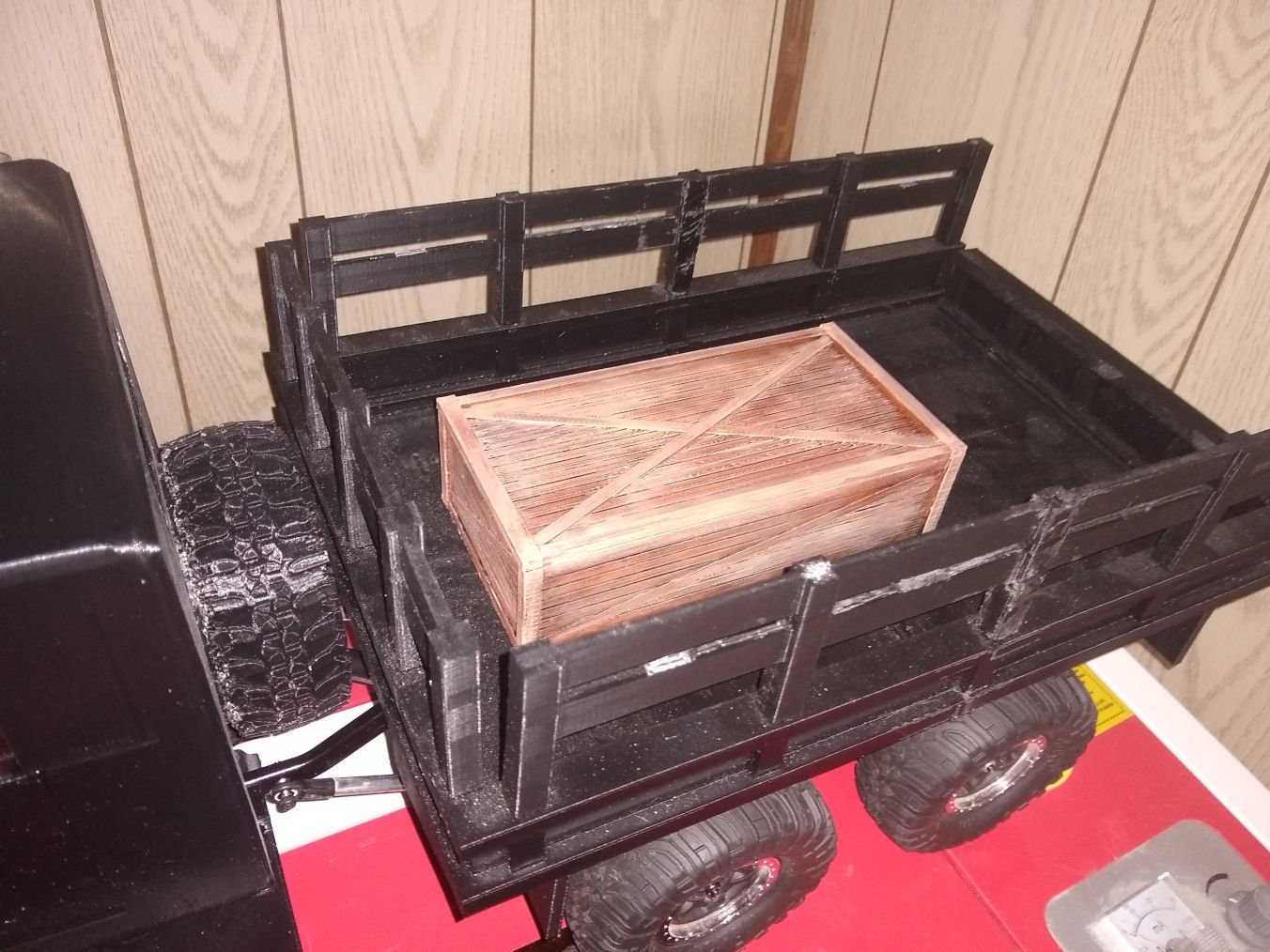

#32
Well here is the new tentative battery box
I kind of like how it looks will also solve another issue I am soon going to hit as to where to put the added electronics when I get them as I can put the electronics in the front where the battery tray currently is.

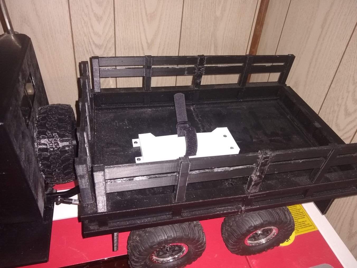

Well I got around to finalizing the battery in the bed
To start things off in the software I used to make everything I took the battery tray, and the box, lined them up, and took the negative. I also added 4 squares in the size of some neodymium magnets that I harvested from a broken outrunner brushless motor.I had.
I then cut out the opening for the wires
After that I removed a little material from where the magnets were going, and then I took one of the magnets from the bad motor heated it up (making it worthless), and used it to press into the spaces I made so the magnets will have a firm fit.
After that I ran the wire, and installed a 3d printed grommet to cover the slightly jagged hole I cut.
And no the tray is not crooked it is perfectly straight, and the battery is in the tray crooked.
and to just show how it was ran as I zip tied the wire to the frame to keep it out of the way of the drive shafts.
I would take out the tray to put it possibly in my jeep build to replace the printed one, but I didn't feel like unscrewing the top, but when I eventually paint this, and have to disassemble it I do it then. I would have painted it last year, but stuff happened(air brush's valve breaking, stuff happening, and arthritis flareups), and when I finally had time, and the equipment to do so it was too cold already >.>
