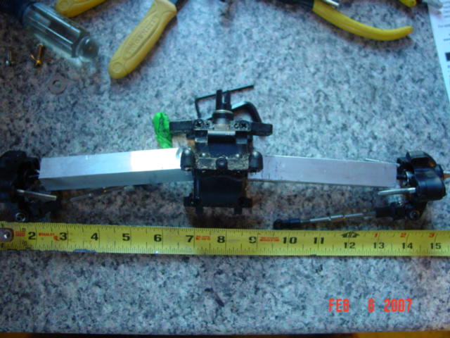

Default RE: please help, would like some info on planetary gears
almost finished a set of axles. this is taking longer than i thought, at this rate i will be done by the summer. only 2 more axles to go then the fun really begins.

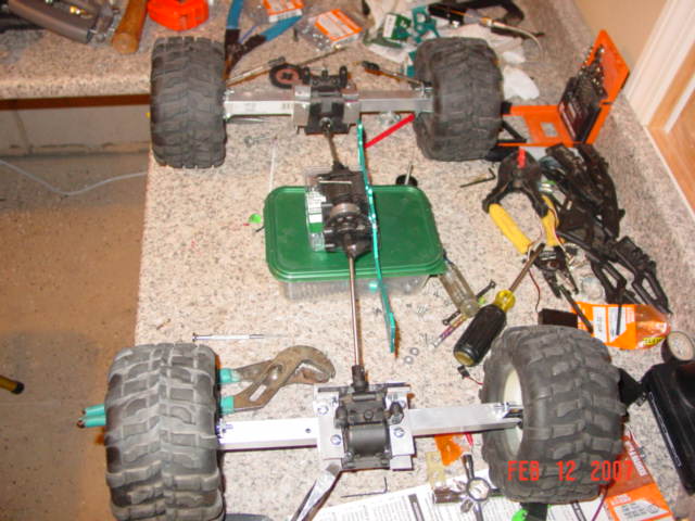

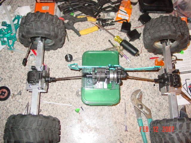

so far the axles are done and now the placement of the tranny. the tq has reverse so i will use it, so there is no need for a reversible esc. i have seen other crawlers with the shocks on the 4 link or on the axles, is there a benefit for either or just pick one and see how it goes.

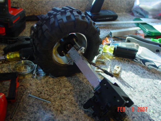

Old 02-12-2007 | 12:22 AM
R/C fan-addict's Avatar
Joined: Dec 2005
Posts: 3,589
From: Belmont, MA
Default RE: thunderquake crawler.
wow that looks great! It's really coming along! As for your question about the lower shock mounts, mounting the bottom of the shocks on the 4 link is only really used if you have a very tall chassis, tiny shocks, or you want a very high sitting chassis with a high center of gravity. I do think, though, that attaching the shocks to the 4 link will allow greater articulation since the shocks won't be able to bind, but I'm not sure if it is a big difference.
Old 02-12-2007 | 01:08 AM
jombo's Avatar
Joined: Apr 2005
Posts: 2,417
From: trumbull, CT
thanks for the answer, it would be alot easier on the 4 link than the axles. now i need to make some templates in the chassi desighn

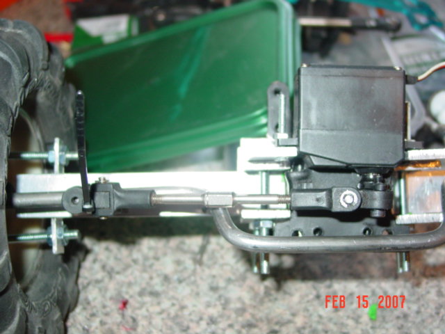

Old 02-16-2007 | 04:21 PM
jombo's Avatar
Joined: Apr 2005
Posts: 2,417
From: trumbull, CT
i have just finished fabing some mounts for the steering servo and mounts fot the shocks and 4 link. i think i over did it on the steering rod its 1/4inch thick, it does looks nice and beefy though. the steering servo is a mgs with 160oz/inch.i am still waiting for parts so its at a standstill till then or till next week.

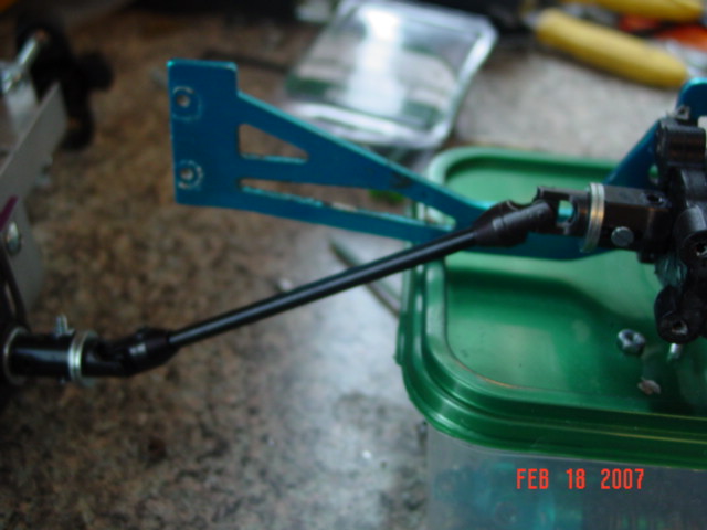

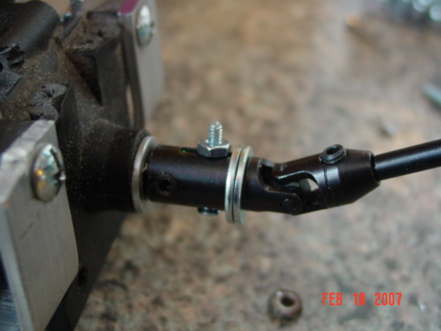

Old 02-18-2007 | 12:22 PM
jombo's Avatar
Joined: Apr 2005
Posts: 2,417
From: trumbull, CT

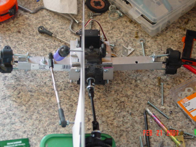

i just modified the quake crawler, i made some universals for the tranny. now i just added 1'' more clearance in the center. thats a total of 4 inches without the tires. i have a variety of tire choices, jumbo kongs , hpi savage tires , cen gennesis, or the moabs xl 40,or even the lst1. all the parts are in except the motor, i orderd it from harbor freight so it will be here maybe next week. i do need to say CUDOES to CUSTOM RC CARS AND KILLER HOBBIES for their 'FAST' turn around on the order i placed with them, thanks again.

started the chassi build and finally decided on a design. i am mounting up all the parts now so i have a template for the other side so i can just drill the holes in line. i am still undecided on the shocks, i like the cen shocks because of the look but like the lenth of the savage shocks. their only a 1/2 inch longer but makes a noticible difference.

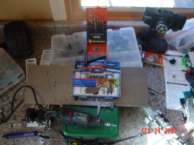

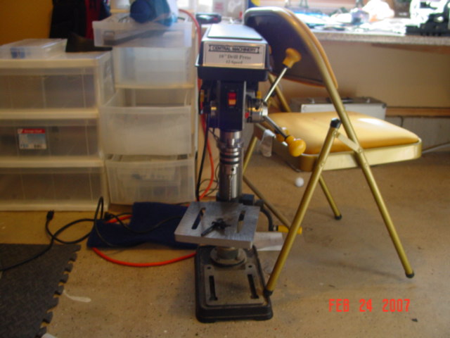

thanks for the compliment. i am making this for the average person that dosent have machining skills "ie" me.i love monster trucks and when i could'nt get certain parts anymore for this truck i wanted to make it into something else. all my tools are store bought and nothing fancy the bandsaw i used for a while is a 10 year old delta which is made for woodworking but they sold the metal cutting bands fot it. the only thing i did was use a bag around the motor so it would'nt short out. i also use the hacksaw and my favorite the dremmel. to make all my starter holes i use a drill press and a vise that is adj forward and back and left to right and some hand tools.there is nothing on paper except the cad drawing i did for the frame and that cad design program is free on the net.

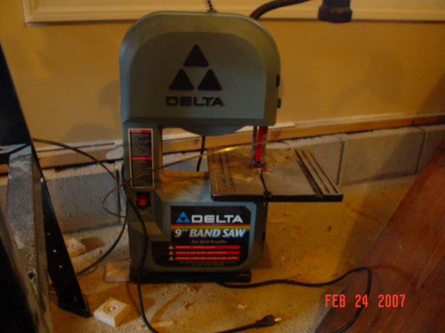

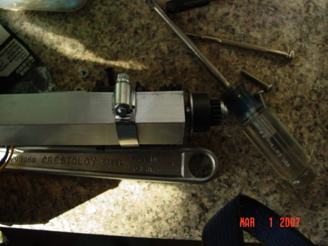

why?
i'm sure you have a reason, i'm just curious. i haven't had any problems with mine and i use basically the same set-up. my bandsaw is a 9" craftsman made for wood but i use the metal blade as well.

on the motor housing there are holes and you can see the copper winds. i am afraid that if some metal shavings got sucked in it would short it out. what i put around the motor is a pre filter from a rigid vacume. it fits perfect around it.

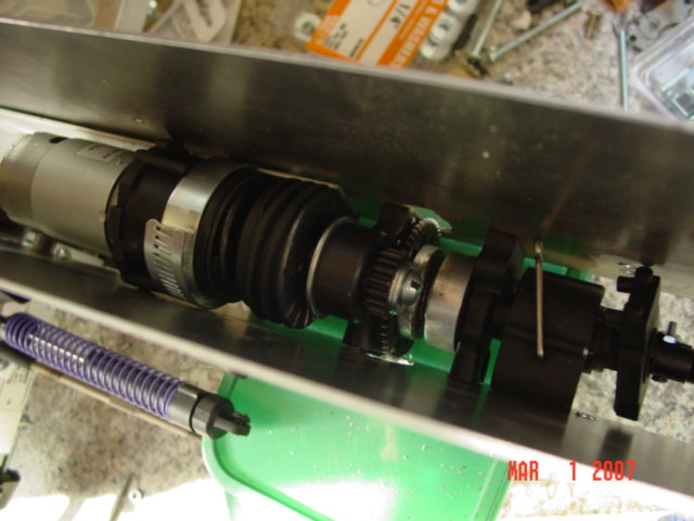

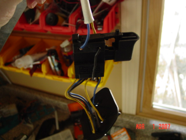

Old 03-01-2007 | 09:34 AM
jombo's Avatar
Joined: Apr 2005
Posts: 2,417
From: trumbull, CT
Default RE: thunder crawler.

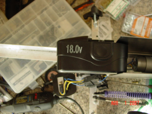

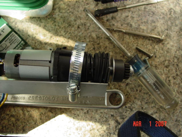

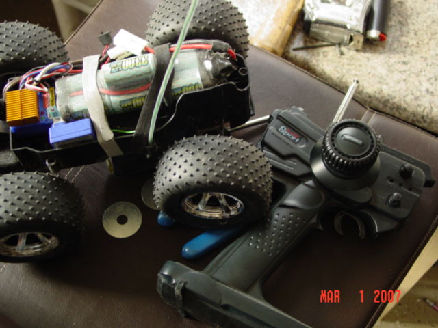

here is the drill and gear reduction, and the batt and speed controll.its a simple setup but now it all needs to be mounted. i also made this truck from a newbrite, i added a s400 rocket motor and a speed controll and a radio. the radio gear will be taken out and put in the crawler. with the sides up it looks like a steel plane, it will never fly but it will be easy to mount the servos with some blocks on the side of the frame.
btw the newbrite is a bit faster than before, its fun outside but dosent have a suspenion and flips easily at speed.

Old 03-08-2007 | 09:08 AM
jombo's Avatar
Joined: Apr 2005
Posts: 2,417
From: trumbull, CT
i have a question, the motor i installed has a gear reduction of 500rpm and solid torque but its slow. what i mean by slow is it maybe goes 2 or 3 mph the zipzaps are faster than it. do i need speed and slow torque or just leave it this way slow and torque'ie.

That is a cool band saw from harbor frieght. Will it cut metal?

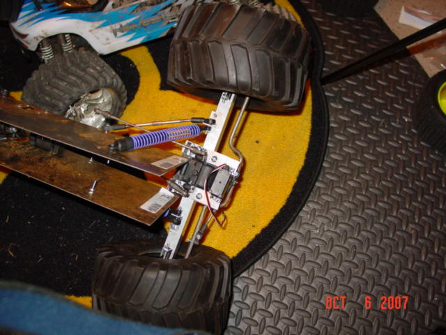

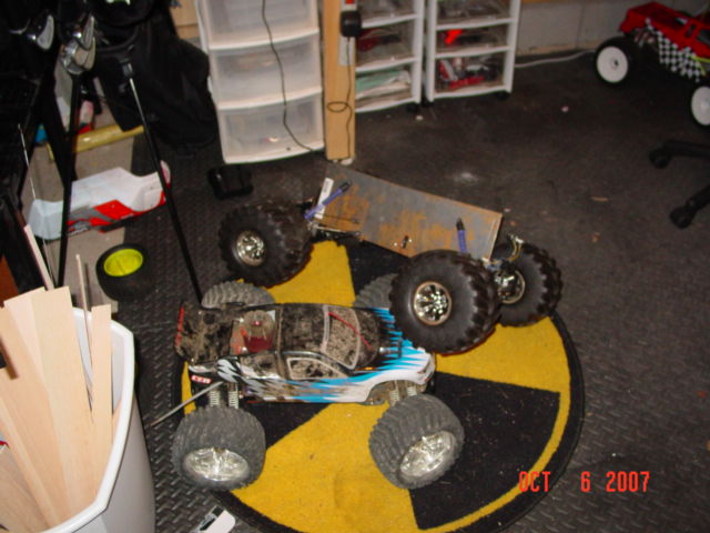

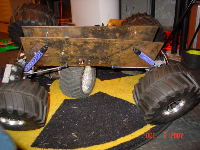

sorry for the late update but i have been busy with other things . here it is almost finished, i just need to cut the sides and finish up the 4 link and install the radio gear and its done . i have the jumbo kongs on now with no foam in them but will go with a smaller tire later, its bigger than i thought but i could always shrink it down. its bigger than the nemesis if that gives you an idea how big it is (24 inches long and i dont know the width maybe 18 or 19 inches). the pics show it on top of the nemesis and i didnt put it there for the pic i drove it up there with no problems. it has the trigger speed controll from the grill and the 18v batt and i just pionted it at the nemesis and it drove right over it. cant wait till its done.

Old 10-06-2007 | 10:47 PM
The Real Dogman's Avatar
Joined: May 2006
Posts: 2,256
From: Pontiac, MI
Jombo how did I miss this build!!???!! good going very ambitious!! I was about to reply to the PM you sent when this thunder crawler link showed up in my mail!!

lol,, I'm glad I inspired someone to build something different!!! I lke the idea of using the 18v cordless motor and gear..It funny because I am in the process of designing a new Stealth style tranny for the Wheely King tuber I'm building.
