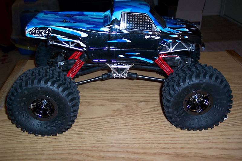

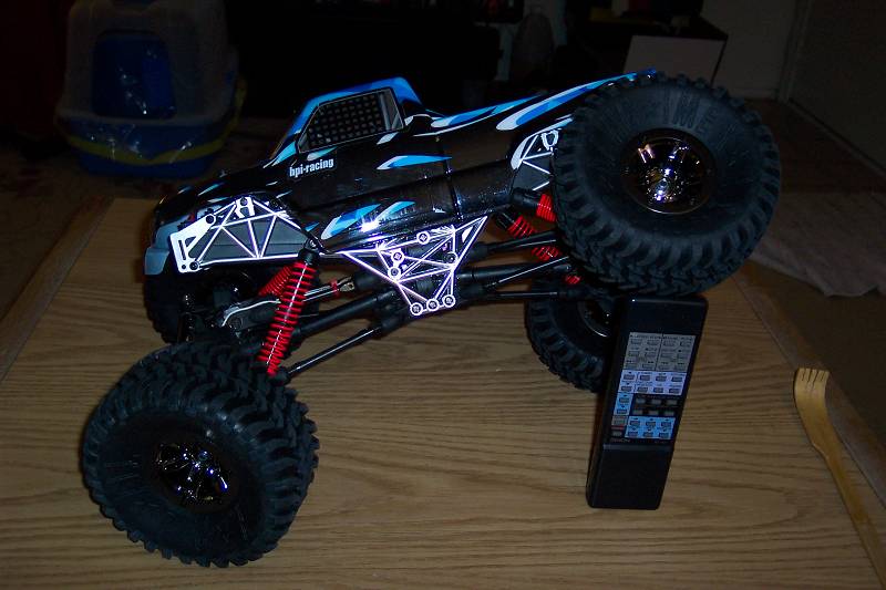

The Real Dogman's Avatar
Joined: May 2006
Posts: 2,256
From: Pontiac, MI
Default RE: OFFICIAL WHEELY KING CRAWLER THREAD
Wolf, some people are using Tamiya Stays but my rod ends require something bigger, so I used 1/2" aluminum u-channel you can get at your local hardware or home improvement center.
[link=http://picasaweb.google.com/TheRealDogman/WheelyKing?authkey=KVBM0R73K2Y]Wheely King Pictures[/link]

Old 06-24-2007 | 05:48 PM
Joined: May 2007
Posts: 73
From: Vancouver, BC, CANADA
well I've extended the wb but I havent mounted the upper links to the axle and lhs doesnt have any suspention stays and all the websites I've been on are on backorder. I'm realy hoping I can get all of my parts togeather before vacation. Ill check the local hardware store see if they have any "u-channels." Also does anypone know where I can get a servo mount? I've been on the venders area of rccrawler but I dont like ordering Items via e-mail. some help? please and thanks.

Old 07-08-2007 | 08:03 PM
Joined: May 2006
Posts: 2,256
From: Pontiac, MI
Here's a couple shots of my WK right after installing some custom upper links I made from 3/8" delrin sheet
Hope ya like em
