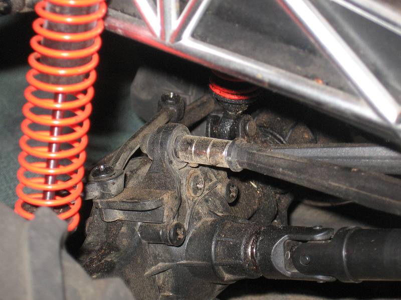

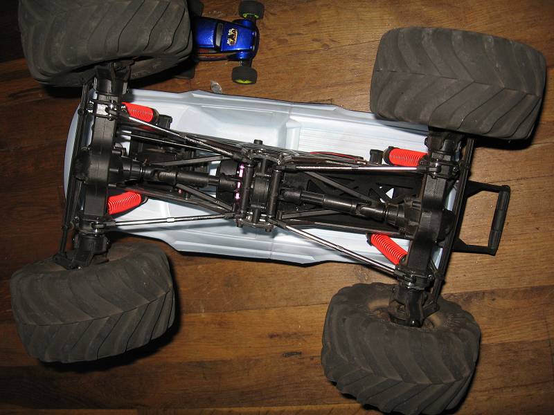

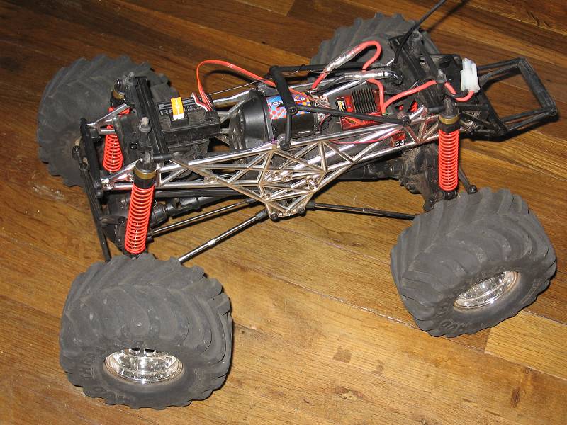

I lengthened mine with collars and extended bars, lengthened main servo bar and used brass tubing cut into rings to tighten the shock caps and pevent them from stripping out. Also had to use after market drive lines as the stock ones were too short.
Also had to replace the motor and speed controller. First update was a better 300 ma battery and prophet charger. everything else cam later. Still havnt lowered switched main gear for lower speeds more torque as the cover wont fit if you do that. THe guy at the local HS has reversed his shocks so they are upside down and has a much larger main gear off the main motor pinon.
This thing is so fun!
more later!

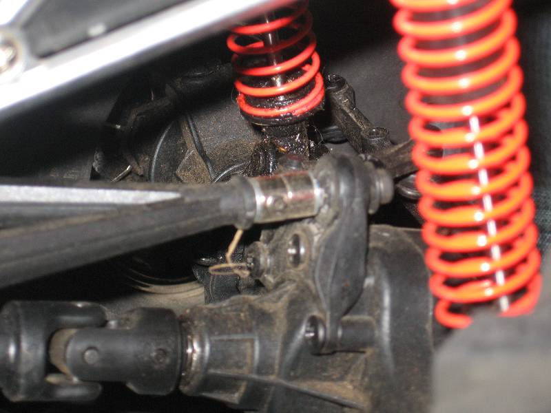

The guys at my local hobby shop showed me these mods. The 5/8 brass tubing fixed my stripped out shock caps. I love my local HS!
They used a hot glue gun to lock the diff, figuring if they change their minds they can heat it up and let it melt out , lol.
(well, that's the idea anyway)

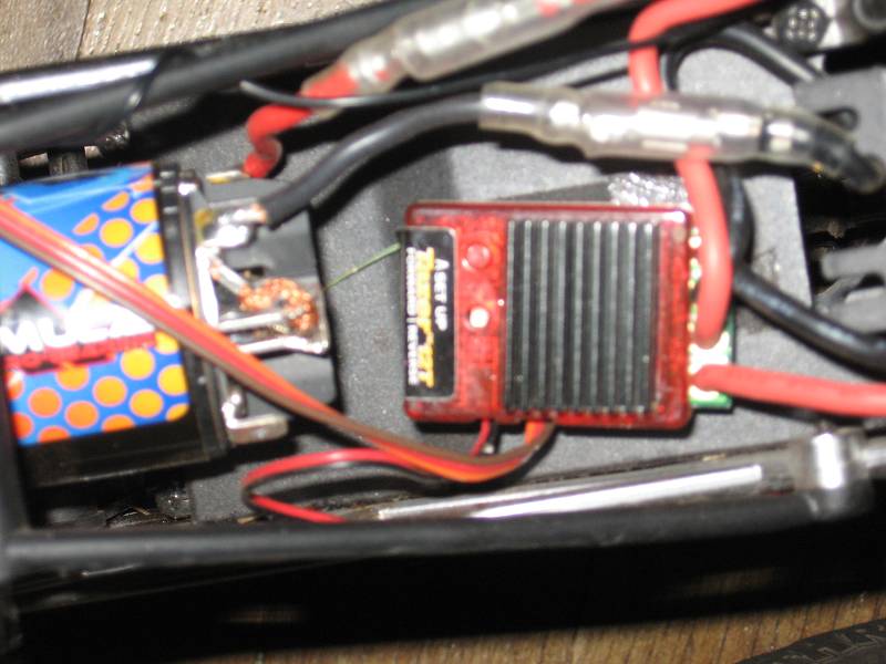

argh the photos are blurry! the new speed control is a tazer 12t and the motor is an Orion Formula Probearing 19x2.
the little collars are the same as the flyfar wieght collars off my blade cp pro, so I dont know what to call those things I used 2 on the front and 3 on the back.
I used Traxxas#5139 116mm turnbuckles for the rear toe control links and 106 mm for the front. I also used Traxxas DRive lines but I lost the
pkg with the part number, DOH! I hate it when i do that!
here's some close ups of the collars and brass caps on the shocks
