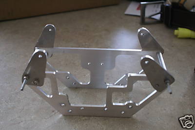

has anyone ever seen or used this chassis? i want to put a rustler tranny in it, and wondered if anyone else had already.

Looks like a Bulu 2 chassis. It's designed to use a Stampede tranny, so if the Rustler tranny has the same mounting bolt pattern, it should work fine.

The Xl-1, Xl-5, and VXL models of the Stampede, Rustler, and Bandit use the same transmission.

thanx for identifying the chassis. i searched yahoo, this site and other places, but everything i came up with was old and the pics didnt show up. i was really hoping to see some pics of the tranny mounted.

The tranny mounts vertically in that chassis if I remember right.
As for a cantilever setup (like a Revo), my Goliath crawler used to have that. Needless to say, I swapped it all out with a standard shock setup long ago. You can get good articulation, but the cantilever setup requires more parts than a standard setup. More parts = more stuff that can break/malfunction. I'd say it's easier to tune a standard setup too. You can change shock angles in addition to spring rates and oil to fine tune the suspension. The same can be done with a cantilever design, but it requires swapping in new cantilevers with more/less leverage and I don't think there's a huge selection of cantilevers out there.
