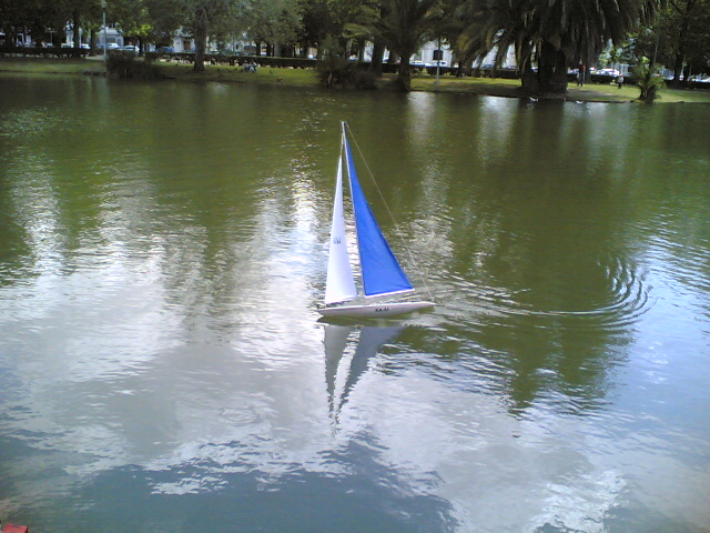

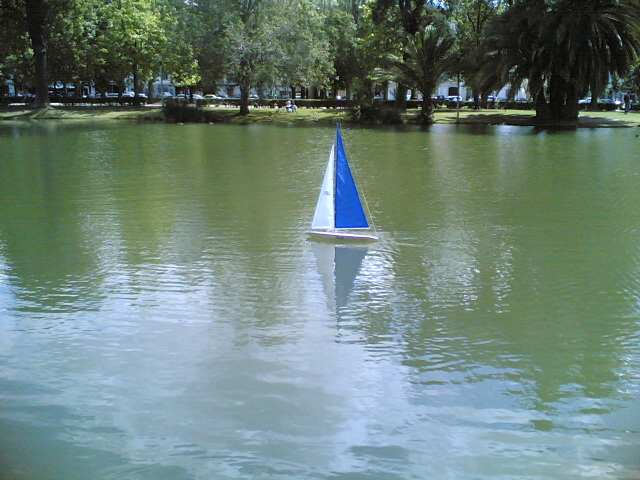

Looks good Luis!
You haven't had time to add the sailbattens I see, the rear edge looks a big baggy...
I know it's hard to sail AND take pics, but could you post some more, showing the sailshape , viewed from the transom?
I'm curious as to how the extended top looks.
Regards, Jan.
