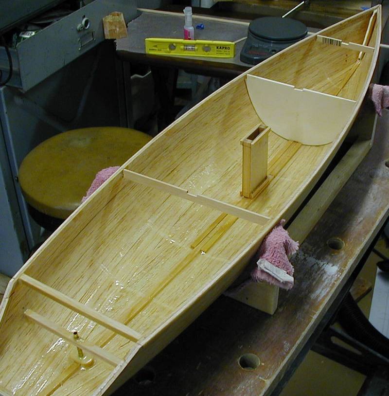

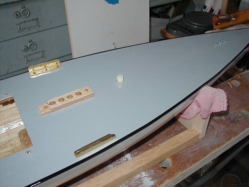

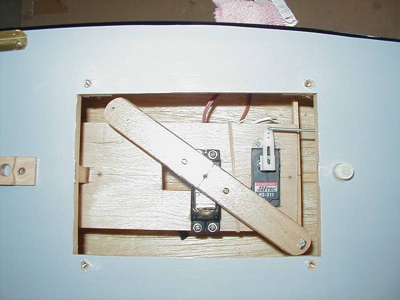

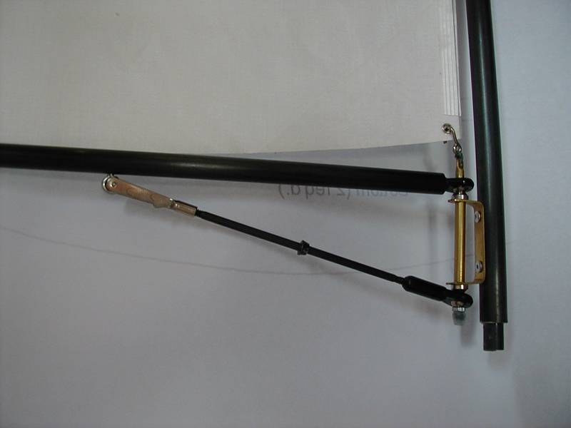

Here is a picture of my boom vang. I used rivets - but they cracked the mast tube so I removed them and epoxied a sleeve.[img][/img]
Also a pic of the mast step and chain plates. The rear hole in the mast step is where the keel bolt exits the deck. The white thing is the jib sheet exit.
The deck is grey monokote wing covering - I figured that I may be doing some mods and didnt want a solid deck. And another shot of what the structure looked like before monokote was applied. Cross braces for keel support, chainplates, mast brace, reinforcement for jib boom swivel location. Backstay will be on tang mounted to the flat section of the transom. The small plywood piece on the keel trunk holds the front of the radio control board. Batteries are a flat 5 cell AA pack that will be under the board and the receiver is velcro'd under the deck beam next to the keel trunk on the opposite side that the jib sheet is ran.
cheers for the pics mate any more?
,also thanks for the heads up on the rivets i was thinking of just wrapping the bracket with dacron and ca glue.

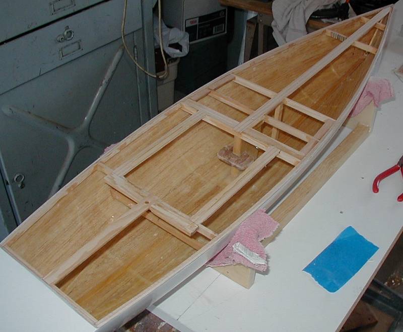

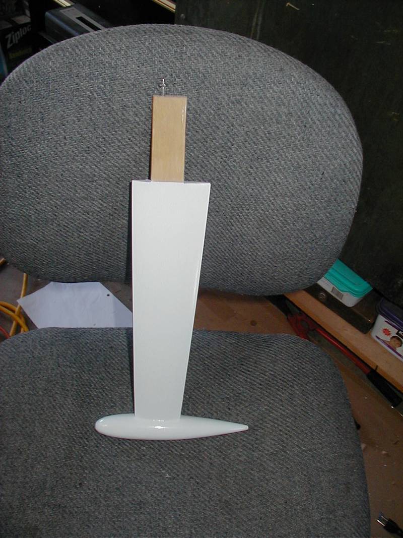

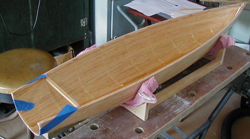

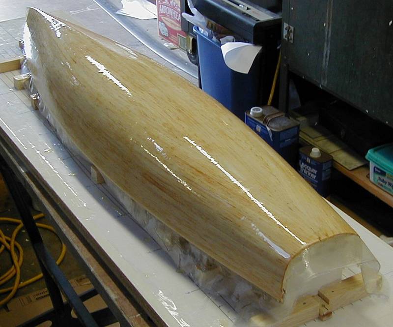

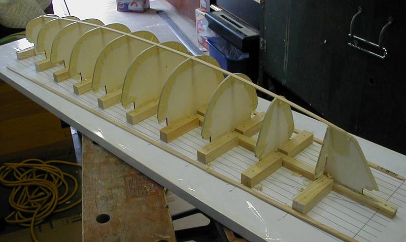

Ill try to get some more pictures for you - Stations on building board, glassed, keel, hull interior with keel trunk and after pull from stations. A tip I picked up somewhere - when sanding / fairing the balsa I used lightweight wall spakling. It sanded easy and I didnt care about the white blotches since I was going to glass and paint.
looks great mate youve done a great job on it i like the keel arrangement ,is it a removable keel?.keep the pics coming id love to see how youve progressed with it so far.what lengthe is the hull? mines gonna be 33 inches.thanks again for the pics mate is this your 1st build? i was a boat builder for a few yrs after school some years back .i actually built a few boats using the planking method so i should be ok with it
at least i wont need to put the planks in a steam box to bend them
.cant wait to start mine now ,how long has it taken you to build yours?.ill look forward to seeign more pics of her shes gonna be a real nice boat.

Regarding the sails - no you dont have to make panel sails. I just want to learn to make a real nice looking set and with properly made panel sails they will have a better shape and look more realistic.
Its my first build and so far Im really happy. Followed the balsa planking procedure in the US1M construction guide. Once started it went real quick - with thin CA glue I was planked in one evening. Not sure how many hours I have in it (dont think I want to know). I would have to say that I have probably spent more time researching methods and materials then actually building. If I build again Im sure it would be much quicker.
The keel is removable - upper bolt protrudes through the deck / mast stem and a nut will hold it in place. The keel construction is based on the hollow, ply with internal alum tube method described in detail in the US1M construction guide. I even followed their method for casting the lead bulb in two halves.
Boat is abit under 36"
