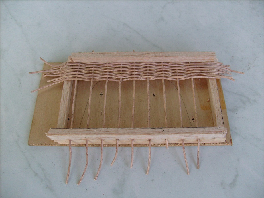

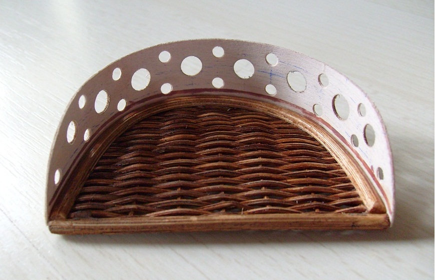

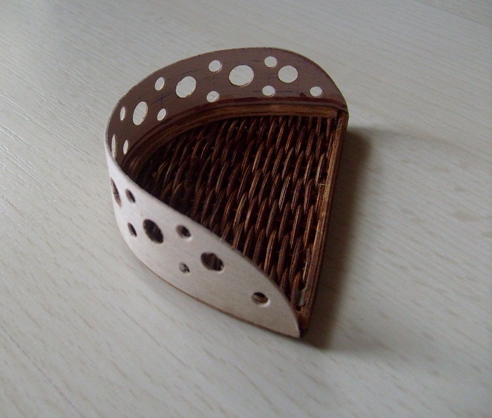

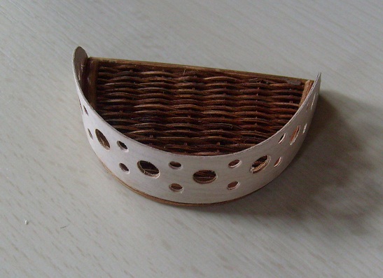

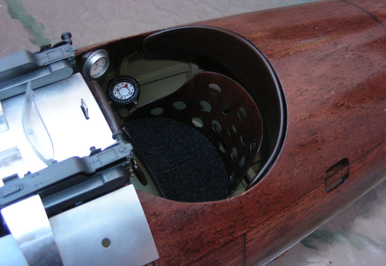

Hello,
how to build a pilot seat?
<span lang="DE">
I want to show you a few pictures of my pilot seat <span class="hps">and</span> <span class="hps">the production.</span>
<span class="hps">
The material</span> <span class="hps">is:
</span><span class="hps">-ratan</span><span>, 1mm</span> <span class="hps">in diameter
-plywood 0,8mm
-balsa "loom", size according to need
Greetings Gabriel

I like it, and have already copied the pictures for my future reference.
A question, that comes to my mind: Is the seat back really that low? I would have expected something tall enough to support more of the pilots back.

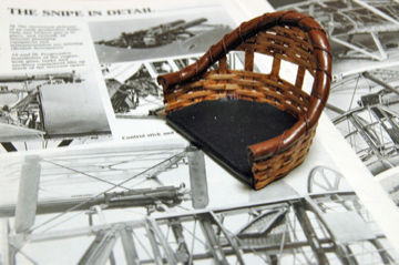

I like the idea of the balsa loom. Here's the seat I "made" for my Snipe but cutting up a small basket from the $1 (100 yen) store. With the pilot in place it isn't visible anyway.

ThanksLes,
yes,......the seat back is really so low, this is the seat of a French Demoiselle from 1909.
But don't worry, in the pioneer days there was many different seat models.
Usually, the materials were combined, .....there was versions with rattan / plywood as well as rattan / steel pipe.
The heights and widths were also different, even the German Fokker seats were in mixed construction.
I have built any full size seats for our ww1 machine, I could send you something by mail if you're interested.
greetings Gabriel

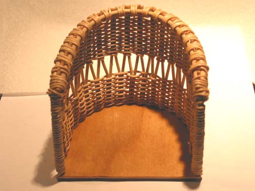

My seat for my 1/4 Camel. Not really difficult to make.
