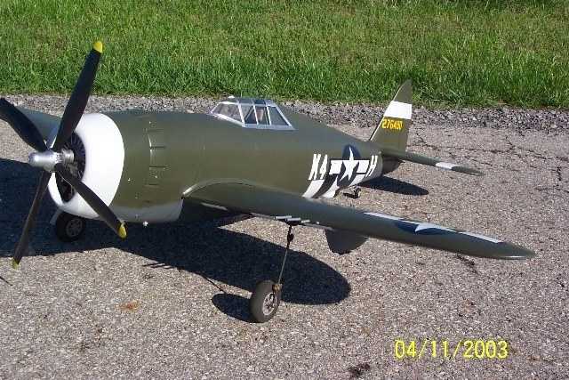

Mine flys around great with a Surpass .91. It's a bit heavier than usual because I fiberglassed it, but that wing doesn't seem to mind a bit.

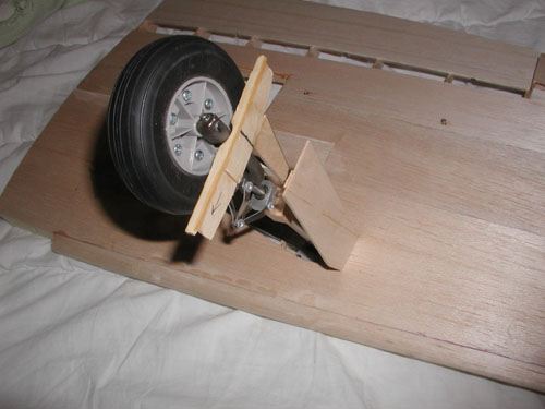

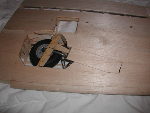

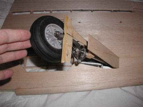

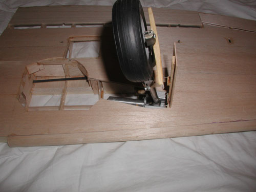

My attempt at retract in scale location.

[img]Nice job! I will give this to Jethro! Thank you!

This information helps a lot. I have the spring air kit but just need to get a web address where I can order the Robart oleos. I have just finished installing the tail wheel gear and am putting in the control rods for the elevators and rudder.
I was really impressed with Parabellum's job of fitting the retract doors to the oleos. I didn't know that could be done.
