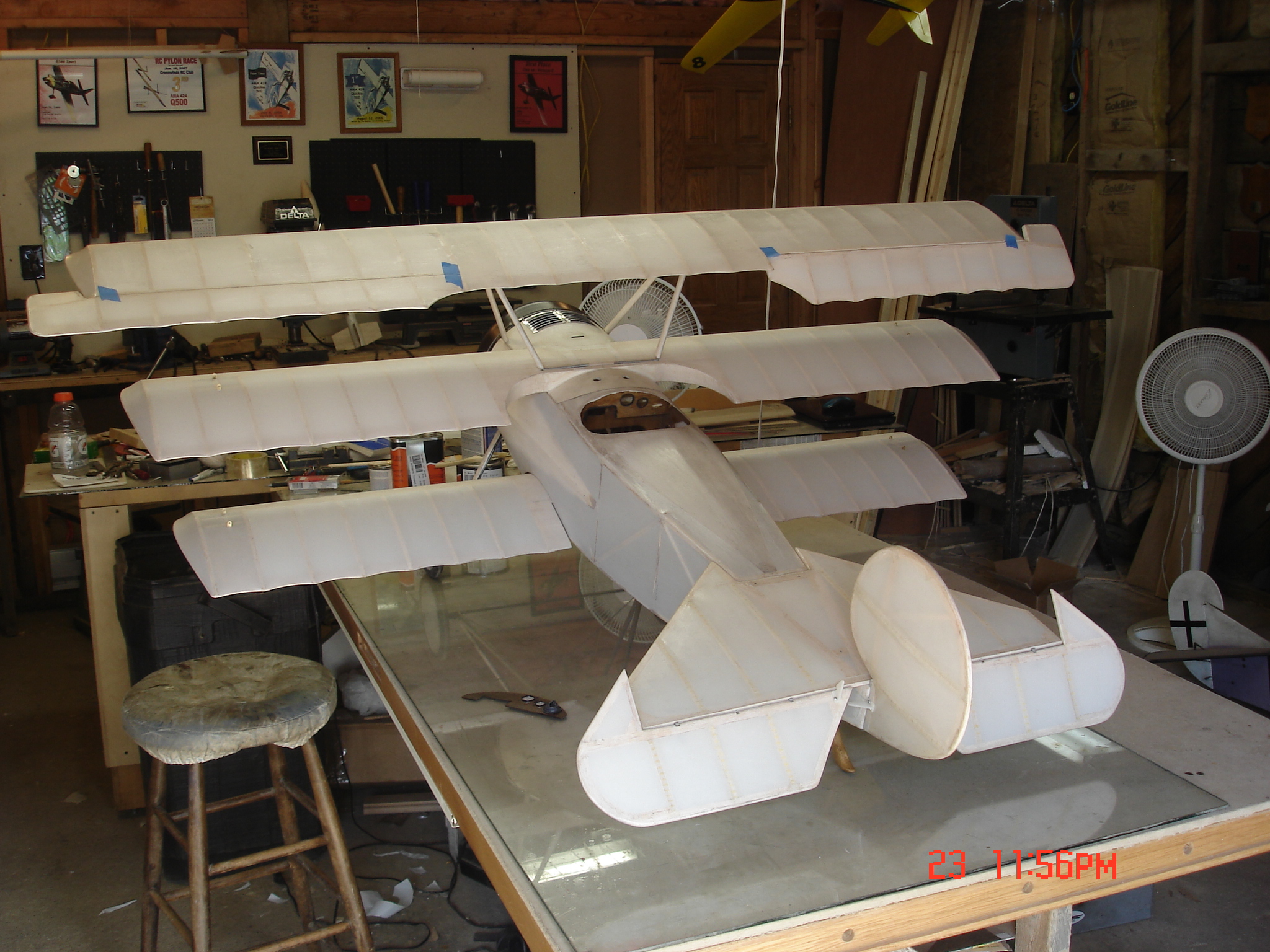

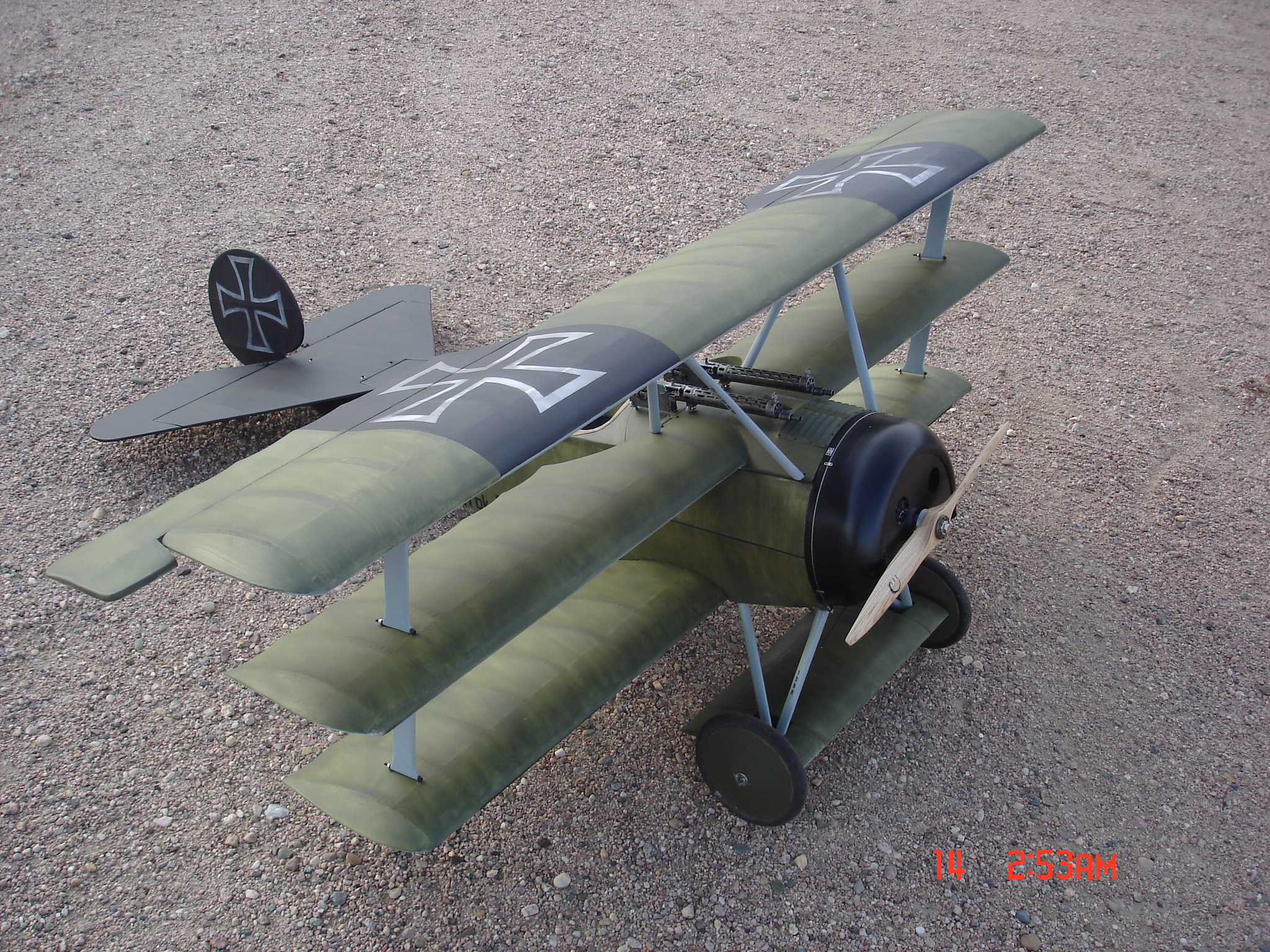

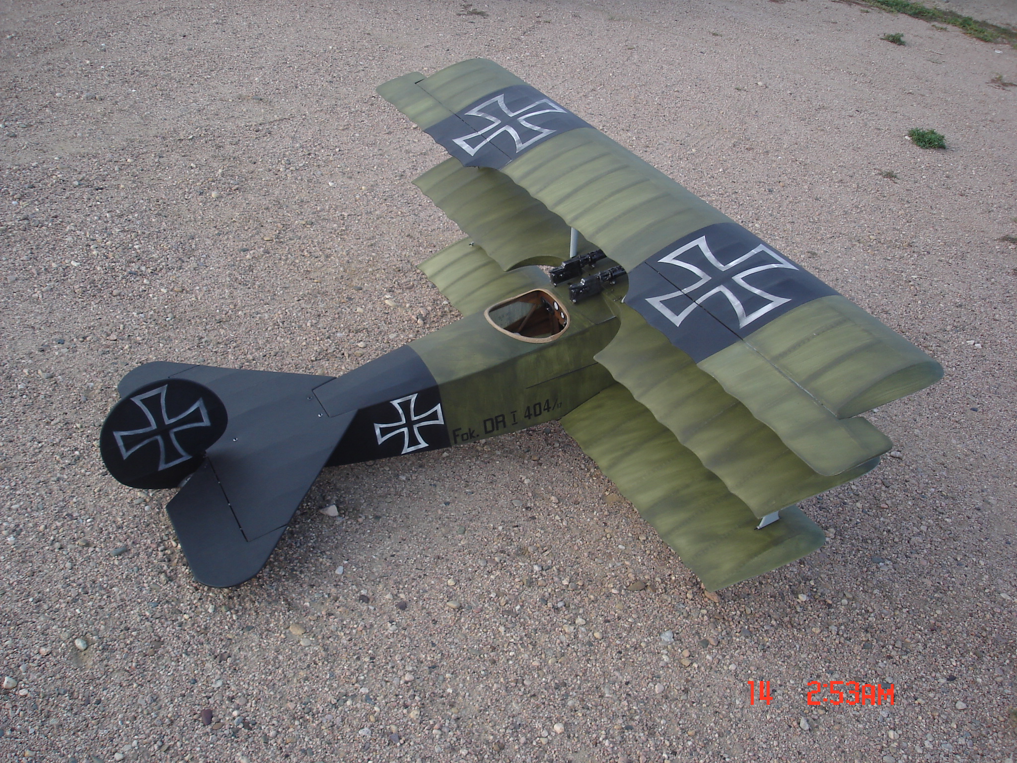

Dope is not hard to find. Look at Aircraft spruce, or Brodak. And Dope is a type of lacquer. I just painted an entire 1/4 scale DR1 with the stuff. It is the best thing going as a finish goes.

Originally Posted by abufletcher
VG, what did you use for the color coats over the dope?
I used latex house paint. The layered effect was done with the airbrush. I prefer to use the Butyrate as I like the shrink. It keeps things tight!

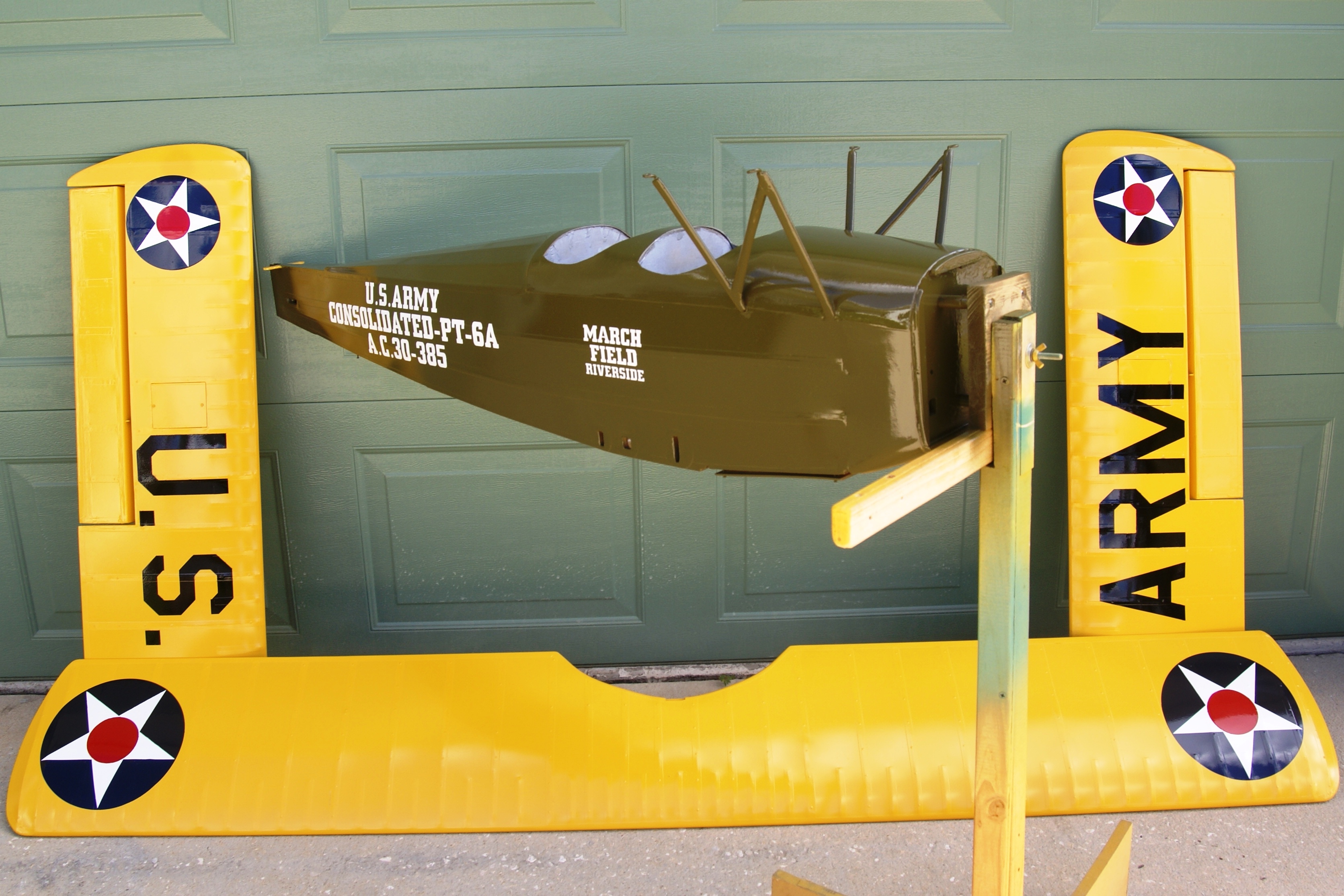

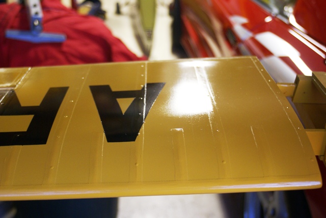

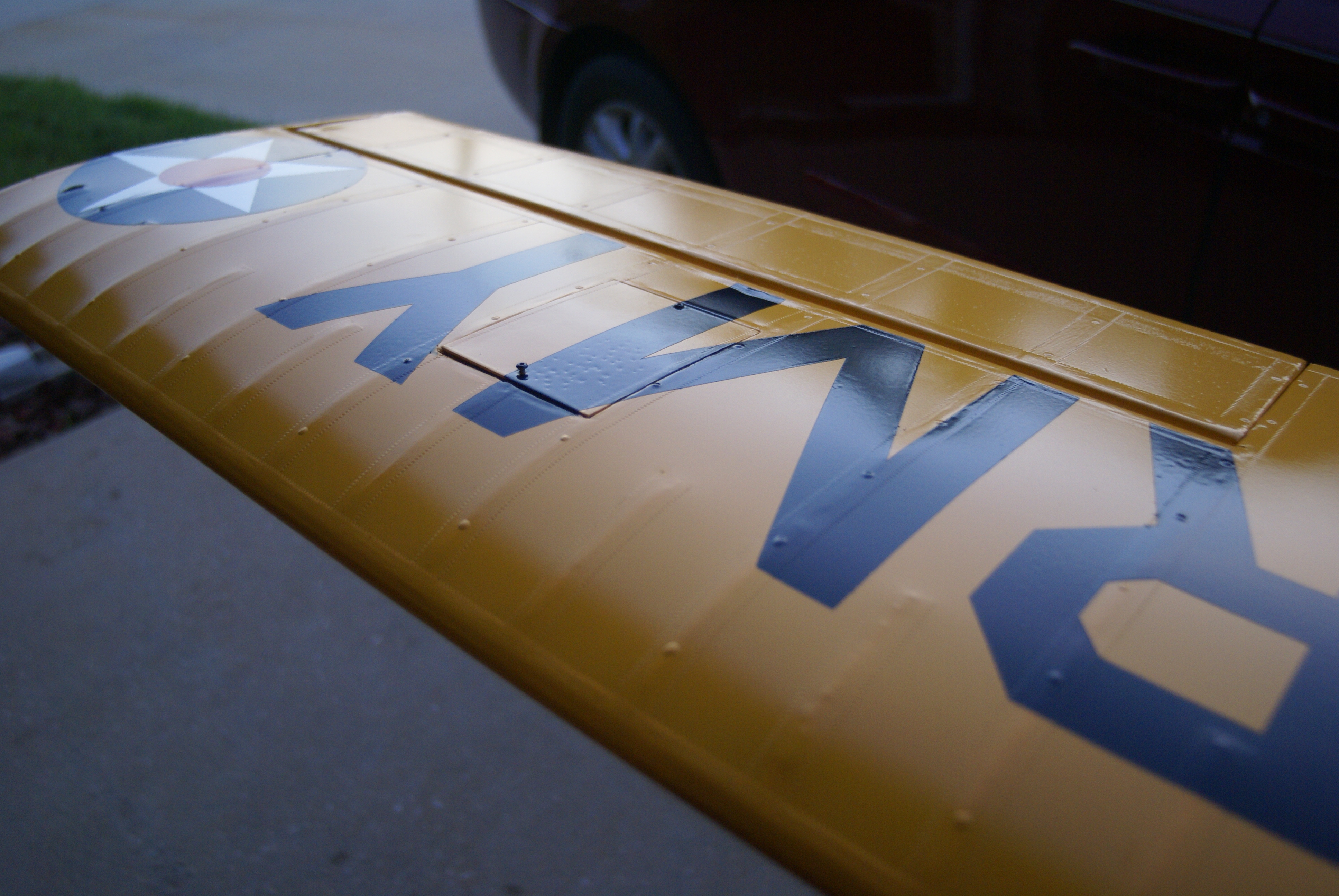

I use Klasskote exclusively. I have to deal with humidity and lacquer (if you can even buy it anymore) blushes, as does dope. When I painted cars, I used a retarder and slow flash-off thinner in high humidity. Sometimes just thinner and retarder lightly on top of the color coats.
I've also never heard of catalyzed lacquer. It's a single part paint.
Here are pictures of my Fleet after painting. No primer used, just top coat color.

Bob, I read a bit about the pre-cat lacquer and apparently the catalyzer is added just before sale. So in essence, it is a two part paint, although the customer doesn't add anything. That is the reason for the short shelf life after it is purchased..
DuPont Lucite was a nitrocellulose lacquer and it had an infinite shelf life as far as I was concerned. I never experienced crazing, although the re-finish on my GTO (I didn't apply it) did experience some minor crazing before it was stolen.
