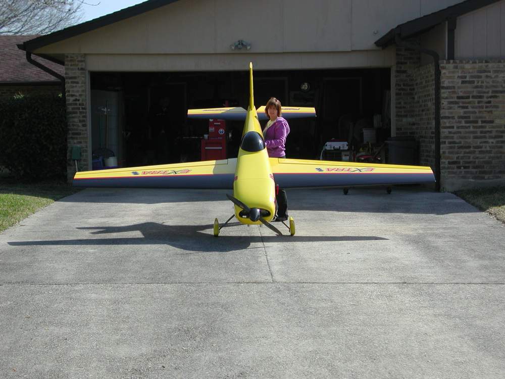

I acquired this method of balancing your giant scale plane from none other than our very own Wayne Geffon. It's probably one of the simplest methods for balancing a giant scale bird I've ever seen, thanks Wayne!!!!!
This method is how I go about checking CG on a plane that weighs too much to put on a CG machine or lift.
Have the plane all assembled RTF minus fuel. Find a place where you can put the nose of the plane up against a wall. Take a level and prop up the tail wheel till the fuse is sitting level. Your gonna have to take the hatch off in most cases to set the level on.
Once the plane is sitting level, mark on the ground the two points where the main wheels are with masking tape and draw a line right where the wheels contact the tape. Then make a mark where the center of the tail wheel sits in the same manner. Its gonna be on whatever you propped the tail up with. (I use magazines)
Its also a good time to measure from the wall, how far back the recommended CG is. Save that number for later.
What you are looking for at this point is the distance to each wheel from the tip of the spinner. (which should be touching the wall at this point)
I use a long straightedge to get the distances
Lets say you come up with theses numbers:
LH main - 22 inches
RH main - 22 inches
Tail wheel - 70 inches
Now get a scale and place it under each wheel individually. You will have to re-adjust the other wheels to keep the plane sitting level. Add more magazines.
(If you have three scales you can get the weights at the same time but make sure the plane is level)
Remember to put the hatch on after you level the plane before you weigh each wheel. You gonna wind up with three weights. One for each wheel.
Lets say you come up with these numbers
LH main - 9lbs
RH main - 9lbs
tail wheel - 5lbs
Now its just a simple math problem to find where the CG sits right now on the plane.
Weight x ARM (distance) = Moment
22x9=198
22x9=198
70x5=350
Now add the total of all the moments and the total of all the weights.
Weights 9+9+5 = 23lbs
moments 198+198+350 = 746
Then divide the total moments by the total weights.
746 divided by 23 = 32.43
That number 32.43 is "in inches" how far back from the tip of the spinner to where the plane balances right now.
Compare that to the distance that you measured earlier to the recommended CG location.
If you are off one way or another adjust items then recalculate the weights. The distances (or ARM's) aren't going to change so you already have those numbers.
It may sound confusing and a lot of work but it really only takes about ten minutes to do it.
This is generally how full scale planes are balanced. You cant go lift one of them by your fingers or stick it on a CG machine.
Try it......
