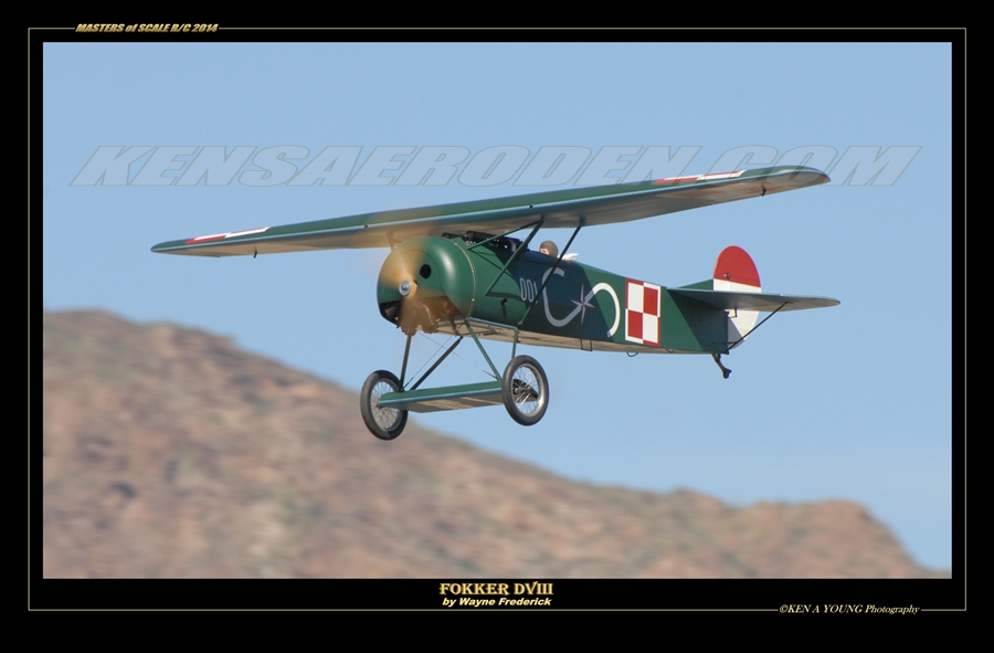

I know of one example of a Fokker DVIII where the builder uses all B&W photos but then also includes one artist color-plate to prove colors. This builder competes & wins in
TEAM Scale quite often. Documenting a WWI or any pre 1935 plane is very challenging but it can be done effectively. See sample picture of Wayne Frederick's Fokker.
Wayne consistantly earns a 98 or higher staic scores.

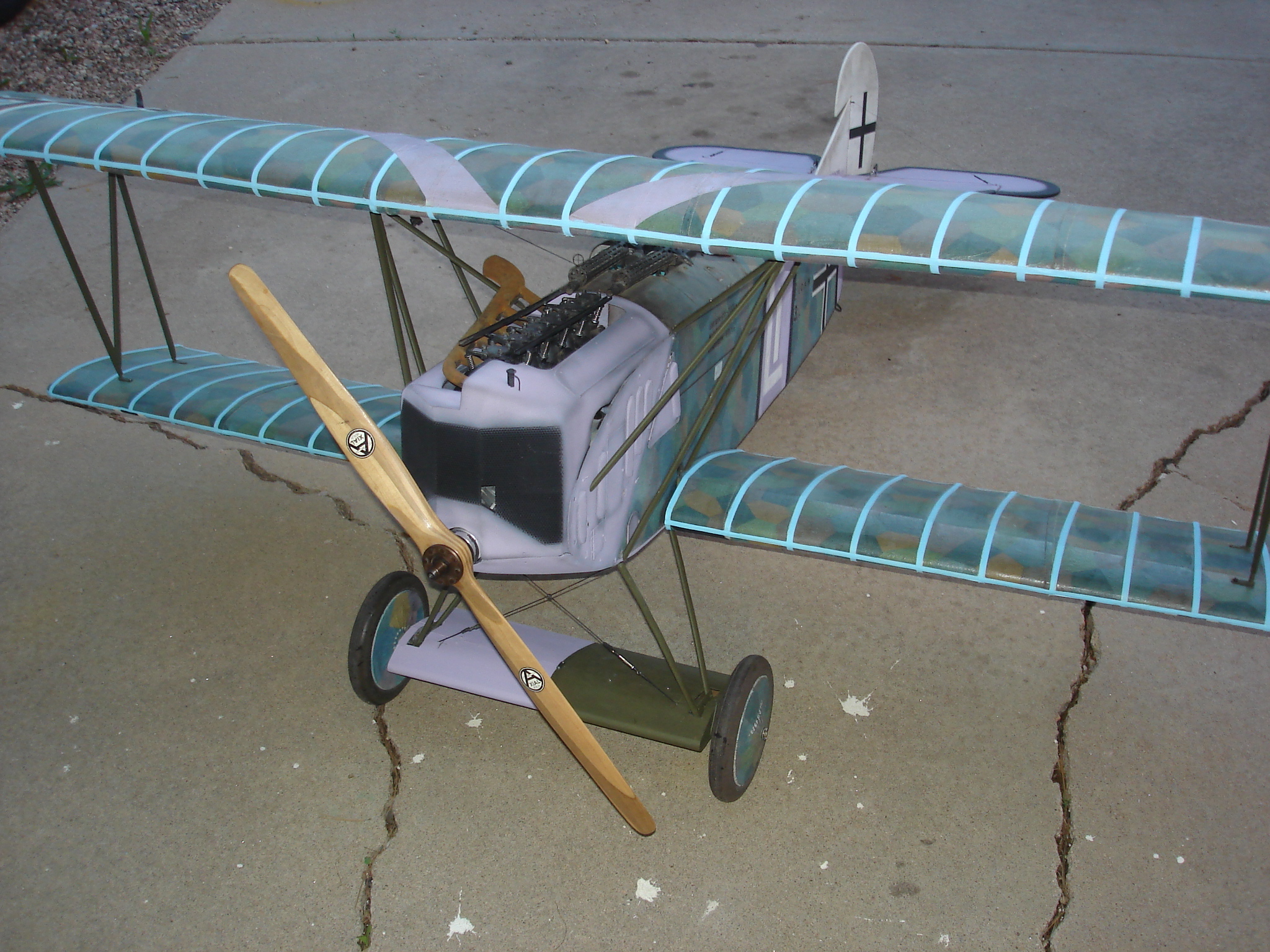

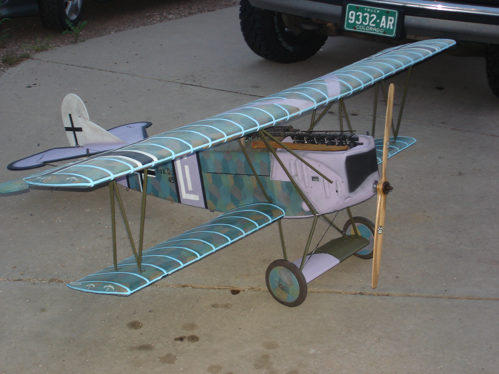

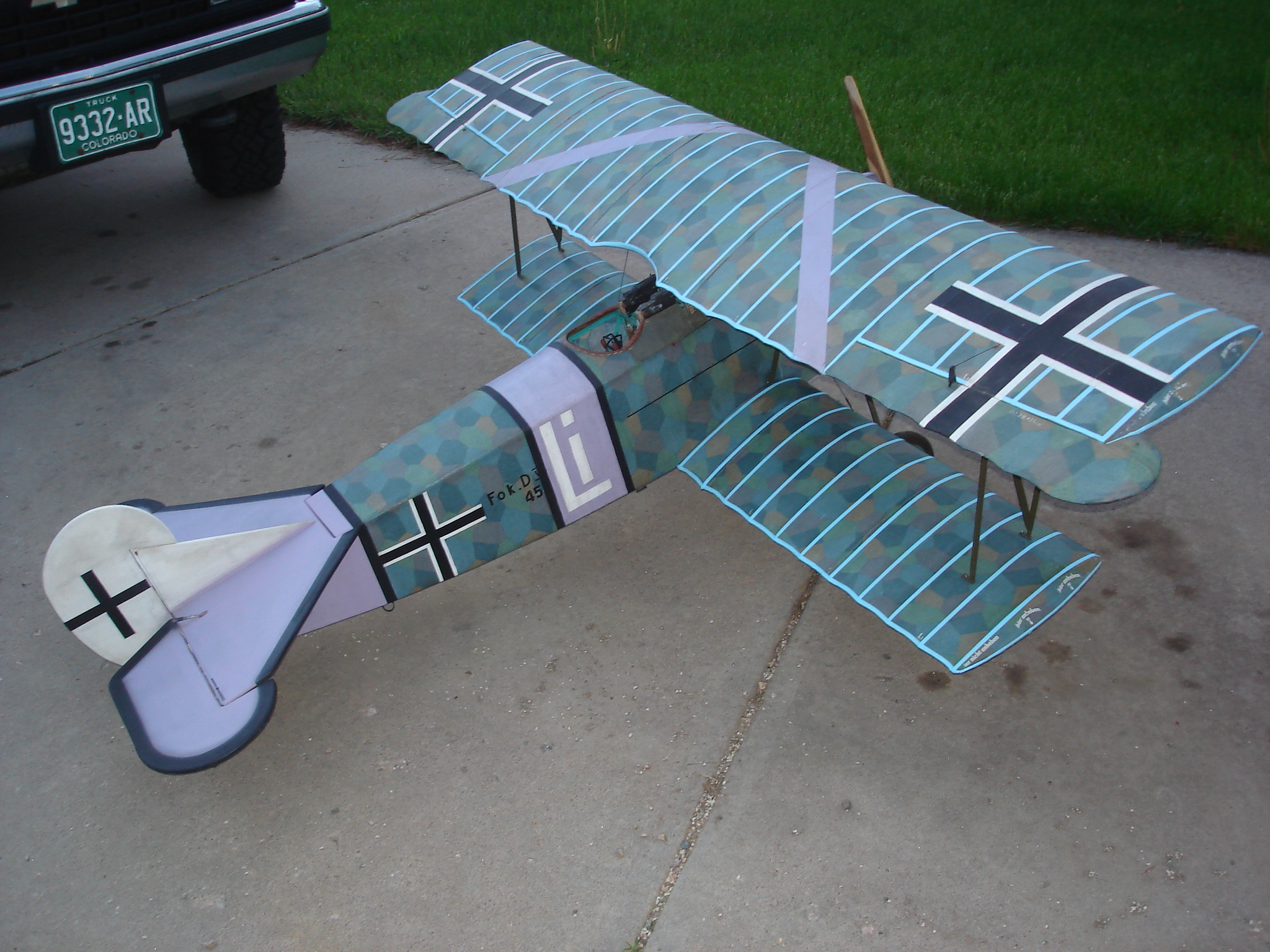

Fortunately, acquiring docs for my particular model are not difficult, as it is one of the most documented Fokker DVII's there was. I am more asking about specically how the judges like to see them organized and laid out. Having them is one thing, presenting them properly is another. That is really the heart of my question.
[. I am more asking about specically how the judges like to see them organized and laid out. Having them is one thing, presenting them properly is another. That is really the heart of my question.[/QUOTE]

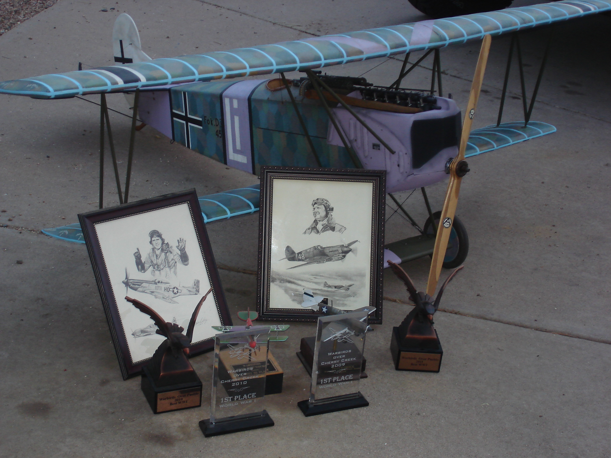

I sort of decided to use my Fokker DVII for competition as an afterthought. That is, I went back to clean up my details, markings and colors after I was done with the model. It just so happened that I had acquired a lot of docs on the plane prior to the build, but I did not follow them as closely as needed to be competitive, as I really had not planned on it. Even right now, I am making some adjustments to my model to improve my scores.
I currently have 2 other models under construction that are competition models, primarily a 1/5th scale TA 152. It has been recommended to me as well to find your model, and stick with it. And the TA 152 is the one. I just need to get it completed. Meanwhile I want to continue to compete, so I will campaign the Fokker until I get it done.
For the Fokker, I am primarily using the Windsock data file Anthology 2, as it is really the best, most complete book on my subject.
