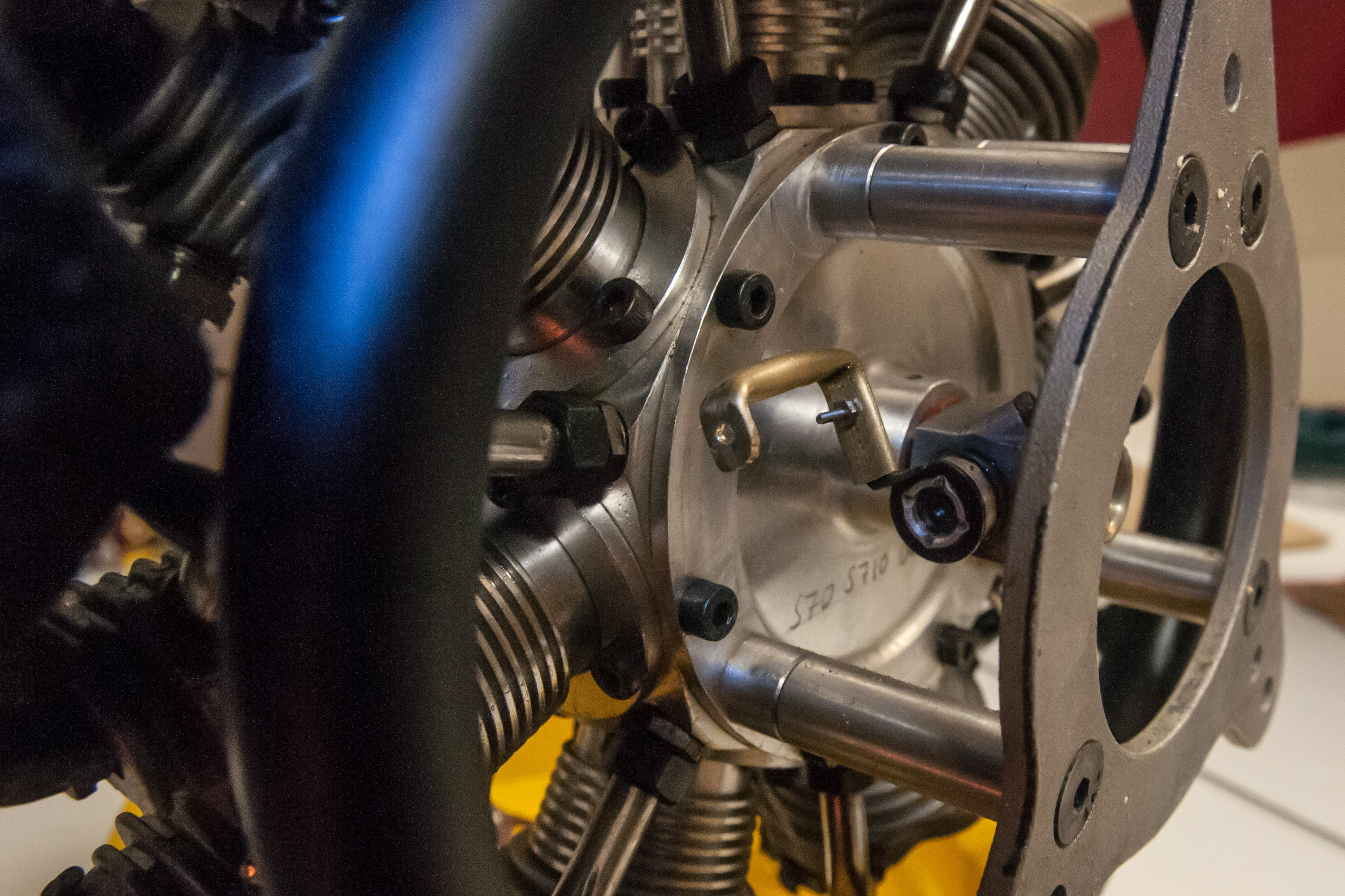

The Seidel 770 starts easiest if it's been liberally primed before flipping the prop. On the test stand I've been injecting the fuel directly into the open carb with plastic pipette. The question is how to accomplish this once the carb is buried in a cowl (and right up against the firewall).
I made a tight 90 degree bend in a 4mm brass tube, cut one end off short and slipped on bit of fuel tubing for protection. The end of the tube would sit in the "throat" of the carb and the other end would run up through a slit in the cowl. At least that's my thinking at the moment. But I'm wondering if the fuel line from the tank might actually be in the way. I'm not sure about that; I'll have to check.
Is there any other way to mechanically "suck" fuel into the carb? For example, if I block off the exhaust tube and rotate the prop (a few times) would that do it?

The carb faces rearwards and there is probably less than 3/4" clearance from the firewall. The way the ARF is setup there is an 800ml fuel tank the end of which protrudes through a 1" diameter hole. So the plumbing tubes are going to be very close (and maybe a bit above) the carb opening.
And, yes, it's have a vent line to the exhaust. I've never had a model without a vent line and don't really understand how that would work.
The idea of an additional line on the fuel line sounds worth pursuing. My usual method is very primitive. I've always just have three lines: 1) fuel to carb 2) tube to exhaust and 3) a third "fill" tube that dangles more or less free.

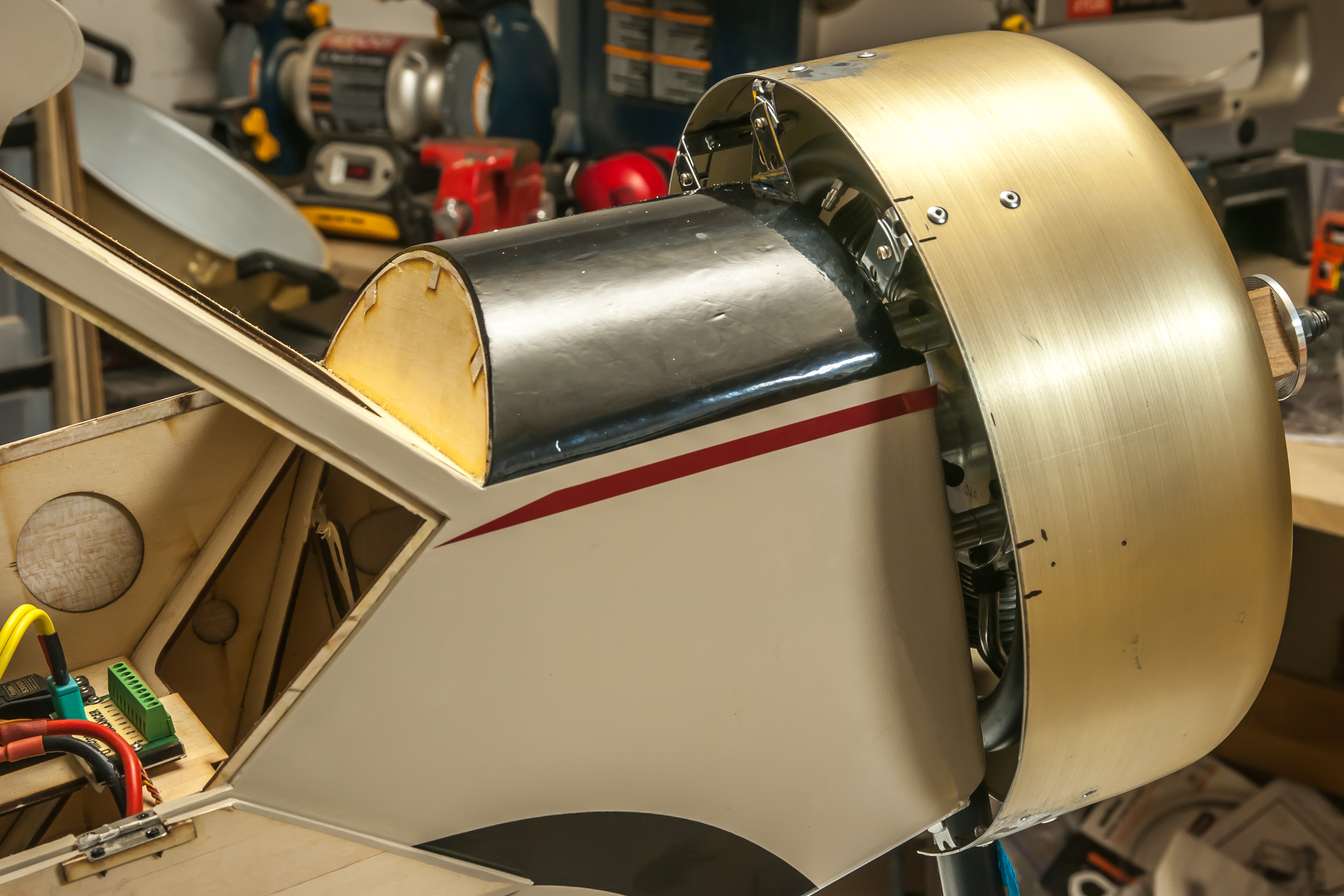

The problem with THAT (and there always seems to be a catch to each suggestion) is that the ARF design has the 800ml tank seating precisely behind the firewall with it's stopper sticking through a fitted hole. Of course, I could move it back but then I'd just be creating a new problem of how to route plumbing. What I'm leaning towards at this point is a combination of the ideas suggested here: A 2mm brass tube mounted to the front of the firewall that I would inject fuel into with a syringe.
While I ponder this, I've been making a new set of longer connecting wires for the glow system since current ones are too short to reach the Microsens controller. One by one the problems present themselves and one by one they get solved. Such is RC modeling.

It's been a busy week at work, but I finally got the fuel priming tube made and intalled. I rummaged around in my box of 100yen ($1) goodies and found a syringe. The needle fits perfectly into a 2mm brass tube. After putting a few bends in that I silver soldered it to a short length of steel strap (the same stuff I used for the cowl brackets).
So now I just open up the throttle, squirt in a measured amount of fuel, and voila!

Hmm...today I was mounting the engine, hoping it would be the last time, with the throttle linkage, tank and all tubing in place, when I realized there is still one more problem to solve: Access to the needle valve. I had been thinking this would be a matter of an easy-peasy extension (and a slot in the cowl) but just now noticed that the the needle valve is directly in line with the ring exhaust. In other words, the ring blocks a direct line to the needle valve.
This is going to take some thinking. Is there such a think as a "remote needle valve?"
I wonder if I could use flexible wire cable as the extension.
