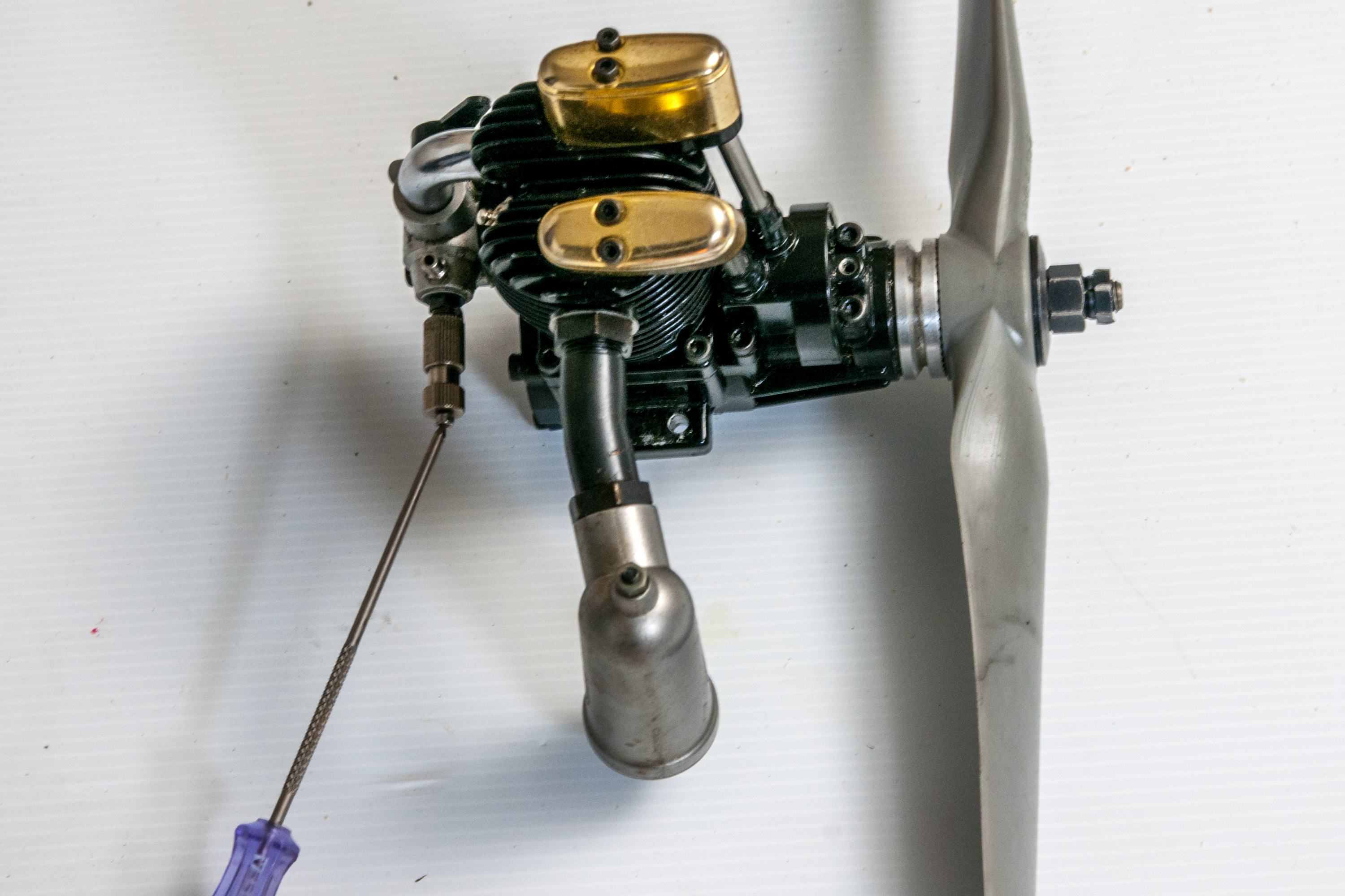

Below are photos of three possible solutions: 1) A thin hex-head driver that can work at an angle, 2) the silicon tubing over the needle valve method, and 3) a wire cable to the needle valve (with a little turning knob made from a fishing weight). All three are workable. Idea #1 might require that I mount a tube to direct the driver to the right place. Idea #2 works only if there is a brass tube handling most of the torque. The shorter the piece of flexible silicon tubing the better. Idea #3 seems like a good, simple solution, but even with this length of cable it takes a lot of twisting to make the needle move so precise adjustment might be fiddly. Perhaps what's needed is something like a combination of #2 and #3, namely, a short length of cable, which would allow it to be turned at an angle, and then the cable crimped into a length of 2-3mm brass (or aluminum) tubing to reduce the twisting of the cable by itself.

Yep, the cable, crimped in a 3mm brass tube, makes for more positive control. There's only about 1/4 inch of cable showing.

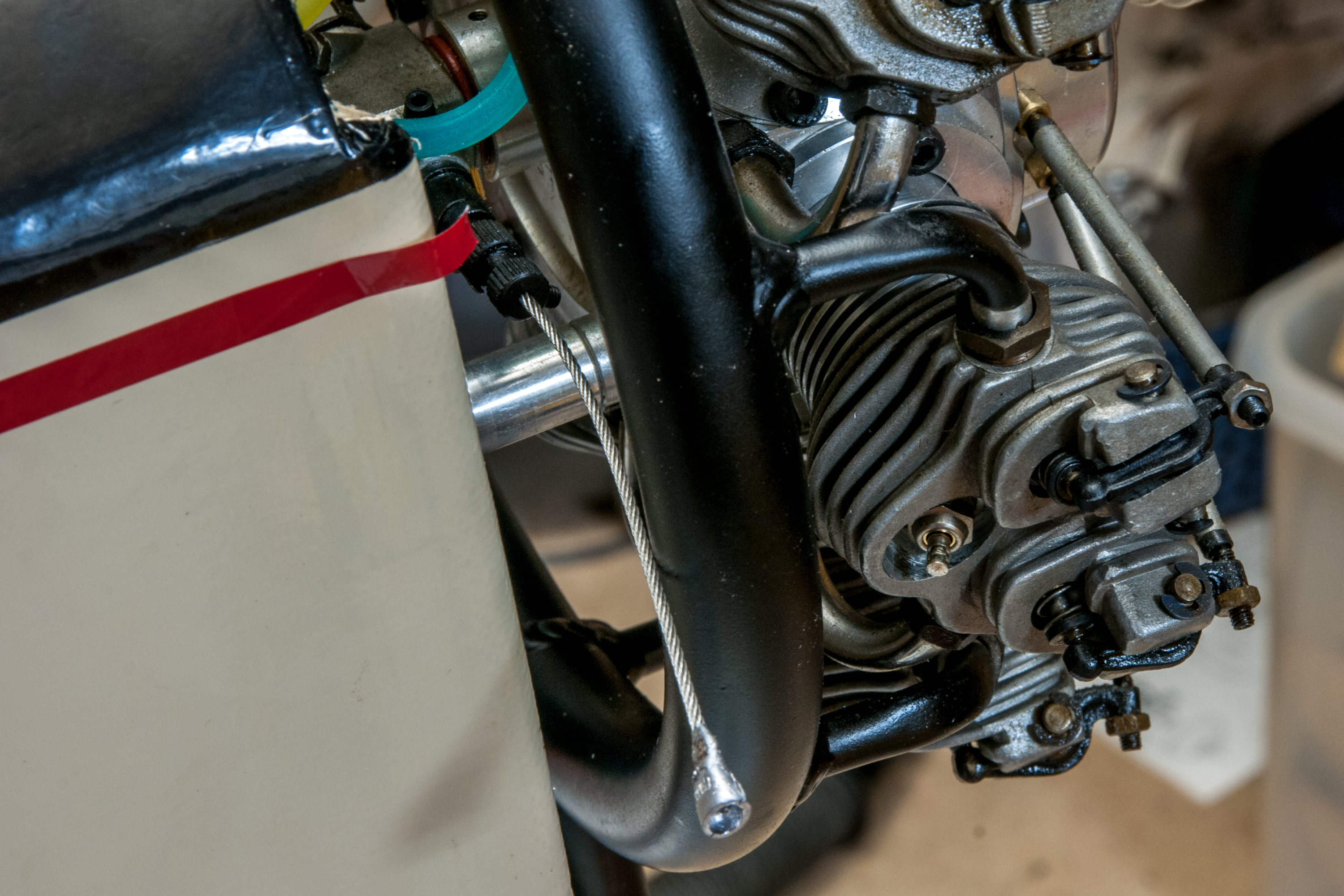

Here's the needle valve with its finished, flexible extension. i also add a bracket to support it so it's not bouncing around while the engine is running. At this point the engine is all buttoned up with plumbing done, glow system attached, fuel injection tube in place, and re-painted aluminum cowl bolted in place.
Now, I can start finalizing the radio installation.
