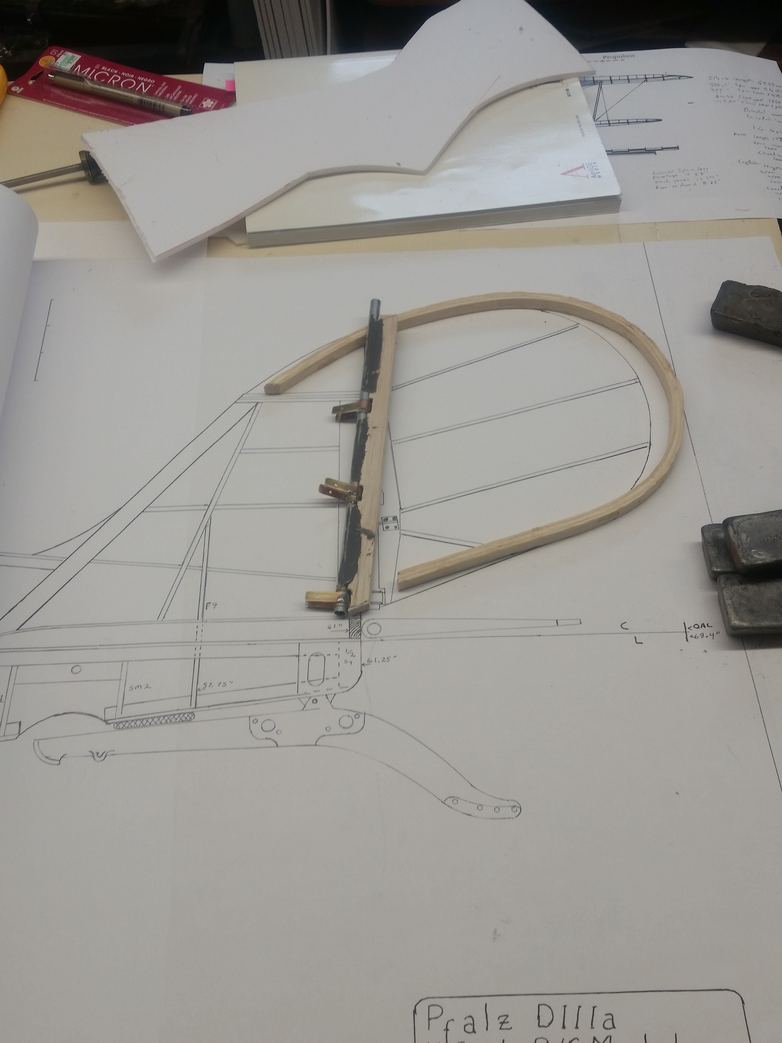

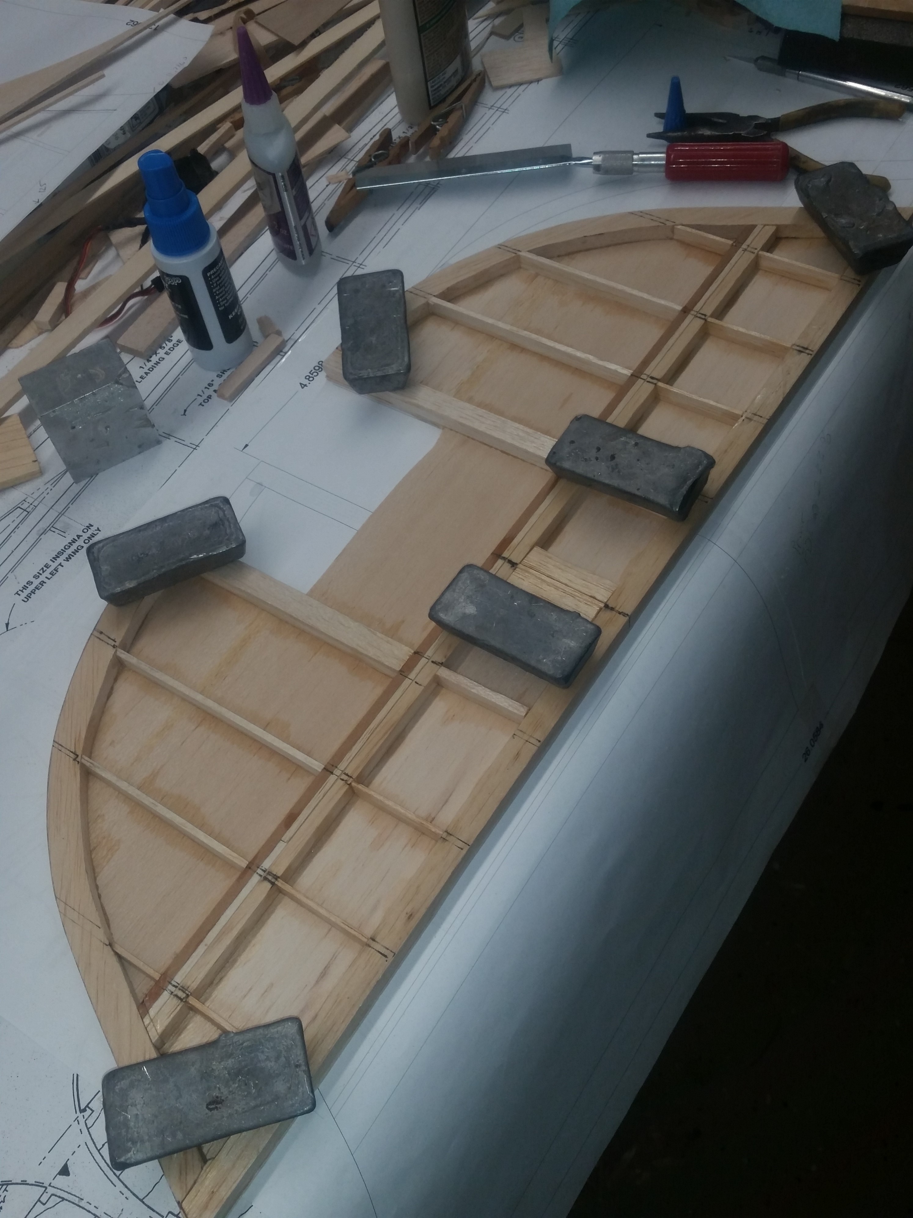

After some years of collecting documentation, asking questions and doodling plans I've decided that it is time to pony up and build a Pfalz DIIIa. One of my objectives in this is to build a scale model to my own plans. There are people who follow the "building for God" school of modeling technique and who produce beautiful museum scale models. This probably won't be one of those. I'm shooting for more of a Pfalz shaped object. My design goal is to produce something along the lines of a BUSA product. That is to say, recognizably scale but with some compromises to ease construction and setup at the field. The thread started by Abufletcher and the pictures of Seth Hunter's efforts have been an encouragement. If one felt the need to duplicate the wickelrumpf construction it would be possible on my design by applying a veneer of 1/64th ply strips to the fuselage but at least at this point, I'm not feeling the desire to do so. The reason is that in most photos of the aircraft the veneer strips do not show. Although I am shooting for a scale outline and will be adding some scale detail this will primarily be a sport flier and not a competition airplane. If it turns out well enough to take to a local fun fly or a local dawn patrol I will be happy. As for the scale outline, one of the main resources, the Wylam drawings have been criticized for their inaccuracies. All the same they are still among the most detailed drawings out there. I have tried to use other sources where possible. The Herris book, "Pfalz Aircraft of WWI" is a great item to have as is the Windsock datafile by P.M. Grosz. The forums on the Aerodrome website have also been helpful. In particular there is an individual who is engaged in producing a set of 3d drawings of the full scale aircraft. Using these sources I have tried to correct the outline as much as possible. I wish I could remember which thread I saw this bit of sage advice in; "Sometimes there just isn't good documentation. You just have to suck it up and build the best you can".
To get my toe wet I started with building the rudder. It has a laminated outline with an aluminium tube and I soldered up a set of brass hinges.

One of the skills I am building is learning to use a CAD program. I used A9cad to generate the former outlines but ended up adding some of the notches and lofting the stringer lines by hand when the selection/cut and paste functions were being cranky. At any rate I've gotten started with the bottom half of the fuselage.

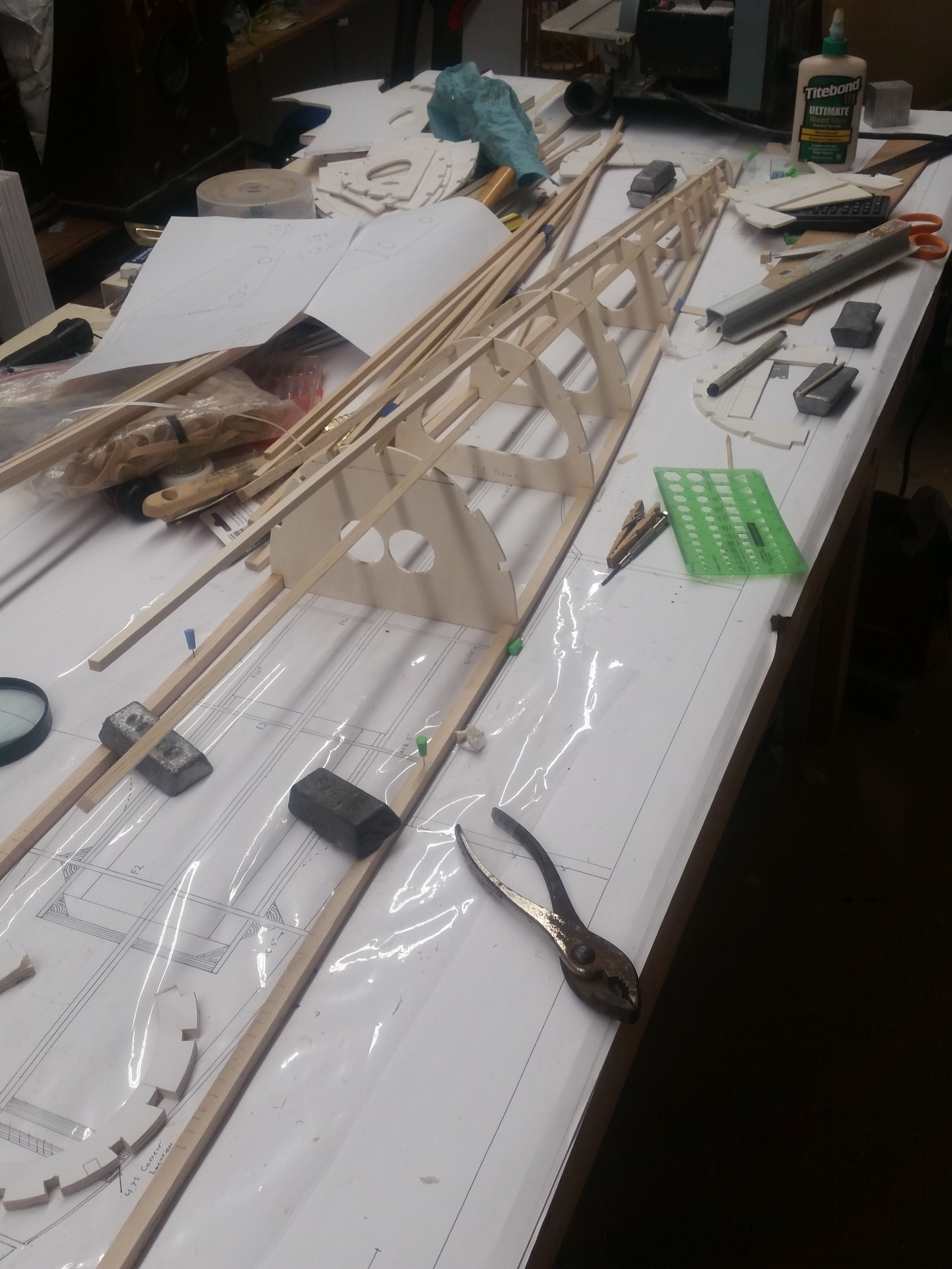

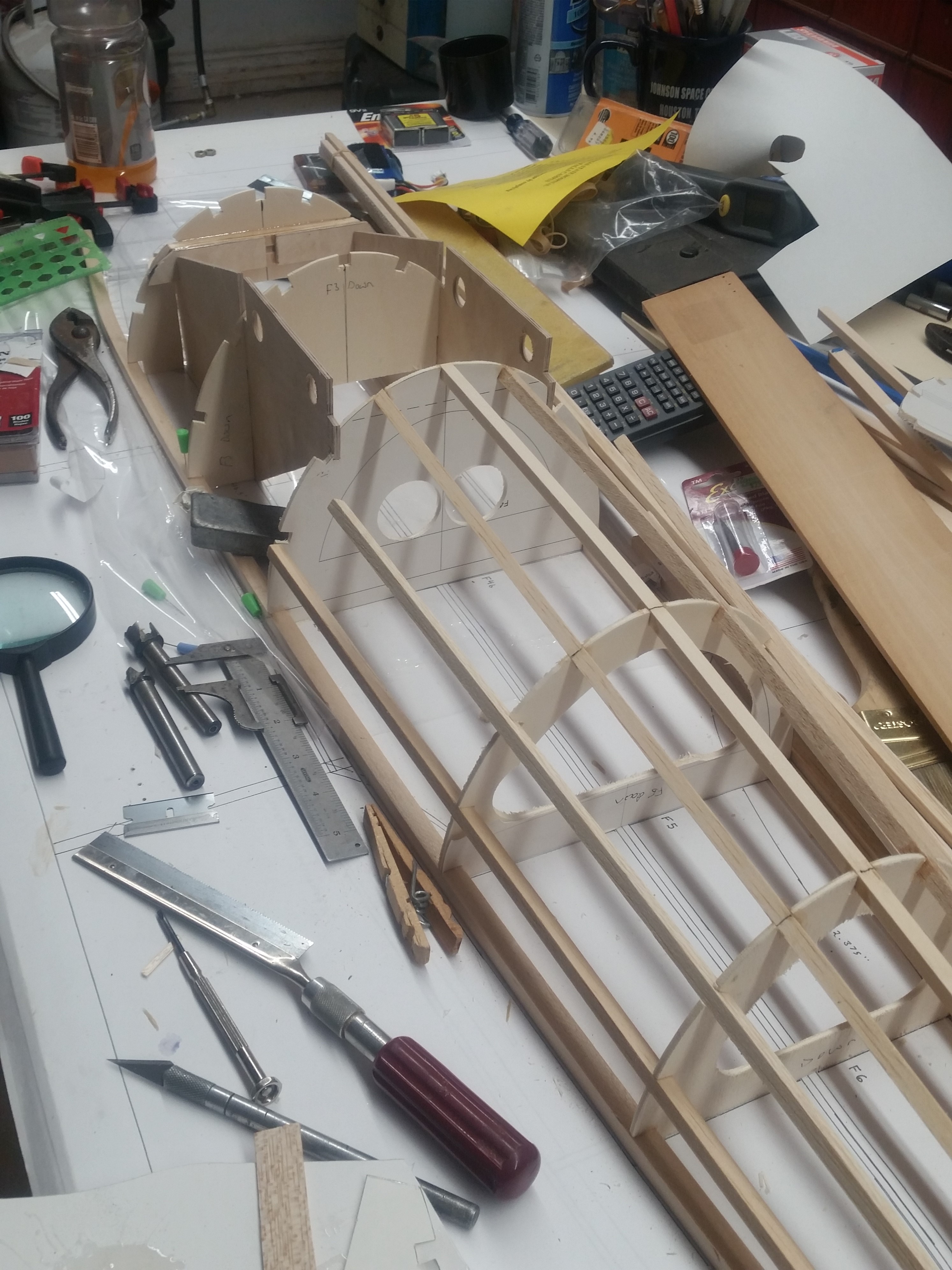

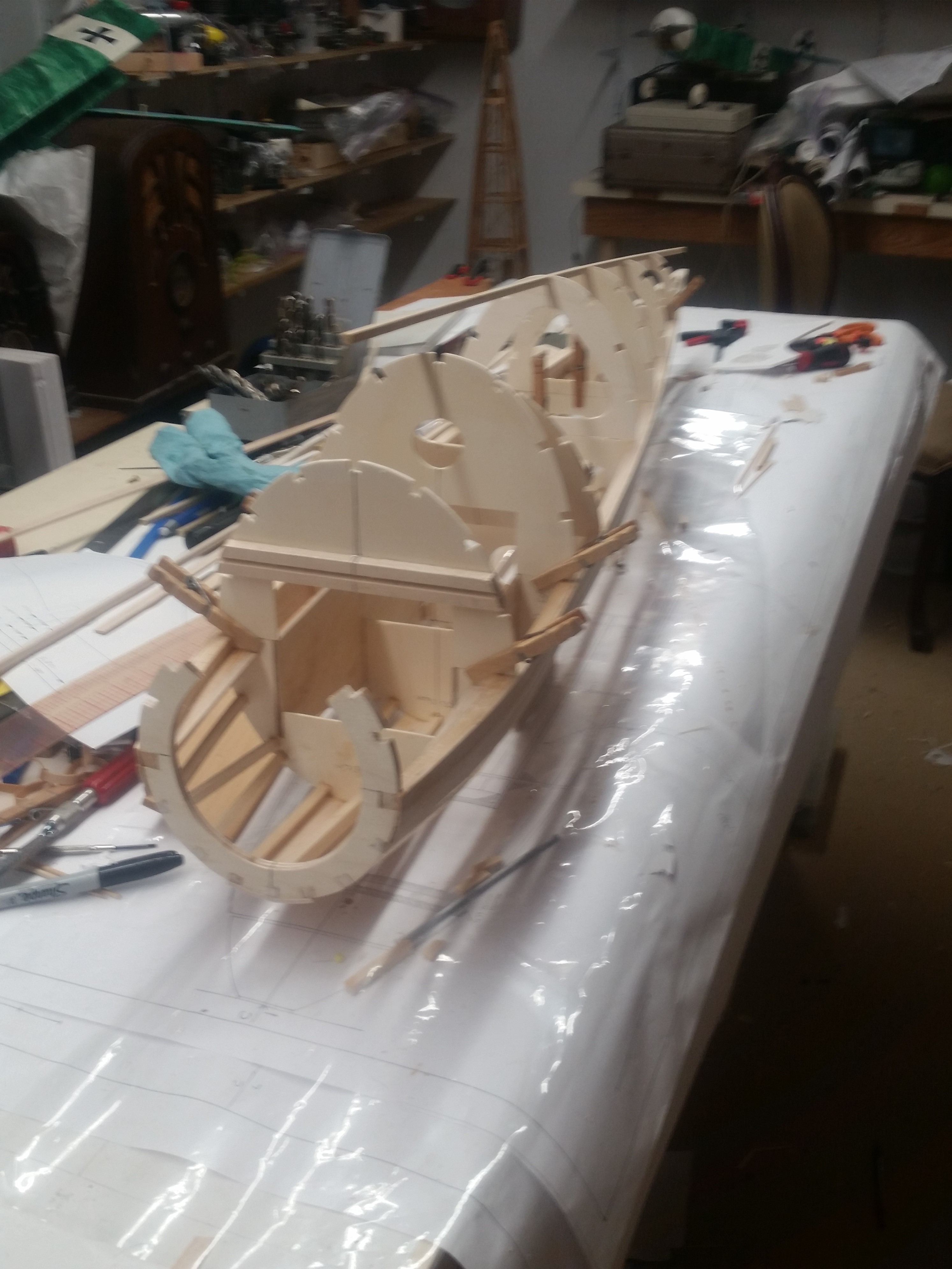

Moving a little farther along I have installed some of the formers and stringers. In the second picture you can see the ply box that will tie the engine box to the lower wing mount and the landing gear. The third photo shows where the upper anchor will be for the tail skid bungees will go.

I've been throwing down some stringers. I don't have photos yet but I've started planking the bottom and will at least partially plank it before I do anything else with the fuselage to give it a little stiffness.

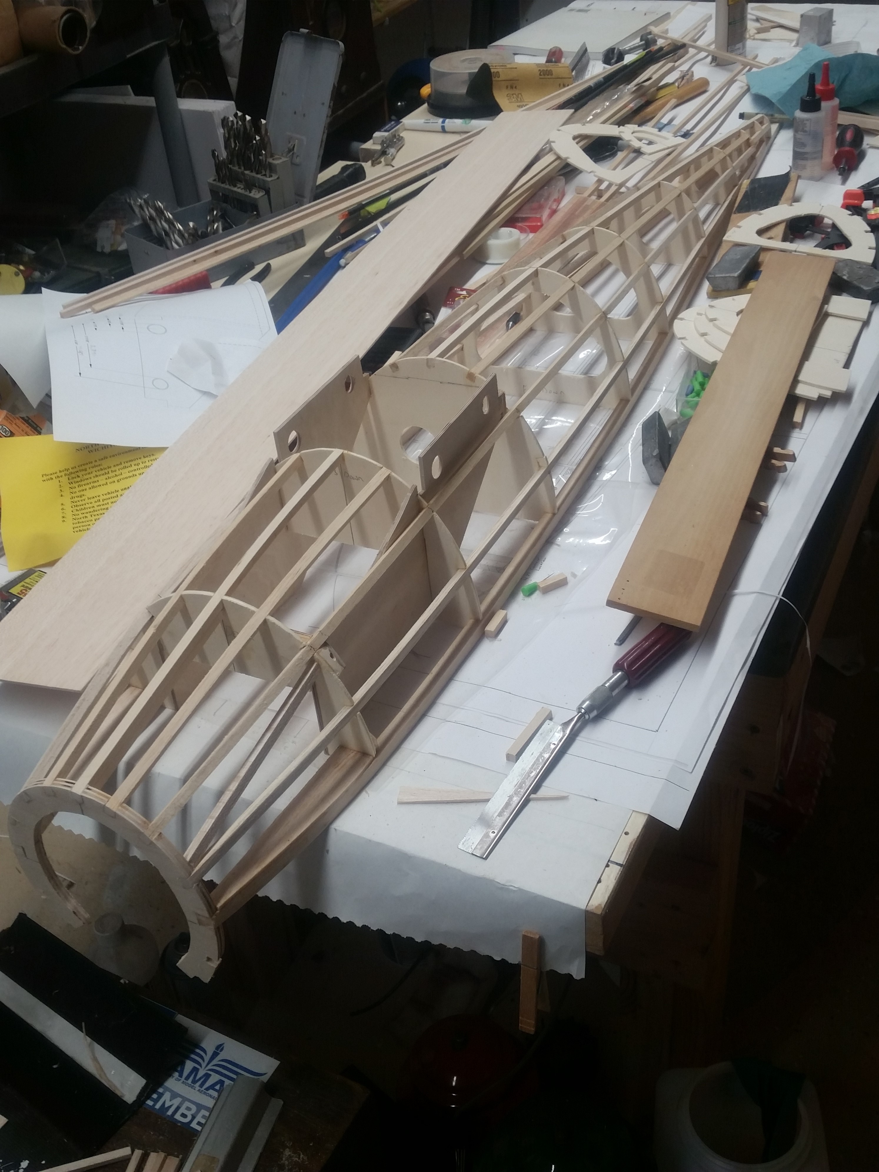

Stringers and planking. Planking a fuselage is probably not the most exiting thing to watch but it is rather relaxing to do. It's not the prettiest planking job you will ever see and there is a lot of sanding and filling in my future. It will eventually be covered and painted so as long as it is strong, smooth and not too heavy it will all be good. Lots of steps ahead for the bottom half of the shell including the lower wing roots, the landing gear mounts, the engine box and other internals. It may not show well on the photos but the internal box structure that ties everything together interlocks with the fuselage formers and now has the right angle joints reinforced with triangle stock. The two slits that can be seen at the tail mark the location where the bungie for tail skid will exit the fuselage.

I've added the wing root stubs to the lower fuselage.These are spar carrythroughs that will mount the root ribs. The aft stub will also tie to the rear landing gear mounts. There are gussets to be added yet but these structures serve to tie the lower wing to the engine box structure.This box structure ties together the engine box with the formers that carry the upper cabane mounts and the front landing gear mounts.

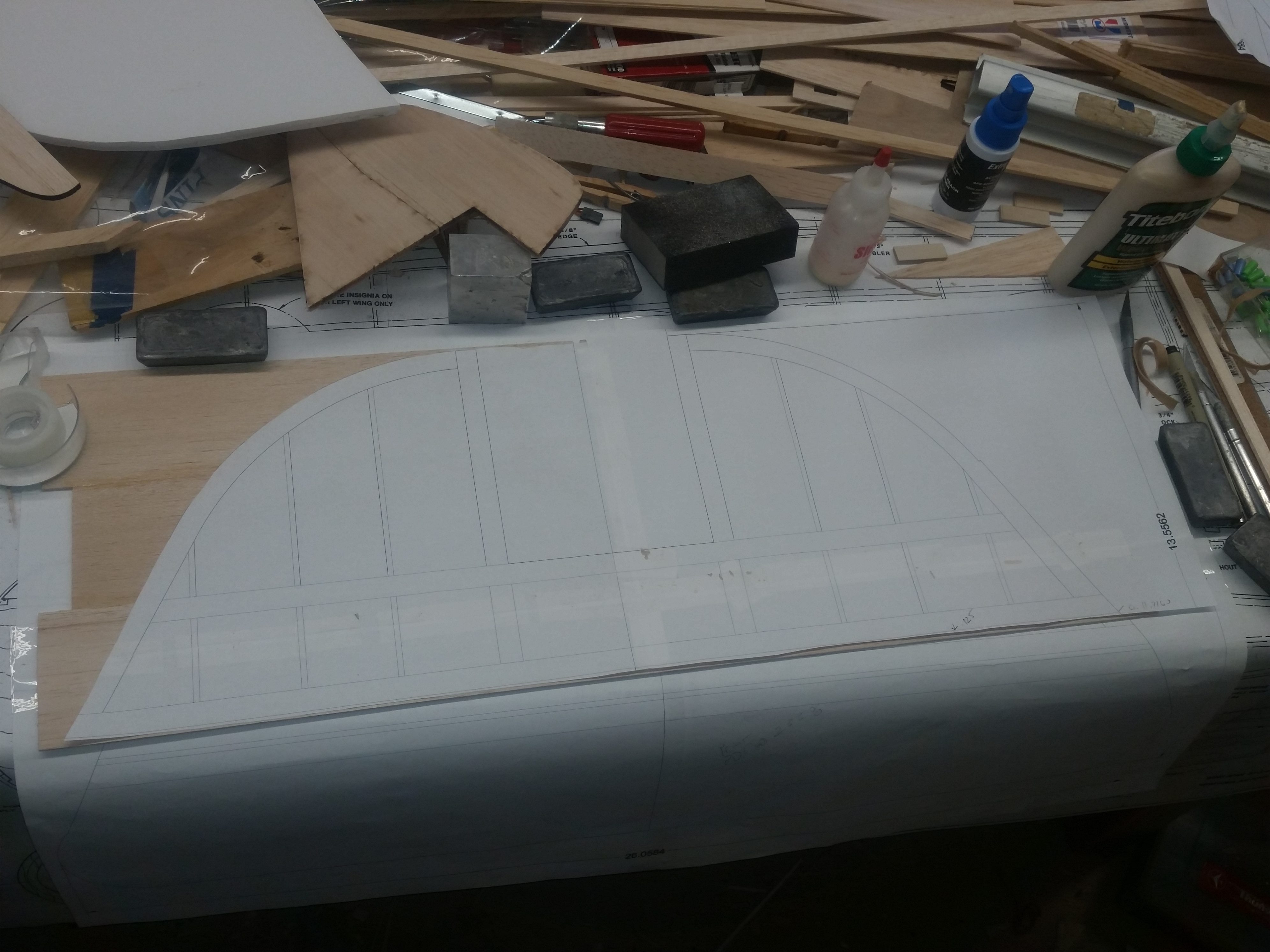

I am shifting over to tail surfaces for a bit.The reason being that the Pfalz pretty much has to have pull-pull on the control surfaces to look right. I suppose one could do push rods but a 4-40 rod to the rudder would look pretty clunky. By setting up the tail surface I can settle on the paths for the cables. I will also be cutting away at least part of the formers in the aft fuselage to make room and save a little weight. The fuselage is a fairly deep oval especially through the cockpit area and I am going to set up a walking beam for the elevator cables under the seat. I tried laminating a curved leading edge for the stabilizer but it didn't work out. I think the problem was a combination of using too thick wood and not soaking it in water/ammonia long enough. At any rate I didn't produce parts that matched each other or the drawing. I could probably take another shot with a more rigid form and thinner laminations but I will probably just go with horizontal laminations rather than vertical. I also have a wing tube on order for the lower wing.

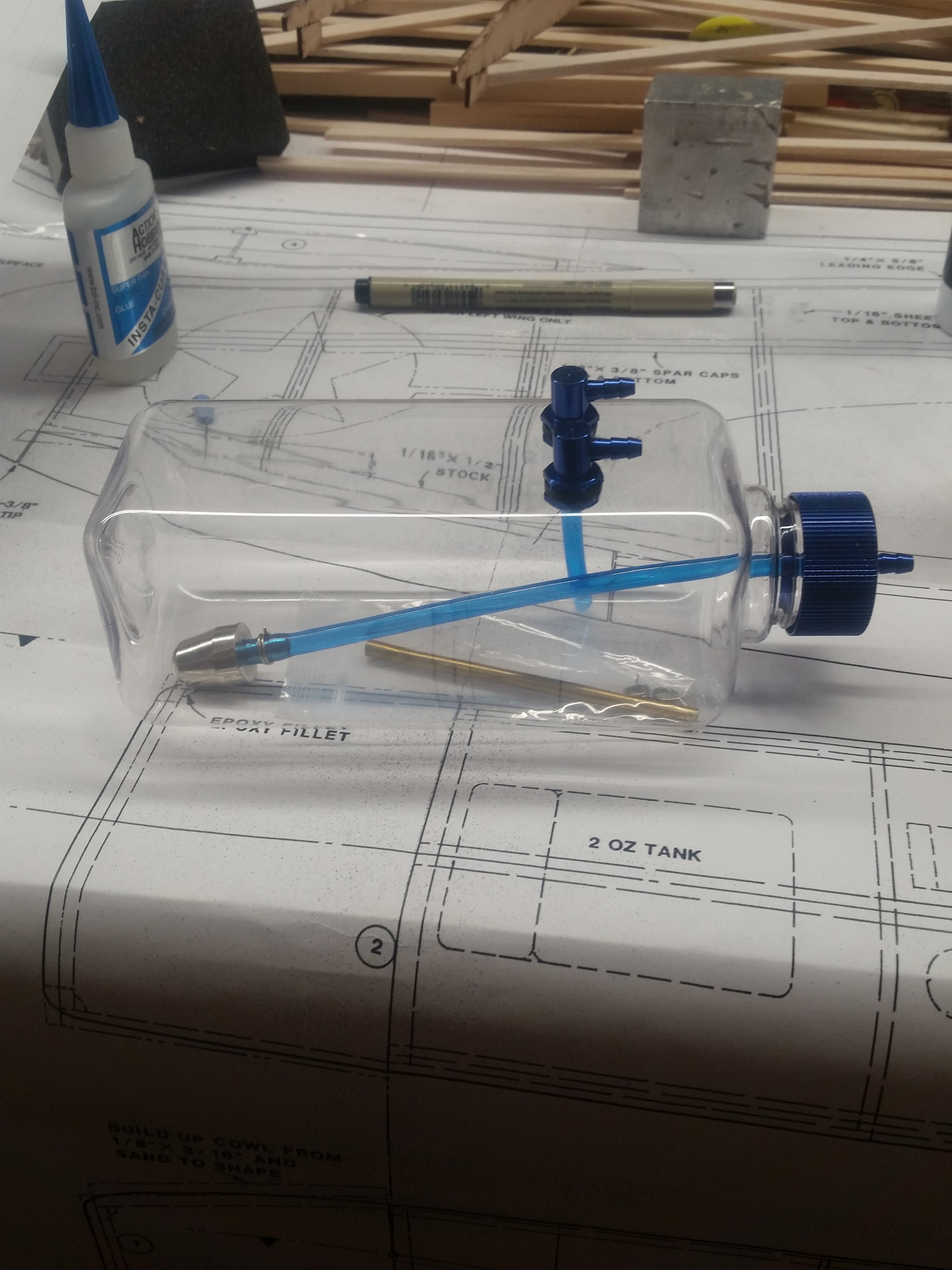

Fuel tank porn and the beginnings of a stabilizer. My fuel tank from TaildraggerRC came in and I'm very impressed. A little spendy but it has anodized aluminum hardware and seem like it will be very durable. I have also gotten started on the elevator. I'm pleased with it so far as it is very rigid.I still have to add the control horns and some diagonals as well as do some sanding. Interestingly hinge points will be close to scale. The Pfalz had a built up wooden elevator as opposed to the welded steel rudder and the elevators on the Albatross and Fokker fighters.

Some tangible progress has been made. I whipped together the center section of the stabilizer and the fin. In the full scale aircraft the stabilizer center section and the fin are integral to the fuselage. It is necessary to get the fin and center section onto the fuselage so that I can mount the rest of the stabilizer and the elevator and rudder. Once this is all mounted up then I can run the control cables. The walking beam for the elevator and the rudder servo will bring the cables out at a location that should be close to scale. I will get a better picture of the servo mount and walking beam assembly. Right now the fin, stabilizer and servo mounts aren't glued in. I just wanted to get a feel for how they will set. I still have work to do lightening up some of the parts, especially the stabilizer.
