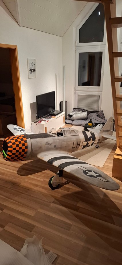

Hello,
I open an tread about the P-47 thunderbolt ARF from KYHK. I am currently in progress to mount the motor Fiala R250 and all components.
I make some modification about the kit to save weight, especially for correct CG and avoid nose balast...
It's a very big model, little bigger than CARF, better in many things, especially access to the interior from the removable canopy.

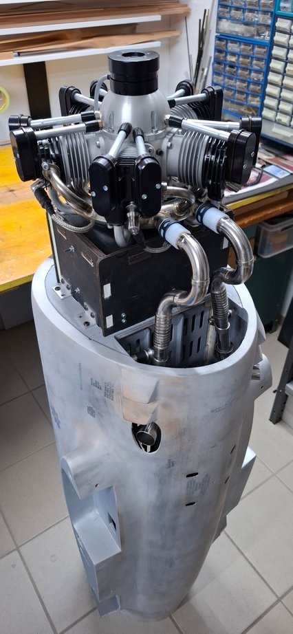

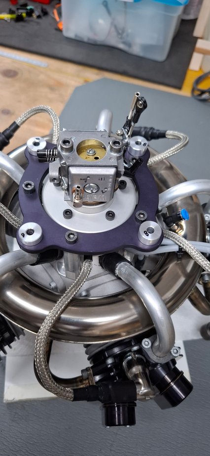

Fiala  / Valach R250
Fiala / Valach R250

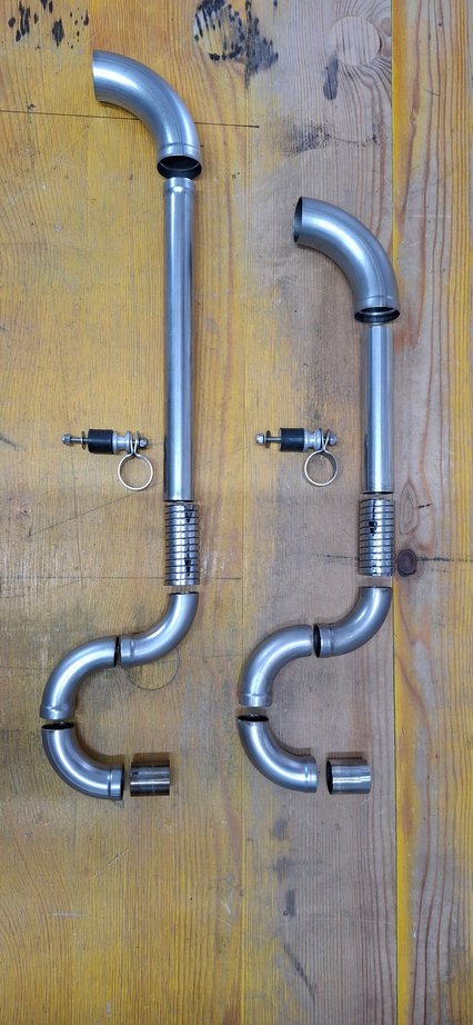

Some pretty self made exhaust

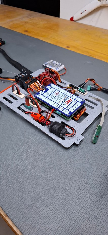

Removable RC electronics tray.

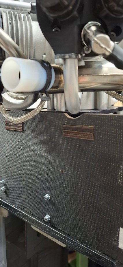

Spacer for engine mount

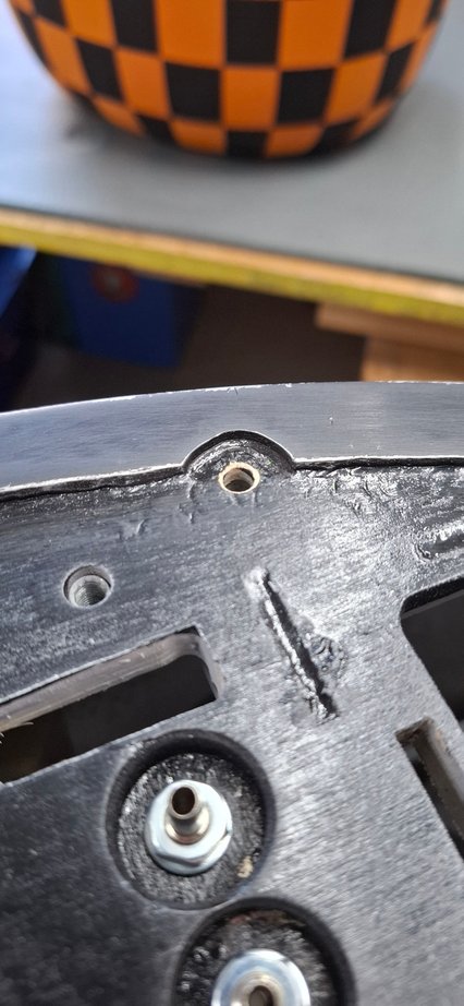

6mm and 8mm spacer
6mm and 8mm spacer
The gap between motor bulk and engine hood is too small...if the motor have overheating issue it will be necessarily to make it bigger

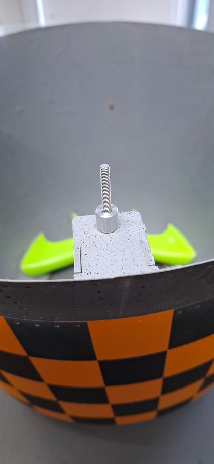

Spacer to avoid that radial come to close at the green part

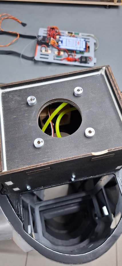

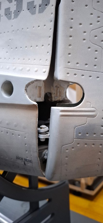

For save weight at rear of CG, i make some modification. The kit comes with 1 elevator servo...for this big plane i want 2 servos in the elevator. I cut the original elevator mechanics away for save weight.

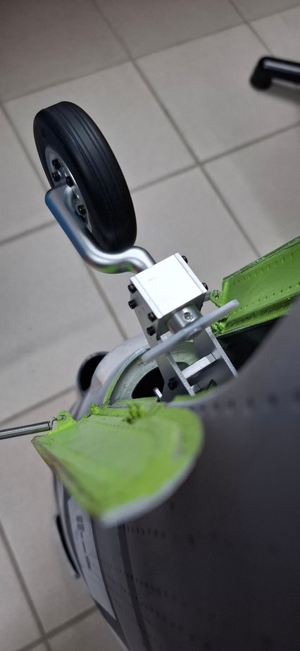

The manufacturer ad 1 servo place in the rear wheel support. For me this is to heavy. I make the guidance withe push/pull cable.
