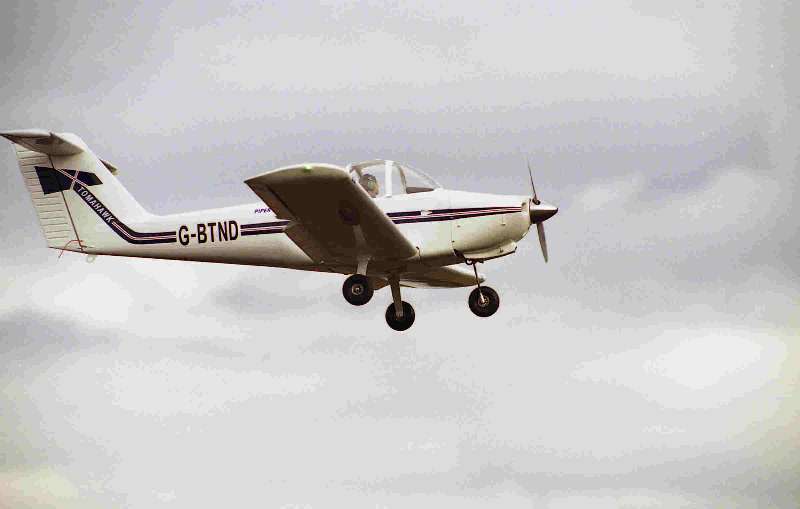

Airsail makes a very nice kit, very scale, for a 54 fourstroke.

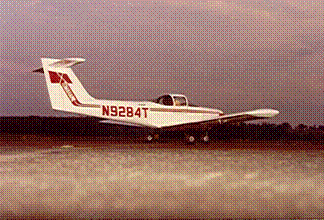

I designed a 1/4 scale Tomahawk back in 1978, for the Q35 engine. I had my model flying before Piper had any production airplanes built. Mine was built from three views supplied to me from Piper Engineering. It is exact scale except I widened the wing chord by 1.5 inches, as I just couldn't go that long thin wing. I used a NACA 2418 airfoil instead of the new airfoil that Piper had come up with. These are the plans that are sold by Reid's Quality Model Products. They can supply you with a fiberglass cowl if this is the size you are looking for. Remember that the plans are now 25 years old, so you may see things that need updating.
Here is a photo of my model and the first Piper Tomahawk to be delivered to our area. Twenty years after that delivery, my son Dick made his solo flight in that very same airplane, 9284T.

I like the Tomahawk and have always thought about someday doing one but, the one shown on Reid's web page looks like a single place fuselage. Is it just distorsion of the photo or is that how the plans have you build it? Also... do you have more pictures of yours?

I don't know what you mean by a single place fuselage. Do you mean a one seater? Mine is a two seater - side by side. Attached are a couple more photos. The first is the model taken at dusk with a flash. The second is the model's very first take-off. The third is the three view that was used to design the model. Hope it icomes through clear enough to be of some value.

Your pictures look correct. I think it's just the web page I saw the picture on at Reid's site. How does your plane perform? I'm looking at possibly getting a set of the plans and a cowling from Reid. Is the cockpit open enough for super detailing and would it be possible to open up the doors?

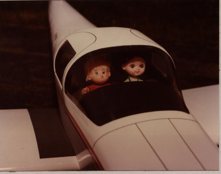

I don't have a photo of the instrument panel, but here is a photo of my pilots. The young lady had her head attached to the rudder servo, so she would look in the direction the airplane was headed.

The photo uploaded successfully, but didn't show up for some reason. Will try again.
