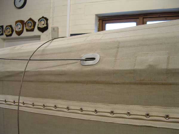

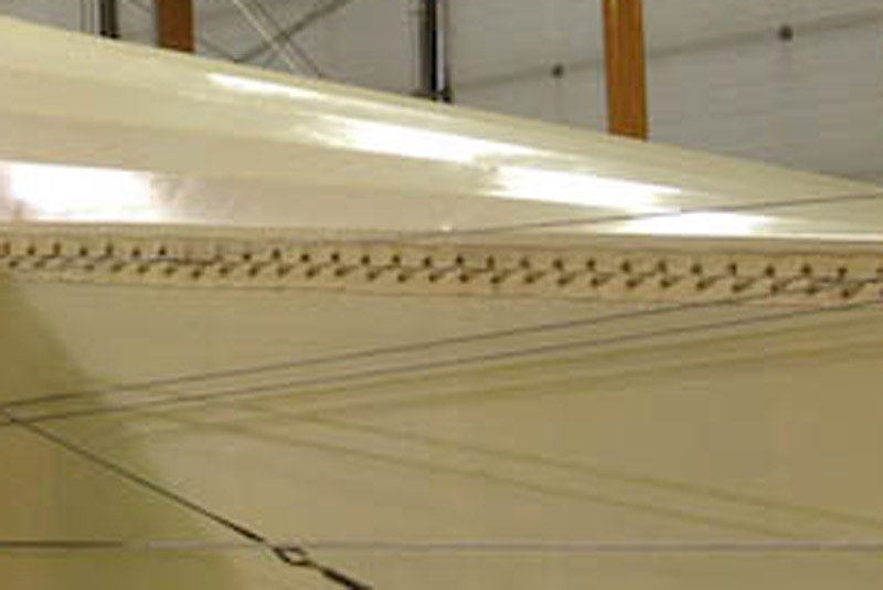

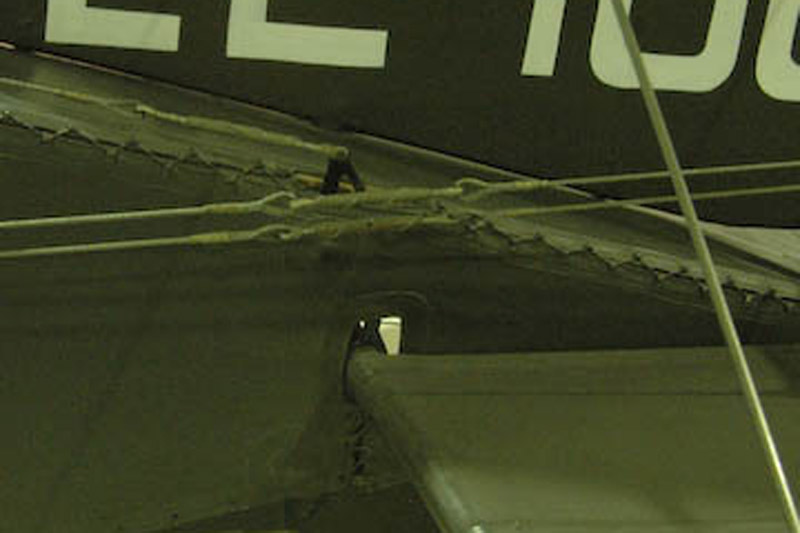

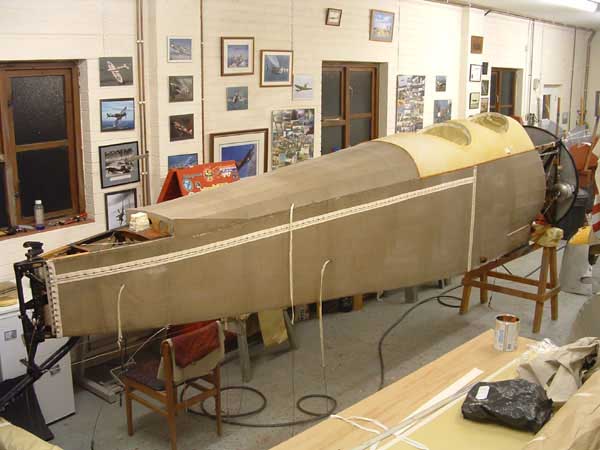

I founb these photo of an alternate way lacing was done on the Sopwith Dove. The last photo shows how the lacing looks when painted. All in all, it's a pretty subtle effect.

Don.. that stiching that you posted looks like the stitching presented in the Sopwith Drawings I have from Replicraft.

I'm pretty sure it varied over time even at Sopwith, let alone other UK manufacturers. From what I can make out in the photos in the Snipe datafile, the zig-zag style lacing was used (as well as a "figure 8" style on the vertical lacing).

Here's another late night experiment with lacing. My last attempt was WAY too bumpy so I sanded the styrene "eyelets" down to almost nothing (I'd do this before mounting the strips on the fuse) and then used a more scale type thread.
But the photo of the Dove lacing also got me thinking that maybe they "double laced" the zig-zag style to get the external V pattern. Notice the double-lacing on the left of the photo and the single-lacing on the right.

I also makes sense to me now why the Dove style lacing might be preferred. Doing it that way, with the seams overlapping, eliminates any potential gap.
