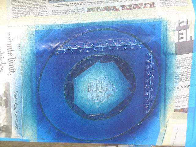

The stitching on the side of my VK Camel presented the problem of available eyelets being too large for 1/6 scale so I put a piece of wood under the area, drilled it and stitched away, minus eyelets. A thin wire (I know, this metal could be causing my radio problems..) gave the appearance of a hem. Now if I can find those photos of this area, they will appear below.
By the way, the vertical stitches looked different so my stitching there was done before covering.

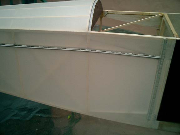

Here's my first attempt at stitching. I started with a 3/8" strip of solartex then folded over (and ironed) the edge to make a 1/8" double layer. I then laid down two of these strips on a piece of tape that held them in place. Next I marked the position of the holes and then did the stitching with a double strand of sewing thread. After I finished the stitching, I turned it over and very lightly scored the tape so that I could remove the tape from the edge of the solartex. I then ironed this onto my practice piece.
It still needs work. This is the same stitching pattern as on Craig's Pup but done this way you only see half of the diagonals rather than the V pattern (which I prefer).
BTW, I tried simulating the grommets with white glue and a tube (rivet style) but that attempt failed miserably. []

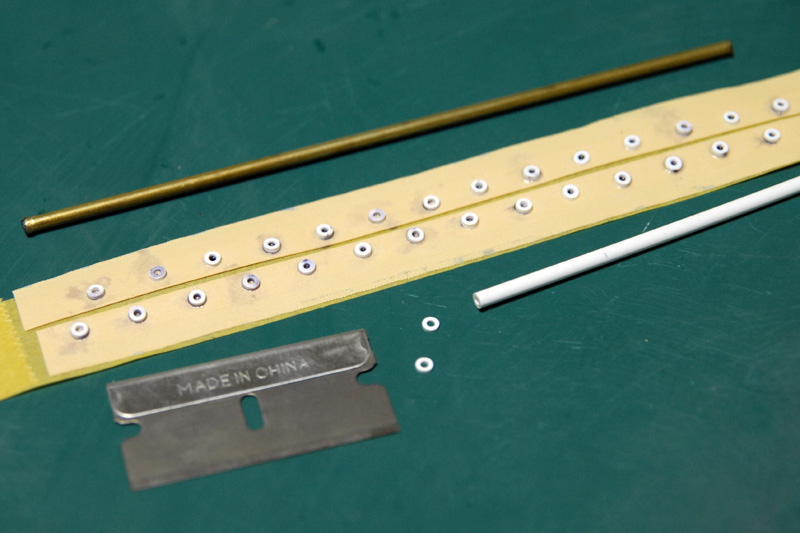

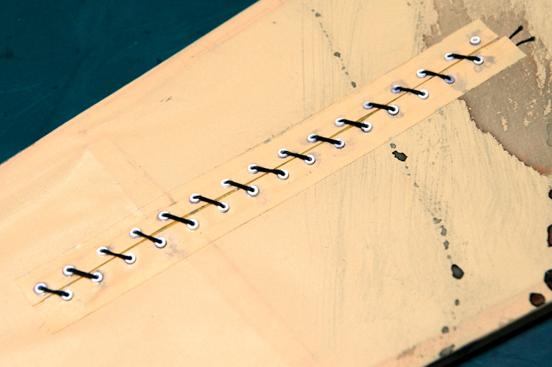

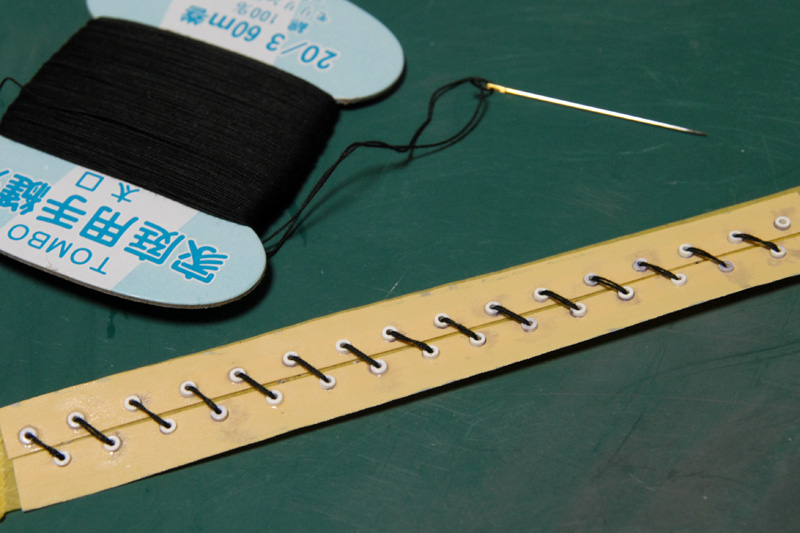

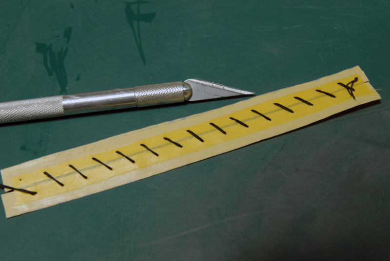

Here are the steps (and the result) of my second attempt a the stitching. It's better but still not perfect (and maybe still too large).

I've been looking at Craig's stitching again and if I understand his method correctly, he did the stitching AFTER attaching the fabric with the eyelets to the frame. That's why we can see the threads in the gap.
Is this right Craig?
