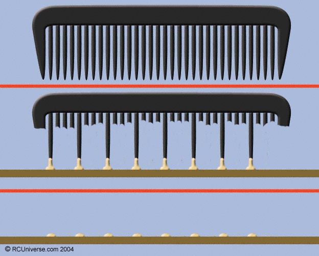

It never ceases to amaze me at the detail of some of the warbirds I have seen. I am especially interested in knowing how you get the intricate parts. For example, I have seen rivets, detailed cockpits and pilots, etc. I am searching for detailed pictures of F4U-1D cockpits and have found a few. Where would I find a resources for the material/process, etc that shows rivets? I searched and found one listing that said he used a mechanical pencil with the lead retracted, then pushed the pen onto the skin. Any other ideas?

A pocket comb with some teeth removed dipped in glue will make some nice round-head rivets

I use a mixture of thined out 30min epoxy and resen with fine tipped glue applicaters it,s long and tedious but the resalts are worth it. I like the comb Ideal . it all depends if you are going to enter your bird in true scale compition of go for stand off scale. as far as cocpit detaling your local hobby shop carries a lage selectin of profile books that go into a lot of detail. these are called walk around or profile books. there is allso a guy on Ebay that is selling profile books on the F4U corsair as well as many of the WW11 war birds. Good luck with your search

Just remember that the rivets are small, most are about 3/8 dia or so. When you plan them on your plane take that into account. Sharpened brass tube also works well for flush rivets. I have an applicator for applying white glue for raised rivets. It takes a while but it's easy work and goes quickly.

Thanks everyone.
I'll check out the books and maybe I'll find some. I also like the comb idea for a couple of reasons - the spacing will be even, and I can get several combs (I'll have to go get some because I have not needed a comb for many years! ) and remove the teeth at varying spaces.
