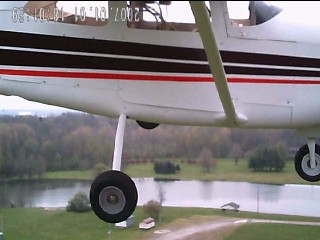

Flying weather in Ohio has not been very good so far this year but there was a couple days last week that I took advantage of to fly the C-182RG. Some pictures are attached.
Don

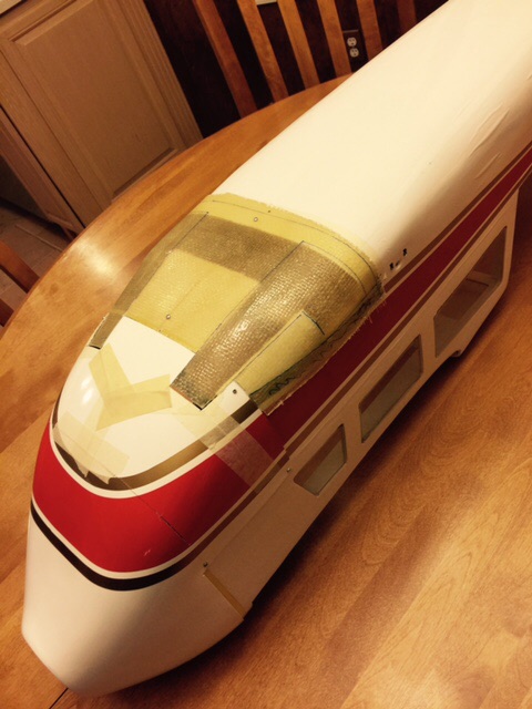

Hi Don, I bought a pair of the Cessna retracts you developed for the Cessna 337 from Radical RC back in April, I am getting ready to start my seagull 337 and wondered if you could tell me if you or someone started a new thread on the gear or plane, and where i might find it.
Keith
Old 10-30-2016 | 03:04 PM
  #206
Joined: Nov 2013
Posts: 78
From: Dayton, Ohio
Hi Keith. I don't check this site very often so I apologize for the late response. There is no build site, but I would be happy to answer any questions that you have. I found it most convenient to work from the underside of the fuselage so I removed all the sheeting from 3 inches in front of the rear bulkhead that was part of the fixed gear framing, all the way back to the rear of the fuselage. I added 1/8th inch plywood to the fuselagesides as well as to the rear bulkhead, for extra support in mounting the retracts.
First I made a Fiberglass bottom to replace the sheeting by stretching Saran wrap tightly over the original fuselage and 3 layers of 6 oz fiberglass cloth and epoxy resin. Once the edges are trimmed it is fastened using small screws. The bottom LG Doors are then cut out and hinged.
Retract operation Link
http://youtu.be/BJ_jE4Wk-kY Radical RC has very detailed instructions for installing the servos and adjusting the retracts for proper operation.
Let me know if I can help in anyway.
Don

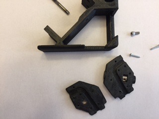

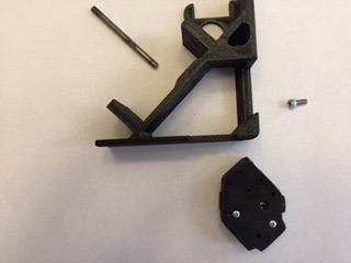

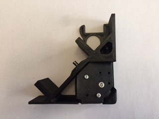

Old 11-03-2016 | 02:00 PM
  #208
Joined: Nov 2013
Posts: 78
From: Dayton, Ohio
Hi Keith
The landing gear strut (wire) is sandwiched between the trunnion block pieces. To disassemble first remove the set screw using an Allen wrench and remove the trunnion shaft
Remove the trunnion and after removing all the screws take the top and bottom parts apart
The landing gear has a 90° bend and is placed into the channel. Reinsert the trunnion shaft and start the set screw into the collar. Then place the top half of the trunnion block over the setscrew and press to sandwich the landing gear.
Reinstall all the screws and remove the trunnion shaft once again
Place the trunnion in the frame with the holes lined up to receive the trunnion shaft again. Make sure the flat spot is under the setscrew. Then tighten the setscrew onto the trunnion shaft.
The bend in the landing gear wire keeps the landing gear from rotating in the trunnion block. The setscrew keeps the trunnion block from rotating on the shaft.
let me know if you have any other questions.
Don

Old 11-03-2016 | 02:25 PM
  #209
Joined: Nov 2013
Posts: 78
From: Dayton, Ohio
Keith. By the way, there is an easier way by just removing the trunnion block top piece while it is still attached to the frame. Just remove all the screws and the setscrew in the top of the trunnion block, and it will come off. At that point you can insert the landing gear and place the trunnion top piece back on. However, sometimes it is difficult to get the setscrew lined up and started with the wheel collar threads. You can try this method first, and if you can't get the setscrew started you could always just disassemble it the rest of the way. Keep in mind that the set screw head is meant to fit tight in the hole of the trunnion block to keep from having slop in the mechanism.
After you take it apart and reassemble once you'll find it's pretty simple to do in the future.
don
