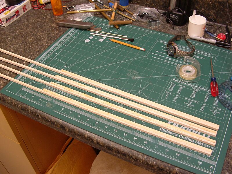

Well here we go on a start to finish build of the Wedell Williams Racer. This is my first Byron kit and all I can say is WOW. The glass work is stunning, all parts bagged and inventoried. Source material will come from several websites that discuss the Wedell brothers and the book "Wedell-Williams Air Service" By Robert Hirsch and Barbara Schultz. I have the decal set for the Red Lion #121 but the #44 scheme looks really good too.
Power will be a G62. Probably Duralite lithium batteries at 6volts. Servos not chosen yet.
Any comments, suggestions, improvements are welcome. Not much on the boards about this plane with no prior build thread so I'm hoping to get a lot of info in here.
Pete

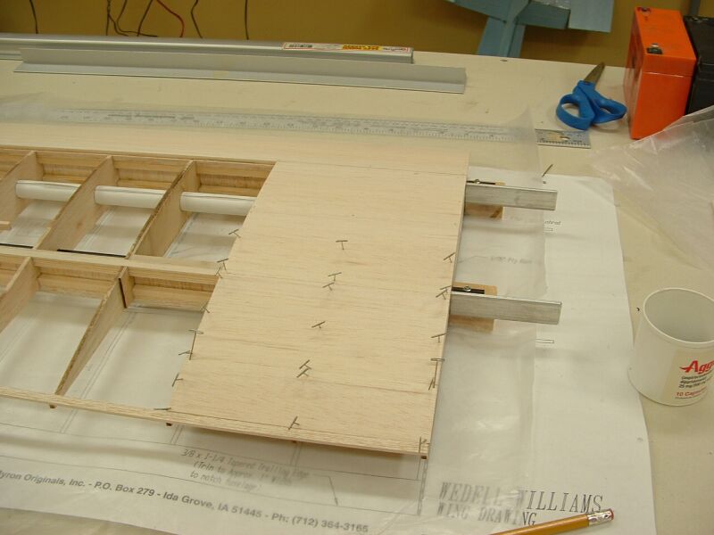

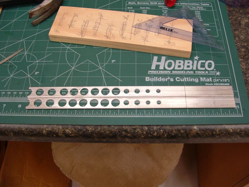

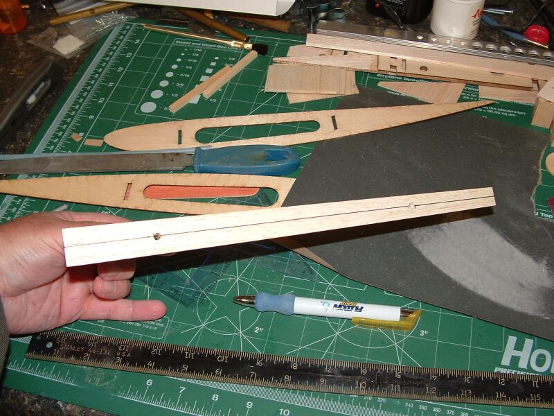

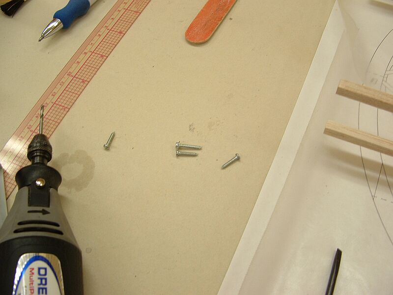

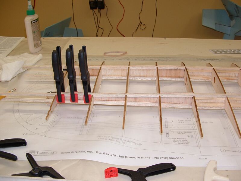

Progress so far. Made the spars and W-1 ribs fro both wing halves. I used socket head servo screws instead of the 1/2 in #2 screws to anchor the rods. The #2 screws are not long enough when you add the 1/8 in washout spacer.
Pete

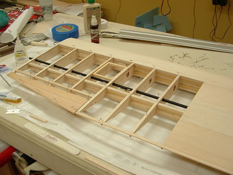

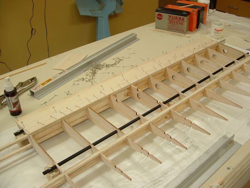

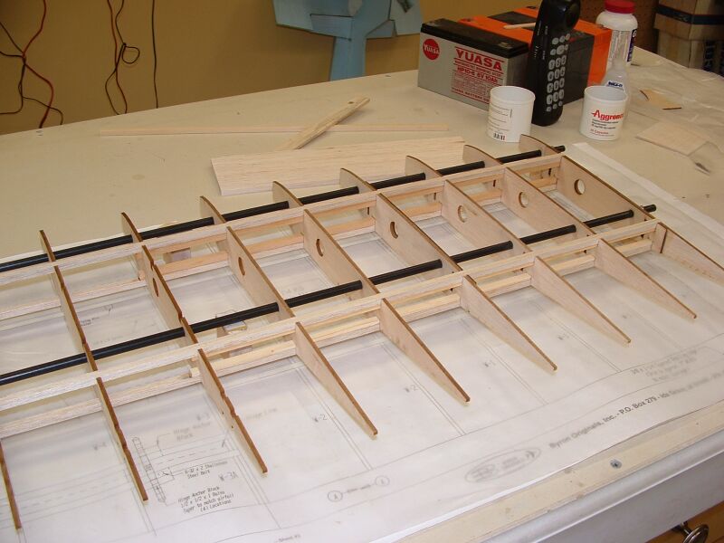

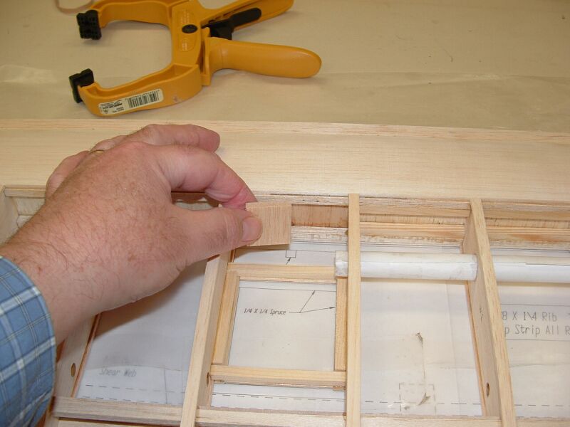

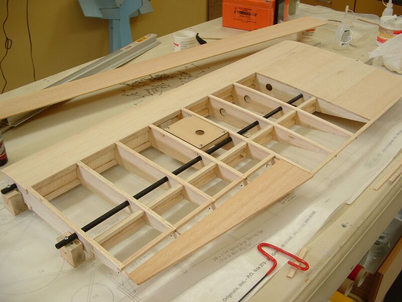

Progress tonight. Finished the shear webs. The plans had you stop one bay in from the end and I extended them out between ribs 6 and 7. Care was needed to get the rear spar down in the rib as you worked out past rib 4. I was checking for squareness and ribs perpendicular to the board as I went along.
The aluminum spars were filed, straightened and cut per plans then test fitted and epoxied in place after the shear webs were done.

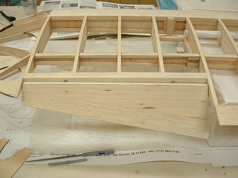

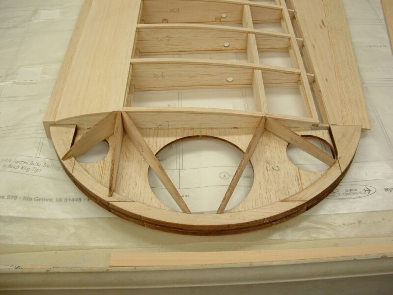

Drying glue gives me a chance to post...

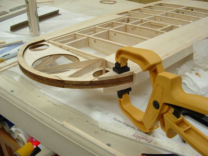

I purchased a set of Permagrit sanding tools in both coarse and fine for this project. I got tried of taping sandpaper to dowels They work great. Sanded the webs then before sheeting I made a paper tube for the aileron servo lead and glued it in place. On with the 1/8 sheeting and TE balsa. I tack glued a 1/32 shim to W-3A and pinned it per plans. Sheeted the aileron and placed all the cap strips. Then more sanding...
The wing was removed from the board and all joints were glued. The wing was placed on blocks again on their taller side with 1/8 shims except the outer TE to keep the washout in the wing. Sanded the webs then sheeted the bottom. The spruce rails were added and the cap strips placed. At this point I noticed the 1/16 ply servo hatch would be about 1/16 deeper than the cap strips so a took some of the 1/16 ply scrap and placed it on the spruce rails. The servo hatch now sits flush with the cap strips. Yes I was very careful with final sanding to be sure I didn't make the strips to thin around the hatch.
I chose to do the LE and TE sanding with the wing on the board. It''s secure and safe. Measured the LE and TE balsa. Glued the LE on and am making the wing tips.

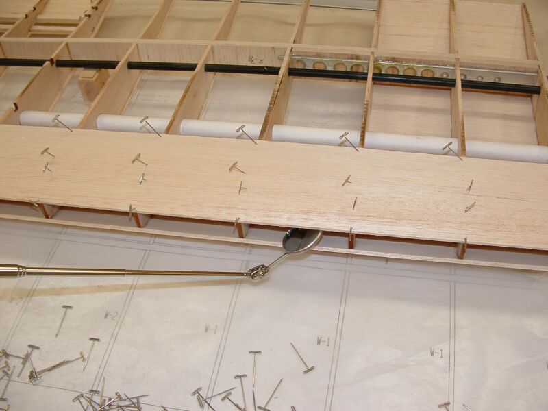

Default RE: Byron Wedell Williams Racer Build

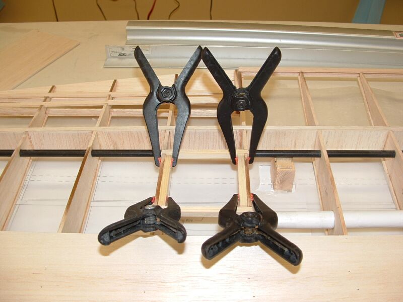

More photo's. I use one of those mirrors on an extension wand from Harbor freight to check glue joints it tight areas. This is one of the easiest wings I've built with the laser cutting and jig.
Pete

Work and some good flying weather got in the way of building [8D]
Got the leading and trailing edges on then on to the wing tips. The tips and doublers went together fast and I did both at the same time. Gluing the tip on took some care to be sure it was perpendicular to rib 7. Filler blocks added and ribs on the top and bottom.
Sanding everything to shape took some time. I use the masking tape to protect the cap strips while forming the new areas. A razor plane and sanding have the leading edge looking good.

Outboard rib W-7A was glued in and the aileron cut free. The 1/32 clearance gap is not enough for the aileron after covering and painting so I sanded the sides of the aileron and the gap is now about 1/16 which should be ok. Hate to have a finished aileron bind [&o]
Balsa blocks for the hinges were set then the leading and trailing edge balsa applied. Using the Robart hinge centering guide I drilled 3/16 holes for the hinged then marked the centerline of the aileron. planed and sanded the aileron was shimmed to center and the holes for the hinges were marked and drilled. Some "squaring" of the holes to set the hinged deep so there is no gap. The finished aileron looks good with plenty of throw and good clearance on the sides.

Finished up the Lt wing by drilling the servo hatch and attaching the servo mounting blocks. Then the aileron control horn was placed per plans. I'll do the rods for both ailerons later. Will do the final sanding later as well.
Building the Right wing half starts with setting the blocks on the plans as before but the ribs are placed on the rods UPSIDE DOWN from the Lt wing build. The spars are mounted.
Pete

Work progressing on the rt wing. Same as before only I used a 1/16 spacer for the aileron gap. The tip gap will also be adjusted.
Pete
