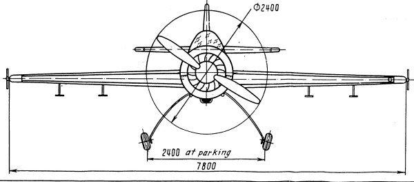

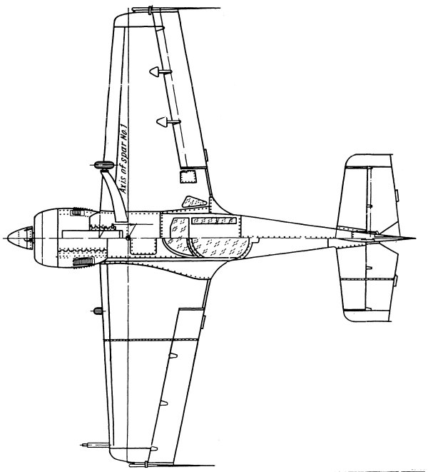

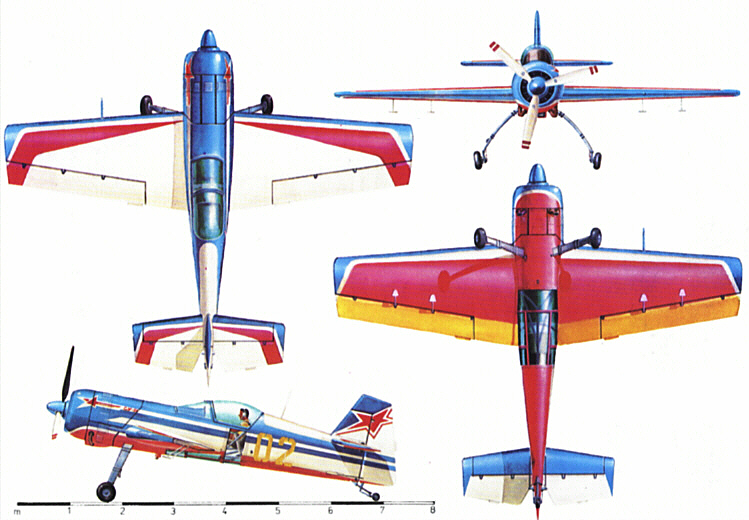

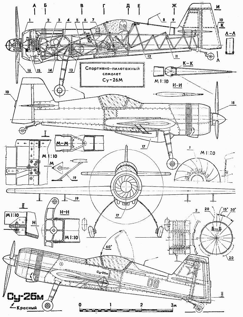

Thanks for the recommendations chaps,
by the way here are the 3 views I have of the Sukhoi 26 M (If Im not mistaken)
ID:	322591   Click image for larger version
ID:	322592   Click image for larger version
ID:	322593   Click image for larger version
ID:	322594   Click image for larger version
Old 09-11-2005 | 01:42 PM
Shahid's Avatar
Joined: Dec 2003
Posts: 1,538
From: London, US MINOR OUTLYING ISLANDS
Default RE: Beginner guide to making rc scale plans
Ive discovered something, the first 3 views, are of the SU 26 M2. The tips are atriaght on the wing and tailplane plus the air intake on the cowl is far more elongated. Also the cowl has a slight bulge left and right sides. Also the canopy blends into the fuselage sides more.
The colored view and the one with russian writing are of the SU 26 M, the first version. These have the angled tips and a different shorter air intake, also the canopy is more rounded and bubble like.
I have 3 views and cross sections, all quite detailed for the M variant. But I'd prefer to do the M2 variant, for which I have no cross sectional information.
