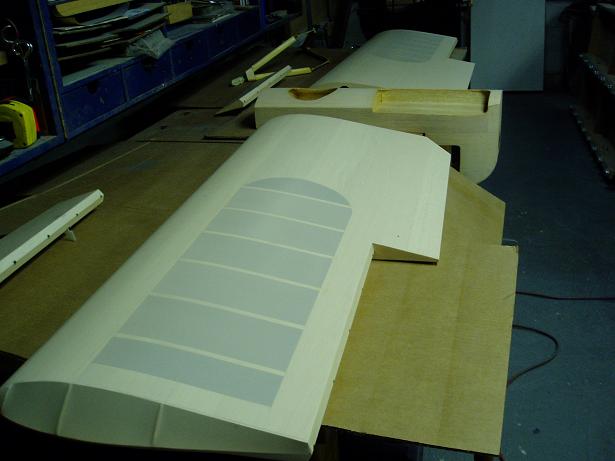

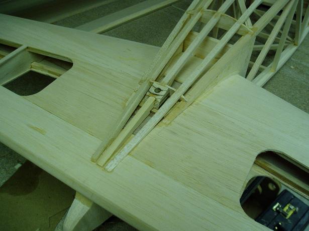

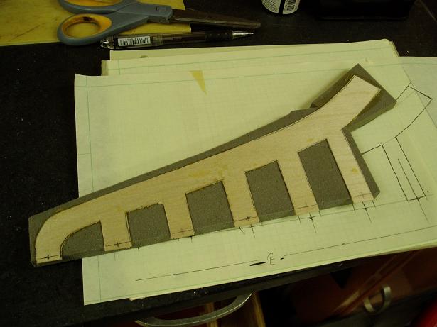

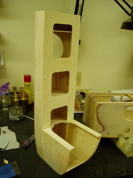

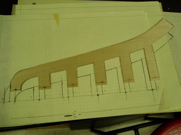

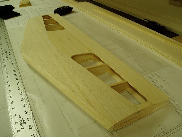

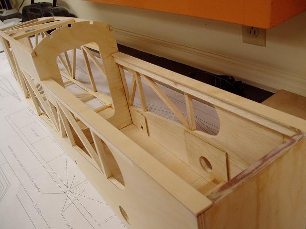

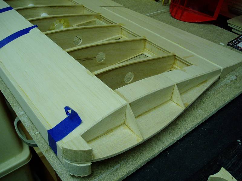

Thought I would try and stir some interest in this airplane: There's booming interst at my field in WWI - mostly Balsa USA kits. Guys are doing lot's of simulated dog fights, formation flying, fun flys, etc. I was looking for quick build monoplane that's not too common, looks like a good performer, good platform for smoke, bombs, and bailout pilots! Also needed a semi-scale WWI plane that will outfly the BUSA planes and one I wont be afraid to really mix it up. I've started building a Junkers J10 from M.A.N. plans, designed by Dick Allen and drawn by Ralph Jackson in 1999. I'd encourage anyone with a kit or two behind them who wants a relatively simple semi-scale WWI warbird to check it out! The plans are pretty self explanatory although some details are a bit sketchy. I've nearly finished the wing in about 15 hours. If there's interest I can continue to post some pics as I go. I do plan on putting a more scale flying rudder (rather than the fin-rudder design Mr. Allen chose). Two other departures from scale are constant thickness wing and no corrugations. I'm curious - has anyone know of a detailed scale build of this plane? There's not a lot in the literature but I think it is a really interesting "crate" that's not (in my humble opinion) as ugly as many people think!

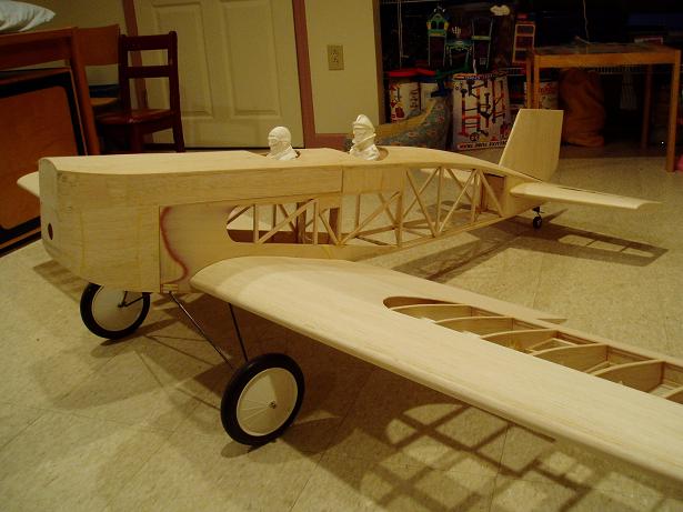

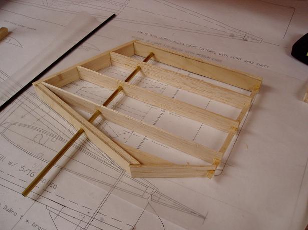

A few more pics of progress on my J10. I decided to build a full flying rudder rather than the fin-rudder combo on the plans. Also changed the hatch design so it includes the whole cowl rather than just the top - increasing access to the engine and eliminating the need to bend the fuselage sides. Several areas seemed to light-weight for my taste: I beefed-up and sheeted the trailing edge of the stab. Added diagonal ribs to the elevator to increase torsional stiffness. I also felt the lack of bulkheads and limited structure along the top of the fuselage invites bowing and buckling so I beefed up the top of the sides with balsa and ply. Added stubby 1/4 ply doublers on each side of the firewall and hardwood triangle stock to tie the front together more solidly. I moved the wing aft 3/4" to improve balance. I didn't notice until too late the aft LG attachment point is much farther forward than scale, and looks alittle odd to my eye but decided to leave it where it is since this is not a serious scale project. Also be careful the LG layout on the drawing does not show enough metal to go completely through WB wheels; lengthen to suit.
The rudder post is double sleeved brass tubing with a core of carbon fiber for stiffness; its important to make sure the post wont flex under aerodynamic load causing the rudder base to bind against the fuse. The post fits a tube in the fuse and emerges on the bottom, where I'll fit a control horn and spring-links to the tail wheel.
On the whole a nice looking airplane, easy to build and coming along nicely!

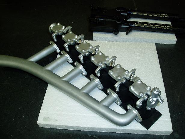

While waiting for paint to dry, I thought I would build a Mercedes engine rather than use the WB Gnome cylinders. The build time is probably less than the amount of time I'd spend explaining the Gnome at the field!! The last mercedes I built for my Pfalz DIII/a was from a Proctor kit. I decided to scratch build this using by resin casting the cylinders, manifold flanges, and rocker parts. (The dowl sticking out of the mold in the second picture is wrapped in plastic wrap so it can be pulled out of the cylinder casting, producing a hollow cylinder to center to save weight.) The bevel gear housing and other bits are balsa, plastic tubing, dowls and wire. Muffler is made using a 1/16 plywood pattern/core, with foam cheeks top and bottom, whittled to shape, glassed and painted. I use textured rustoleum to give it a cast-look. The short dowls are hardpoints to drill and pin the muffer to the cylinder.
