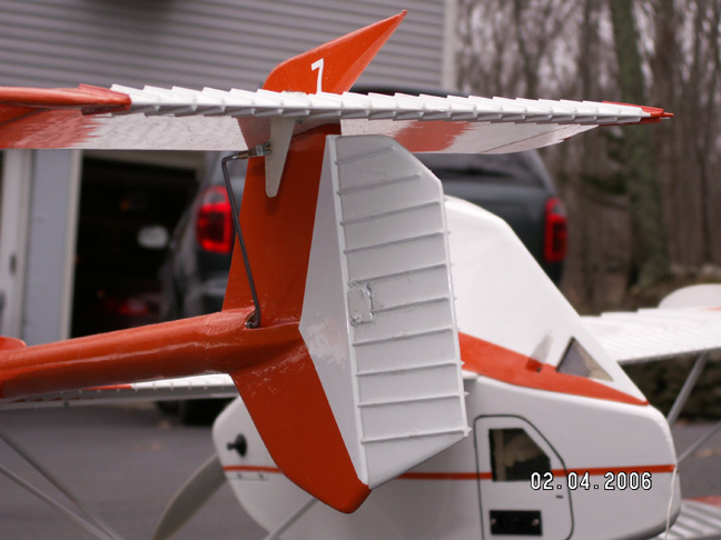

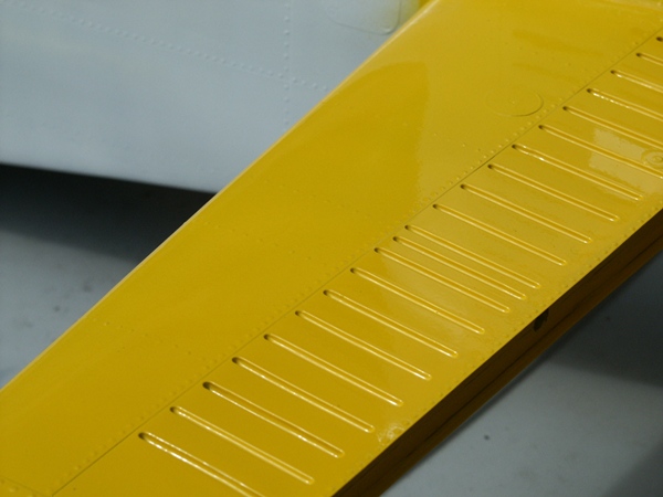

When I did my Airtruk I used "Plastruct" styrene "T" beams, cut them to length and glued them to the Ultracote using RC56 canopy glue. Tedious, but works very well and any "misses" with the glue doesn't show, plus, it does not "fog" as CA tends to do.

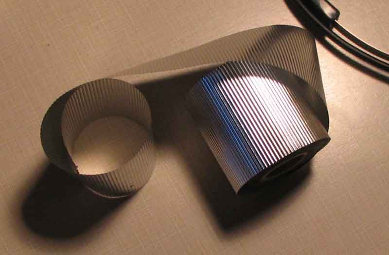

I've been away from R/C and working in smaller scales. I have used a mylar streamer from Paper Art that looks great. I have seen it at different widths at the craft store. Here are a couple of pics. This stuff is very light but not very rigid. Might be a good fit on smaller surfaces like trim tabs and stuff like that.

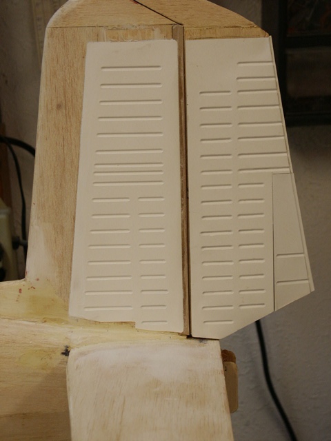

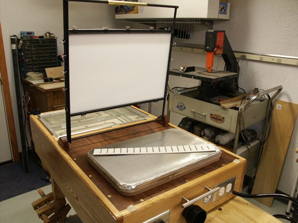

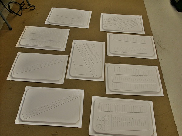

I wanted to make realistic corrugated control surfaces for my TopFlite T34 project. Because of the nature of the corrugations and after much head scratching I decided to build my own vacuum forming machine. After that I had to make all the formers out of Formica. It was months of extra work but I am very pleased with the results.
