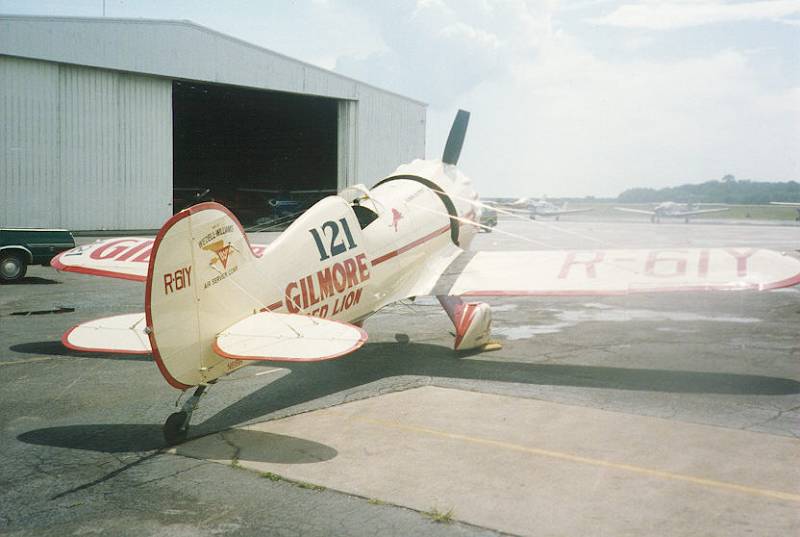

Bob, this is the airplane
& i want to know if there is a hiden FIXED wheel in the skid will it be steerable during take off before the wheel gets of the ground
the second pic shows what has been done to the real plane but i don't like the "modern" solution....

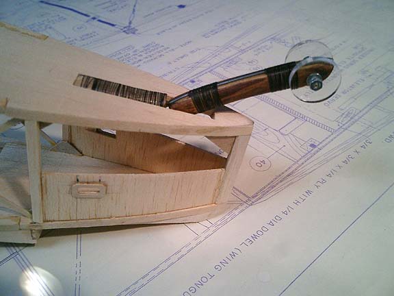

I use non-steerable tailwheels on my two 1/8 scale Fokker E.Vs. They are a bear to take off and land otherwise. The nonsteering aspect is fine, with a little speed the rudder action is usually sufficient. On the other hand, I don't taxi around a lot, just set the plane on the runway in the right direction and go.
On the Camel (1/6th scale VK kit) I am building now, I will use a tailwheel on asphalt but remove for grass or dirt. See the pix.
Allan

I did some searching on the net about the tail skid on that plane and I didn't find anything conclusive that would tell me if it was just a tail skid OR it had a small wheel inside a fairing. If I were you I might try locating some drawings on the plane... Or.. just put a small thin wheel inside a fairing.

thanks Allan, that's what i needed to know.
