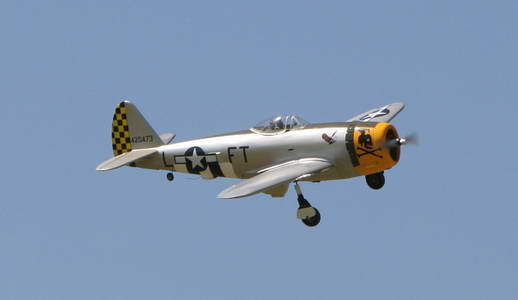

I have a Topflite Jug as well that is massively over weight at almost 14 lbs [sm=eek.gif](my first attempt and glassing a few years back
) powered by a 1.20 four stroke it still flies beautifully and low speed stability is amazing. Top flite kits are almost fool proof and easy to build and fly.......i would howver suggest you get some low wing experience under you belt first.
Here's a shot of it in a low slow pass - gear down
) powered by a 1.20 four stroke it still flies beautifully and low speed stability is amazing. Top flite kits are almost fool proof and easy to build and fly.......i would howver suggest you get some low wing experience under you belt first.Here's a shot of it in a low slow pass - gear down

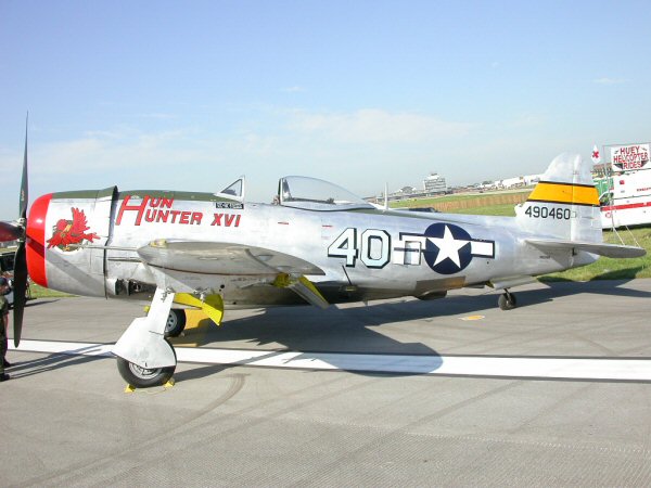

You don't like the looks of a Jug??!! Hey, it may not be a beauty queen but this is one great looking hunk of metal! I mean, how can you not like 2,000 horsepower in a seven-ton airframe with eight .50 caliber Brownings that could soak up axis lead like a sponge and still bring its pilot home? It may not have been a pretty ballerina in pink tights but it was definitely the fat lady who sang at many an axis flyers funeral! Read Robert S. Johnson's book, "Thunderbolt", and be prepared to be impressed.
Take one more look at this bird and tell me this isn't beauty on the wing. (Pictures lower down.)

i agree with you that the thunderbolt does look alright, but only from the side. i dont like the fat fuselage with the short stubby wings look.
The advantages that i see with the thunderbolt are: 1) easier to fly. 2) bigger fuselage for radio gear ect. 3) wide undercarriage base
The only thing thats stoppin me from buying the spitfire is, less engine cooling, more chance to flip, and tail heavy.
