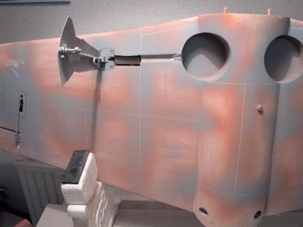

My wings are ready for painting, but the surfaces are flat. I would really like to make some real panel lines before I paint it. I've found out by putting a little pressure with a pen will make a mark. I'm just woundering if there is a tool I can get.
Greg just get you some 1/32 chart tape and tape out your panel lines. then primer your plane with a fairly nice coat. when everything dries wetsand it just until you can see the chart tape then peel it off and lightly wetsand some more just to clean up the edges of your panel lines then paint your plane. it is a super easy method and gives you a better panel line than just drawing them on.

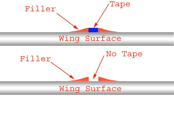

I have used the tape method explained above, however I now prefer the following:
1. Stick some masking tape on your wing with the edge on the panel line.
2. Apply a very thin smear of filler up against the edge of the tape.
3. Sand (I use fine wet & dry, used wet) to blend the filler into wing surface.
4. Remove the tape, to be left with a raised edge to your panel.
The picture shows the results on my Royal Bearcat.
Simon.

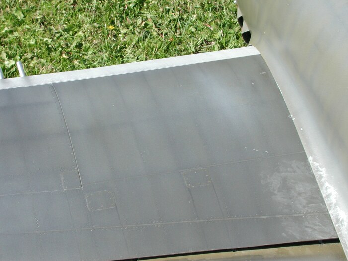

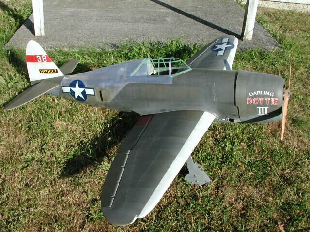

The method Simon shows is great for raised or over lapping panel lines but most planes have panels that are not raised or over lapping. The best way to reproduce these is with chart tape and primer as described by Joe. Here is a picture of a P-47 that shows what chart tape and primer reproduces.
