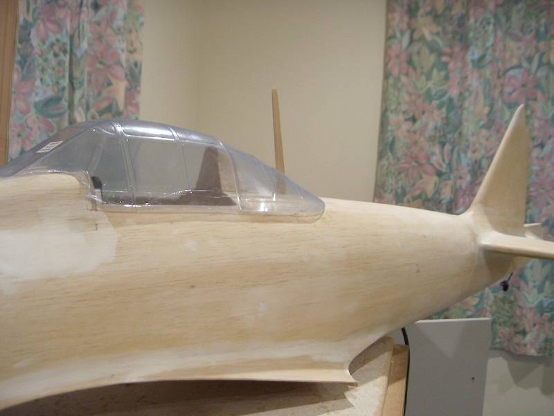

Old 10-12-2006 | 01:53 AM
Joined: Apr 2006
Posts: 144
From: Kaiapoi, NEW ZEALAND
Default RE: Scale antennas
I agree with whats been said....on my aircraft I always run the antennas inside the fuse inside a tube.The first thing that gets damaged when picking the plane up is the antennas that is on the outside.If you want to have a scale antennas on the out side ,I use a shaped ply vertical base ,then fit a thin line on and up to the tail.Very easy to replace if broken and doesnt affect the radio. The pic shows what I have done on my Zero.
