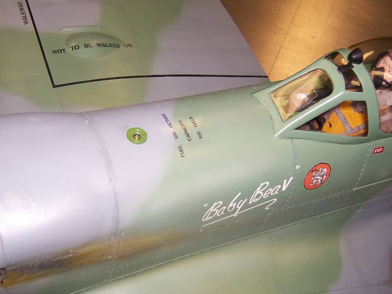

Could someone help me figure out which type of tape I would use for a 1/5 scale plane? I figure the crepe tape is good for curves, etc. and the gloss is what I would want so the primer wouldnt stick to it. But what width for a 1/5 Scale bird?

If it were me, I'd still stay with the 1/64th.

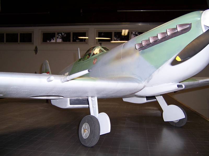

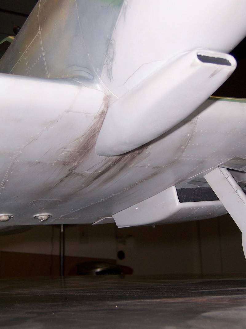

So far, I've only used it on 1/7 scale. However, the panel lines on full size planes are very small, and I would think the fine line that 1/64" tape makes should be sufficient for scales up to 1/5th or maybe even 1/4. One area of exception might be for simulating the joints of removable panels such as engine cowls. There you might want to use 1/32" just to make them more pronounced than the rest of the panel lines. Accenting panel lines when weathering is what will really make them pop.
