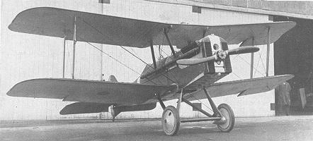

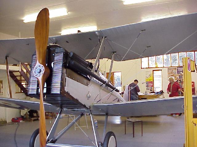

FunAero has their own scale problems if you ask me, maybe worse. Look at these two photos of the nose and note the prop placement and radiator detail. Original and model.

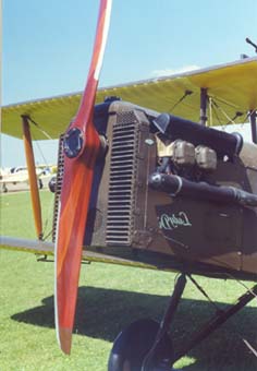

The original SE5a also had engines that mounted with the prop exiting the lower area, I forget the name of the engine but I have seen photos of them. With the FunAero you can mount your engine inverted to put the shaft out the top or right side up as the photo shows and put it lower. The Dynaflite also has cutouts in both locations for mounting. A good reference is the Chilian Air Force, they used many SE5s in the late teens and through the 20's. I dont have the web site handy, but you can do a search. I really have to say that the FunAero is overpriced for the kit you get, in thier 1/4 scale the BalsaUSA looks just as good (only my opinion) and is 100.00, and comes with much better documentation, hardware etc. I have thier Fokker DVII and am very impressed with the kit so far(have only looked longingly at the parts, have not started the kit, I do however have a 4 stroke conversion flight tested and ready for the plane but thats another story)

By the way, I believe that picture is of a 7/8 scale replica, notice the cub-like cylider heads poking out the side.
The correct position is slightly below centerline of cowl. The furaero is ridiculosly low, almost exiting the bottom edge. Here are all original SE5As: My German drawings of a captured SE confirm the placing.
BTW, from those drawings, I have computed your wing separation should be at exactly 10.4 inches. I'm just guessing they have it at what, 11 1/2 or 12?

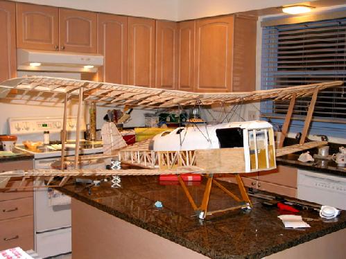

I have SOOOOOO MUCH information on the SE5a.. !! I'm building a Scale Masters quality SE5a so I have had to do a lot of research. There are several sources for the info on the plane. Windsock specials and squadron publications to name a few. There are two different engines used on the plane depending on when it was built. Each engine is distinct in its location with regard to the radiator. One is low, as pictured in the previous posts and the other Higher. The lower positioned engine is the Wolseley Viper and the upper one the Hispano-Suiza.
I'm attaching a pic of my SE5a in the bones..

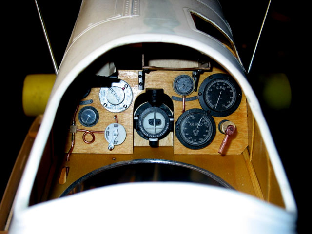

The pictures didn't post so I'm trying again..

Beautiful SE5, I love the instrument panel. Thanks for the heads up on the engines, I knew I had read about the Viper engine, just couldnt remember the name.

Prop nut, thank you.. I'm just about ready to finish covering the plane. I have a few odds and ends to make. Seems as though this plane has a lot of fixtures!!..

You are a bachelor yes? My wife would remove body parts from me if I did that in her kitchen, lol.

Really nice job, Bob. SE-5's are such interesting a/c. As far as risking flight performance by lowering the top wing, I agree... If it worked on the full size, the model will typically follow suit. Remember the old Top Flite kit? Very scale, and a good flier too. Ground handling was always interesting. I'd end up on the wheels about 50% of the time. I learned quickly to mount the Lewis gun with small pieces of fuel tubing.

Your plane looks fantastic. I'm going to get this one looking scale from 20 feet, and if I can get her up and down a dozen times in one piece, THEN I'll start the detailed stuff. I will add little strips of balsa for false wing ribs at the leading edge though before I cover it.

Prop nut, nooooo I'm not a bachelor but the island was the only place I could get a decent photograph of the completed plane. I have an understanding wife..

My plane started life as a Duncan Hutson kit and has been extensively modified to represent my chosen subject. I have been working on it, on and off, for about 3 years. Much of that time has been devoted to design changes, fabrication of the "details" and information gathering including the proper paint colors. The last one I have agonized over extensively. Since I plan to compete with the plane my documentation needs to be right on. Any way, all has been sorted out.. finally!

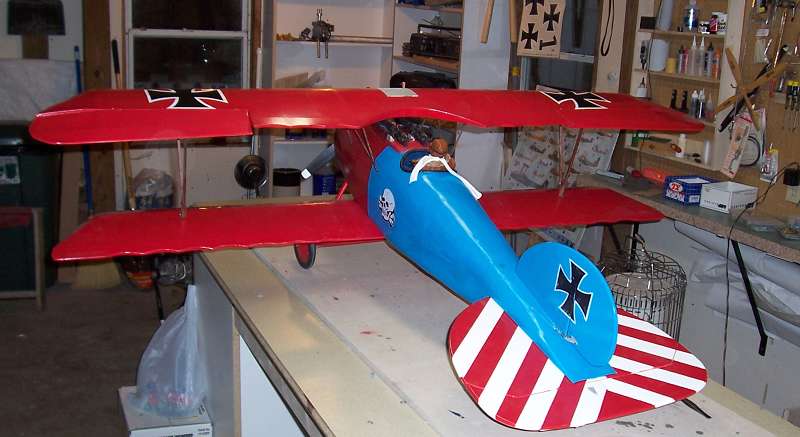

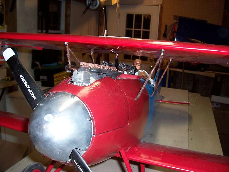

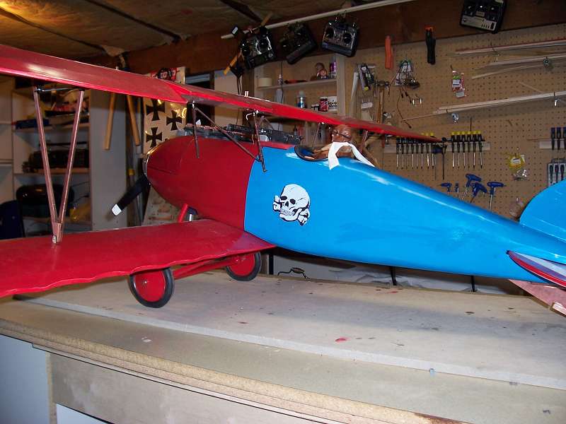

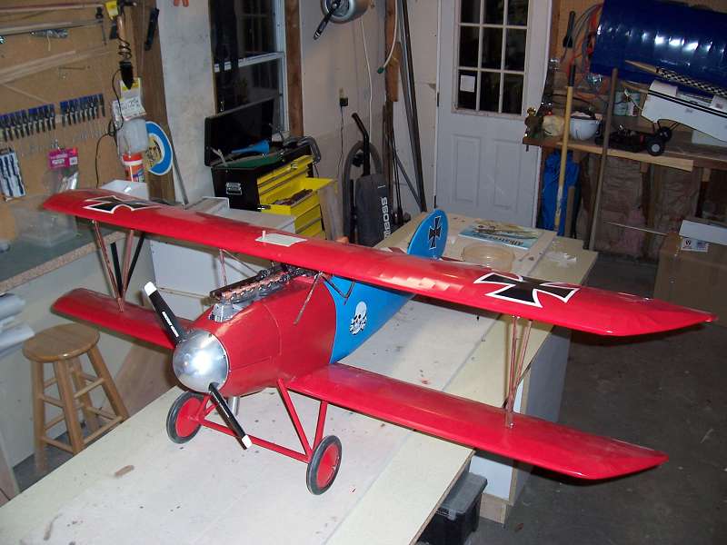

I know this is a little off topic but I just finished my 1/5 scale Albatros (funaero) I purchased this to be a pair with my SE5a. Its covered with Supercoverite and painted with krylon. I did the decals on the fuse with white inkjet water transfer decals and the wing decals are Major Decal. It has a Magnum .91 four stroke, and I hope to heck I dont wreck it on the first flight (hopefully if the weather clears that will be tommorow)

Looking very nice. I'm still working on the SE5a and the modifications. I think I've just about decided not to try for the stock 5 degree incidence. It would just require more structural changes that I feel like dealing with right now.
I will set the wing at the correct spacing and reduce that downward slope from the cockpit to the nose and make it straight like the real thing. I don't know what the heck Dynaflite was thinking! other than to make the fuse higher under the wing as to not draw as much attention to the incorrect spacing.
I started a build thread in kitbuilding, but there is a distinct lack of interest.
BTW, that wing in the background, was it removed from something or forcebly detached from something?
