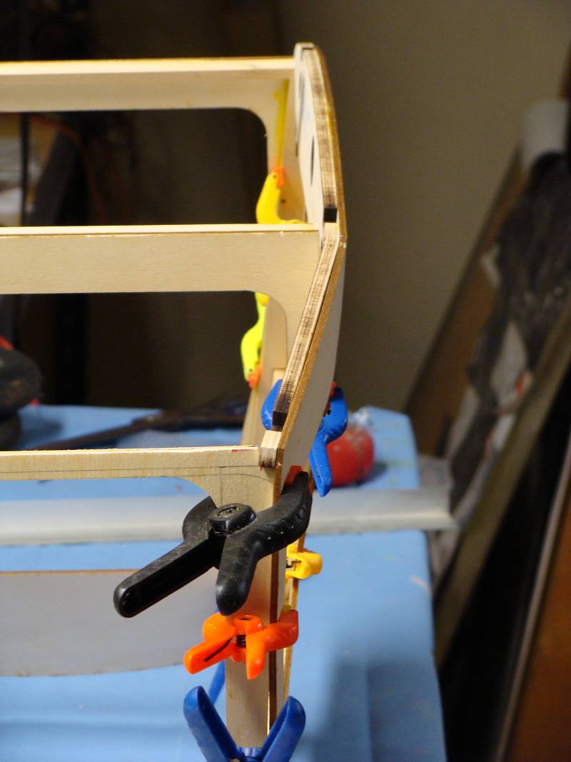

Just made the blocks that will shape the gear from the front view. Yesterday I visited a dog thats currently undergoing restoration. I measured the gear. The first lay-ups will be .250 at the fuse attachpoints and about .375 at wheel attach points. The real gear is only about .800 thick everywhere. I'll try these dimensions which should be a lot closer than any other gear available. Of course if these dimensions turn out to be thicker than neccesary I"ll reduce. I can lay several sets once we know they'll work for cost of the uni. I learned a tremendous amount about this airplane by just shooting 100 photos. Which 3-views are you guys using for the vailley kit?

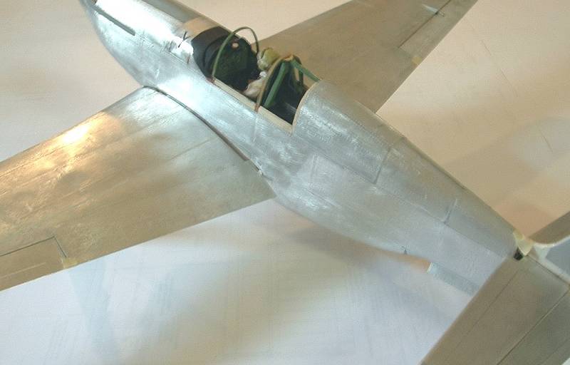

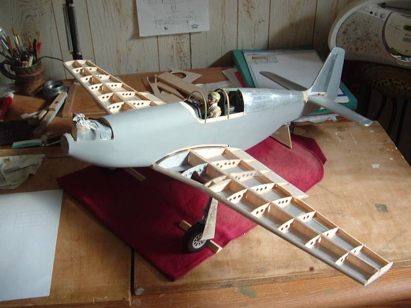

I can walk the walk, also. Attached are photos of a 36" wingspan P-51A I designed and am in the process of finishing up. Target weight is 16 oz. RTF. Fully aluminum skinned, full, animated pilot moves with controls, detailed full cockpit/radio compartment, functional canopy, (Wheels are for static displaly only.) Aluminum over Mylar wing skinning, aluminum over 1/32" balsa fuse w/built up empennage. Now, about the impossible, 15 lbs. scale detailed 1/4 scale Birddog...hmmm a 1/4 scale pilot with full rudder/stick animated pilot...spotter!? Yeah, and make the pilot's throttle hand move, too!! Yeah!!! COOL!
This is what's possible when you stop accepting what's been done and explore what could be.

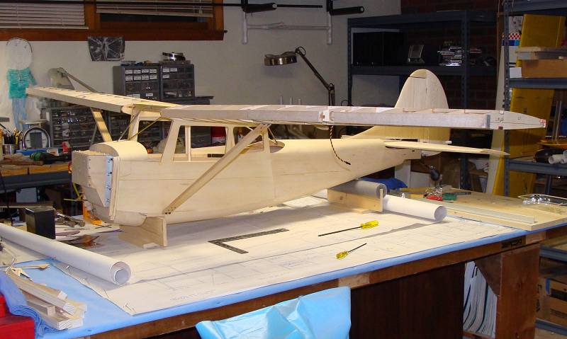

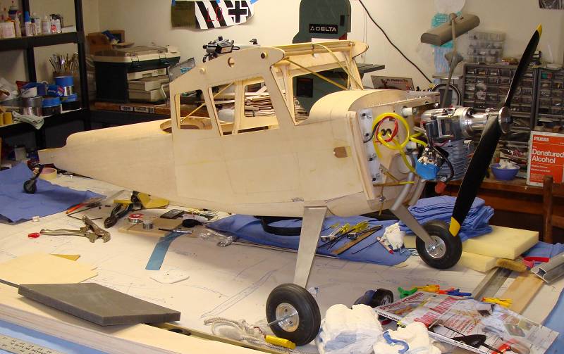

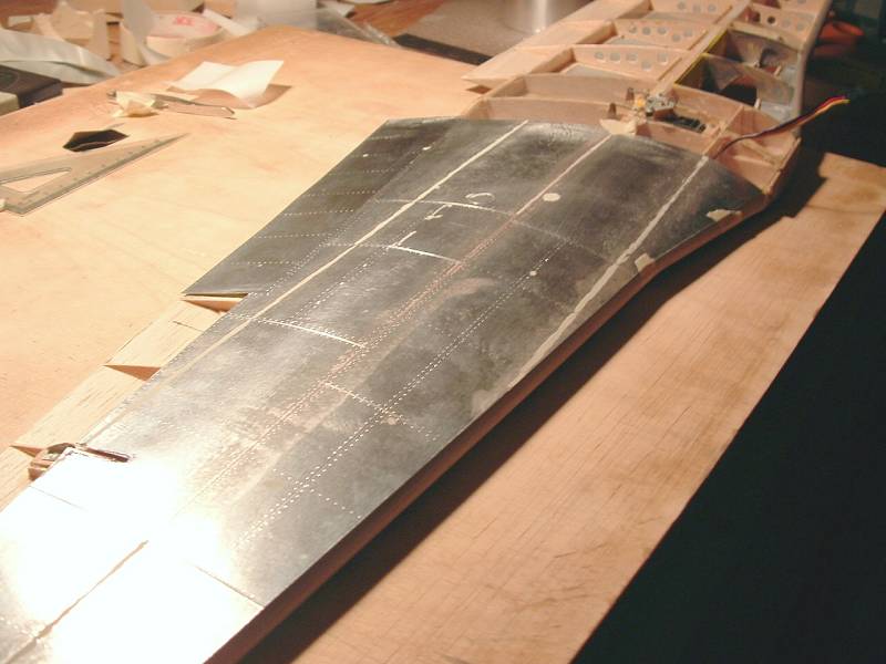

Since this thread started (and the most recent post up to yours was back in Jan), I have arrived at about the 1/3 point in my construction of the Vaillancourt 1/4 scale 'Dawg. I have a build thread in the Warbirds and Warplanes forum, check it out. (25% Cessna L-19/0-1 BirdDog build) There are several builders contributing and some great info. Although I haven't done anything in a month and a half, I am at the point where all structures (fuse, tail, wings, and control surfaces) are built and skinned and initial fitting has been done, servos mounted and controls routed. Engine (G-45 Zenoah) is mounted and many details have been roughed in. I haven't started the interior details yet, but all electronics have a "home" in the fuse.
Some of the scale deviations have been addressed. All the wing control linkages are concealed, but I can achieve the full 60 degree flap deflection of the fullscale, whereas the plans only allow for 45. The inner end of the flaps is correct to the full scale, which required alteration of a couple of fuse formers which also made the fuselage true to the fullscale's. The one scale deviation I can't correct is the H stab incidence, which is modified "so the model will fly.....period" to put it in Roy Vaillancourt's own words.
Some of the details I have included is all nav lights, including the tail strobe and Mars beacon, operating landing lights, which operate from a micro switch when the flaps begin to deploy.
The one thing I still can't figure out is how to build this plane and achieve a weight anywhere near the one that madmax purports is possible. Sure, I could build it like the Gossamer Albatros and use lighter material with tensile strengths thousands of time greater than balsa, but I want to be able to pick it up without putting my fingers through the skin, and would rather not have to take out a mortgage to afford the materials. Right now, my projected weight is in the 25-27 pound range, which I hear from owners of this model is typical, and the performance at this weight with this engine is very good. I am still looking at alternatives to the aluminum LG, even some spring steel alloy, which could be much thinner than the aluminum, but stronger and only minimally heavier, if at all.

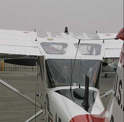

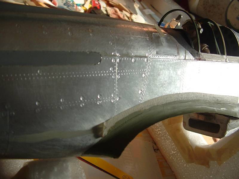

I've got about 15 pics of this area alone, from several angles, and have rivet detail of the entire skin, top to bottom, front to rear. It is different in places from variant to variant, depending on whether it is the "standard" or "heavyweight" airframe. The narrowed rear window is one of the details I immediately addressed when I started building, as it is probably the most glaring departure from the true scale lines.
It may not have shown in any of my pics, but I did lighten the ribs prior to skinning the wings, by the method you describe. I still build for crashworthiness, as my building skills remain better than my flying ones, and I hate repairs, and want to keep my 'Dawg flying as long as possible. There's always the accumulation of hangar rash and transport dings, and edges seem to be what takes the greatest amount of hits. Traditional methods are what I know best, so I'll stick with them for the most part, they've worked well for a long time.
