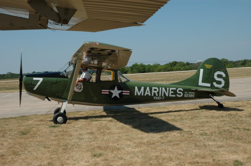

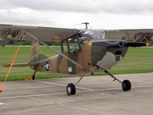

I have about 150 detail photos of two extremely nice, recent restorations of L-19/0-1's, and I also have Minard Thompson's most excellent resource book, "The Lovable One-Niner" which has about 99.5% of everything you need in order to build a master scale model of this aircraft. After comparing the pictures and plans to the drawings and info in the book, I can't find anything so out of scale that a bit of the normal desire that a builder has to change things can't fix. There is a very nice version of the Vailly 'Dog in this month's MAN. Not enough pics of it to suit me, I'd like to see a complete article on just that plane.

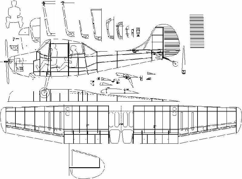

Exterior: If you scan a good side view photo (full scale) and scan in Vailly's plans you'll see the tail isn't high enough relative to the main cabin and it's too thick throughout the fuselage cross sections. The Vailly flaps don't have the right angle at the fuse and there's too much wing dihedral. If you look at the fuselage where it transitions from the aft spar pickup bulkhead to the main tail cone, nobody's hit it right. They're not straight lines on the full scale Birddog so straight longerons aren't going to give you the true contours.
Interior: As previously mentioned, the fuse longerons are incorrectly placed and the cockpit kit can't hide that fact.
Okay, I'm picky but to be truly scale, an aircraft should look right from every angle, inside and out. Vailly's is nice but one couldn't take a photo of the best rendition and pass it off as the real deal because it's not "right". The best efforts of a scale modeler are for naught if the basic airframe doesn't have the correct lines and contours.
I pulled out my plans (Vailly) and compared the cross-sectional data in the book I have, plus compared with the view you posted, plus compared with the many photos I have and what's in the book. There does seem to be a difference, but nothing that can't be reworked if one really wanted. The straight longerons in the plans I'm sure are just considerations to structural integrity. After all, this is stick-and-glue, not aluminum-and rivet/weld. I can't find a specific dihedral angle given on the plans, although the plans are incorrect where they state the dihedral starts (a rib about 1/4 span out from the root). The full scale's dihedral starts at the wing root. I can't imagine dihedral being more than the full-scale, it's got a ton (2-1/2 degrees in the BirdDog book, 3 degrees in some Cessna references). Considerably more than most GA high wing planes. Mine will be honest to the full-scale, though, and I plan on some mods to the fuse anyway, so bringing the cross sections into line will naturally follow. Most of the models of the L-19 I've seen, including the Stafford kit, and probably all the ARF's, are built with too little dihedral.
The short blurb about the L-19 in this month's MAN mentioned that the builder had to relocate a former in order to make the scale door work correctly, so there are other differences as well as the longerons. I, too, like scale fidelity, but some considerations have to be made by the engineers/designers of these model plans to make them buildable by the majority of modellers. It's up to the true purist to change what they don't like, or just design their own.

You're starting to see the light. You can't make a silk purse from a sow's ear...it's easier to start with the right basic airframe to begin with. Some of the other items you'll have to change to bring the Vailly Birddog up to snuff are the landing gear. They look like football players legs on a ballerina. The Birddog has very elegant, slim legs, thank you. And the cowl...it ain't right. Your photos will tell you that. The full scale cowl only has a nose bowl. That's because the rest of the cowl is flat sheet, bent to shape. It's not like a 150 or 172 cowling at all.
And then there's the weight...unless you change you basic thought process from boatbuilding to airplane making...you'll always be building something that's heavy like a boat. In my book, 27 lbs. for a 8' wingspan aircraft is way over the limit for scale flying of this particular aircraft. As an officianado, (Which I appreciate you for), you know the Birddog is nothing short of spectacular in a high performance, STOL takeoff or landing. That's because it's a stressed skin airplane that weighs far less than any other Cessna with little cross section drag and lots of wing/power.
Why not build a truly, stressed skinned aircraft that's got similar weight/wing/power/drag ratios. My 5th scale Birddog will weigh in around 8 lbs. finished. 1/4 scale should come in around 12-15 lbs. Yeah! put a 120 nitro or 26cc gasser in the 1/5th scale and a 35-42cc gasser in the 1/4 scale for almost vertical performance. (Geee, like the "real" one!)
For stand-off scale, Vailly's and Ikon N'west are okay. (Ikon's are even worse when it comes to flying weight...kind of like old Nosen kits...glue all the blocks together and carve off what you don't want.) Marutaka's got a great kit but...it's stand-off scale, not a Master Modeler's foundation.
As I said, I consider you a comrade because we share a love for this airplane and I'm trying to help other modelers move into the next generation of truly scale airplanes that aren't like the loveable F-4's...rocks with big motors that CAN and DO fly.
I'll be doing a construction article for MAN so you'll see the proof of the pudding in progress.

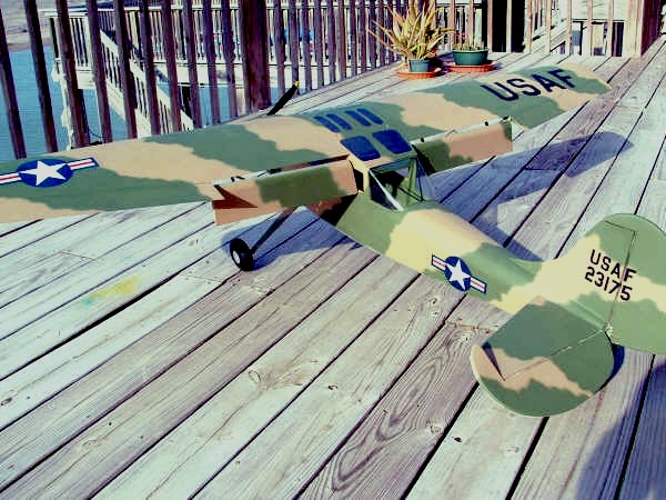

Thought I'd attach some pics of JSM Birddog finished.

Max-- That's a very nice lookin' 'Dog. I like the camo scheme, the one thing I hated about most of the scale paint jobs is how blah they are, dirty ol' O.D., or the AF gray. I'm not sure how I want to do mine yet. I want it to be historically accurate, and competing dictates doing a specific bird, but on a couple of other scale builds I did, I incorporated features of several different planes, sort of made the model representative of the type, rather than a specific plane. I don't think I'm all that interested in scale competition, but a couple of my flying buddies want me to at least try fun scale, or even try the beginner level, whatever it's called, at Mint Julep one year. It sure won't be done by the next one, though.
I have pictures of a couple of L-19's in a sort of tiger stripe camo, they look pretty cool. Camo patterns were not very common, and were unofficial. USAF tried a camo pattern for a very short while, but abandoned it because the fast-movers couldn't see the FAC down in the treetops. They painted a bright orange stripe from wingtip to wingtip on top of the wing,and one on the top of the fuse behind the cabin. It didn't help, and the camo was eventually abandoned altogether. I still like it though, and ought to make it easier to see (the model, that is)

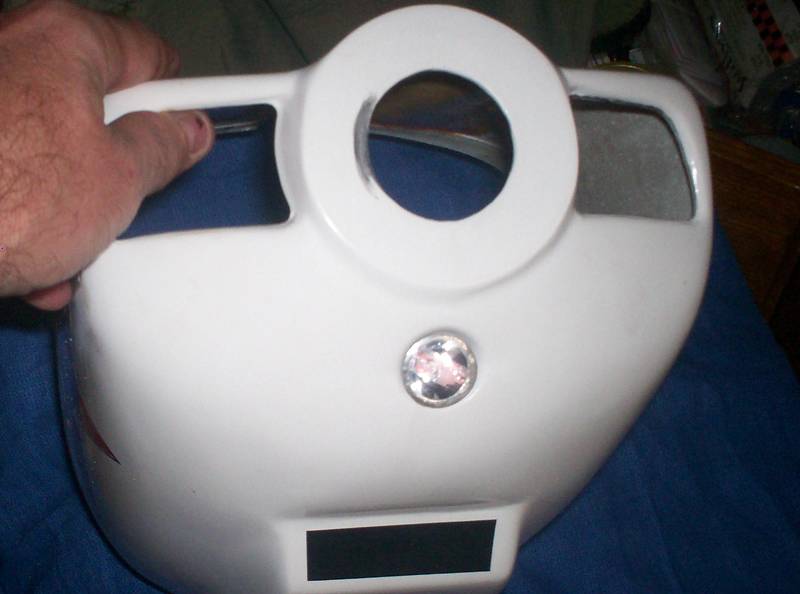

OK you scale buffs, need some help here. The leading edge of the stabilizer, fin, and rudder have, full scale, has some sort of aluminum wrap around it and extending several inches toward the center of the flying surface. How would you simulate this on a 1/4 scale Vailley Birddog. Mine is ready for primer, wish I had seen this thread soon enough to help myself with a truer scale model. Hey guys please help with my problem? Thanks. Chic
My Feedback: (70)
Joined: Oct 2004
Posts: 98
From: Port Isabel,
TX
Hey,
Glad to see you're making the effort! "If you're going to do it, do it right, do your best!"
Preparation: The fin's leading edge at the dorsal is actually sharp up to where it meets the forward spar of the fin. From there up, it's rounded. Shape your leading edges accordingly. The outboard leading edges of the stab are round.
One could hammer a piece of aluminum to the shapes or use plastic. I've done both but for the uninitiated to metalsmithing, plastic's the easiest. Tape a piece of .010" ABS over the plan and draw a side view outline of the leading edge allowing a couple of inches past your desired part. You're going to be stretching the material from this direction so allow lots of gripping room. Determine where the material would come back to and draw a line there. Cut out the aft edge of your piece and tape it on the aircraft. Once you're happy with it, cut two just like this with scissors. (Bigger the Better) DO NOT cut the leading edge, yet.
Tape the piece along the aft edges and run a bead of Super Glue along that edge removing the tape as you go. Don't try to bend it over to the leading edge at this point. Now take out your heat gun and experiment on some of the excess to determine how much heat's enough.
You're working a compound curve wherein the material has to change shape and the more area of the material you heat, the more uniformly it will change shape. Apply the heat and, pulling you'll be able to get it to conform to the shape, to a point and it may be half-way, it may be less, but you're going to fill the difference with spot putty. Inside curves require shrinkage, outside curves require stretching. Plastic when heated naturally shrinks so you just need guide it. Once you've got it formed as far as possible take a very sharp exacto and carefully trim off the excess at the centerline of the leading edge or thereabouts. Be careful on this cut as it's a dangerous one...better way to cut this is with a Dremel tool. Tape it on the leading edge and wick Superglue into the joint.
Now turn the part over and glue the other side. Fill the very leading edge, 400 grit sand and you've got a leading edge that's as good as it gets.

Max - Thanks for the photos; What covering did you use on yours? It looks like probably coverite or solartex. And did you use latex paint for the camo design? Also, thanks for the CG info. I'll definitely try to get as much weight toward the front, as I am leaning toward using a Saito FA-72 in mine.

Attached is my doc. pics for the JSM Birddog. It's flying today so, obviously, documentation score: "10".
This Birddog was never destined for scale competition...it's just an exercise in finishing so I took the liberty of leaving off the orange. It looks so much better without the "SEE ME" orange.

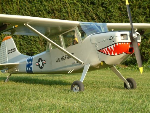

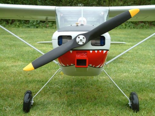

Just reading the posts on the L19 and in particular the weight of the 1/4 scale one. I have the Vailly 1/4 scale Bird Dog and its weight came out at exactly 25 lbs.
I regard myself as a very light builder, but I just don't see where I could have saved 10lb ! .However the 'Dog , at this weight, is a great flying plane. A 15 lb, 1/4 scale, Bird Dog would be such a handfull in anything more than a very slight breeze due to it's very low wing loading. Don't know about you guys but all we seem to get here in the UK is wind, wind and more wind.
Most designers sacrifice true scale for everyday ease of assembly and flyability. But I will be following this with interest.
Good luck
Good luck

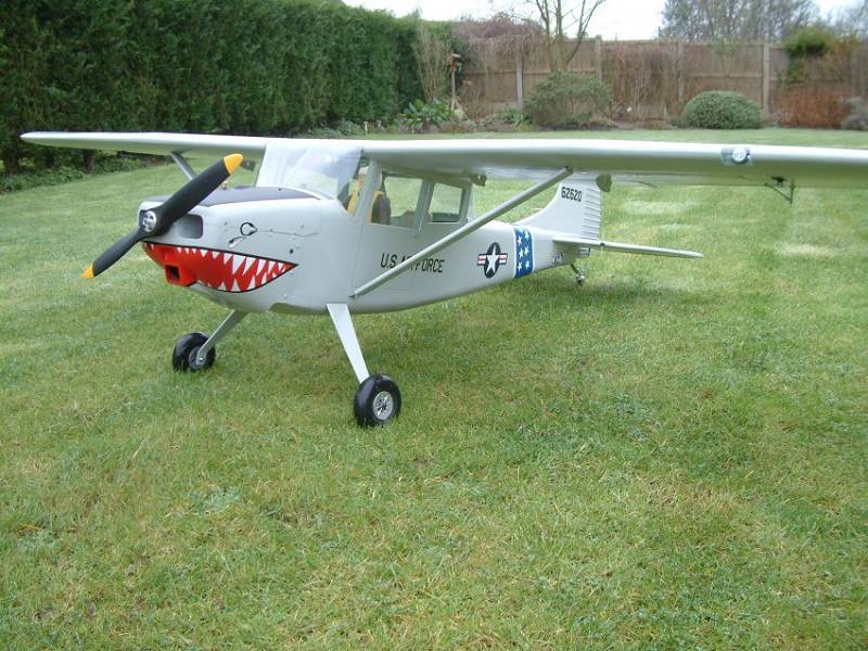

In answer to a few questions.
It's powered by a Roto 50 Twin gas engine
Weight is 25 lbs exactly.
It was finished in glass cloth and epoxy resin
Painted using cellulose paint mixed by my local car body repair centre.
Uses J.R. pcm radio with a mix of HiTec and Futaba digital servos.
The only modifications I made to the plan was to put the 2 elevator servos at the back, under the tail, rather than use push rods.
And I installed a working landing light in the wing leading edge.
Marcol--I'm such an idiot. I totally forgot you had posted these pics before, and I commented that I thought it looked like a Roto engine. Damn nice BirdDog, The "toothy grin" is a great touch. One of the planes I'm thinking of modeling has something similar.
The working landing light is another detail I'll build in. What did you use? While I was poring over the plans, I happened to think that the size of the lights looked close to the reflector of a AA size Mini Maglight flashlight. So..... I took one apart, and guess what? It is such a perfect fit you'd think it was made special for the plane. I also used one for the landing light on my Super Decathlon's cowl (goes just under the prop hub). It was one of the few salvageable pieces left of the cowl when I tried to take the shortcut to China
Notice that the BidDog pic is a mirror image (reversed) print. The landing light is on the wrong wing
