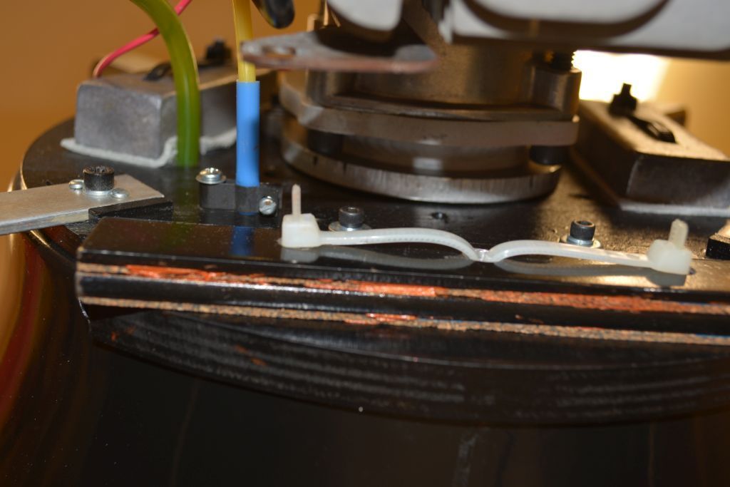

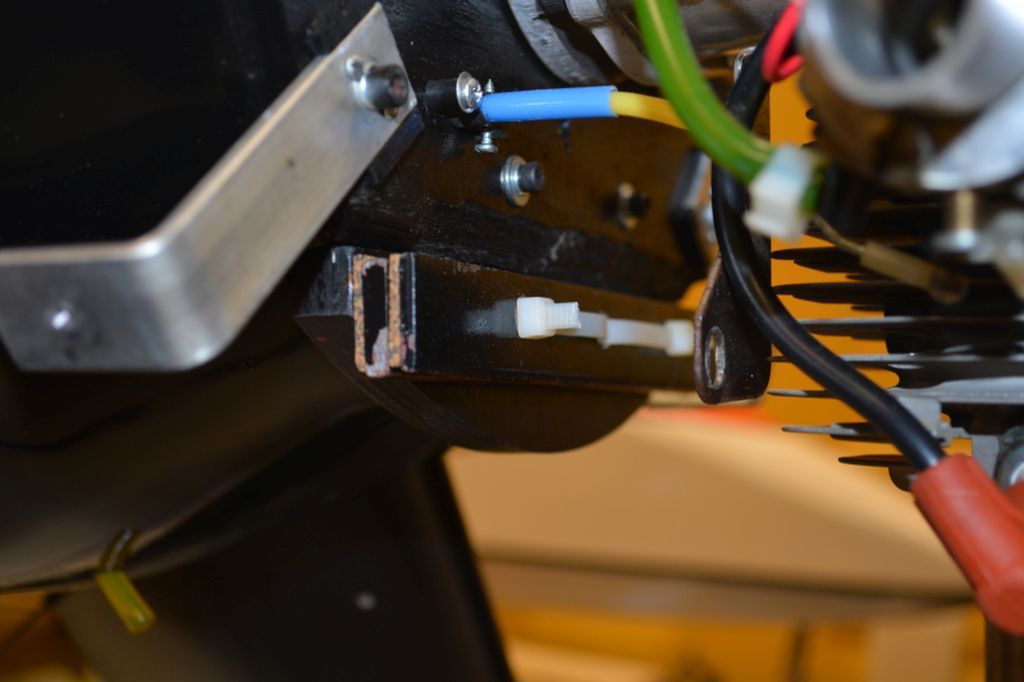

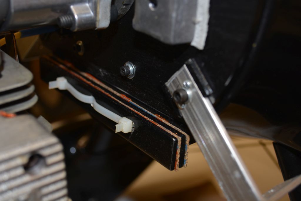

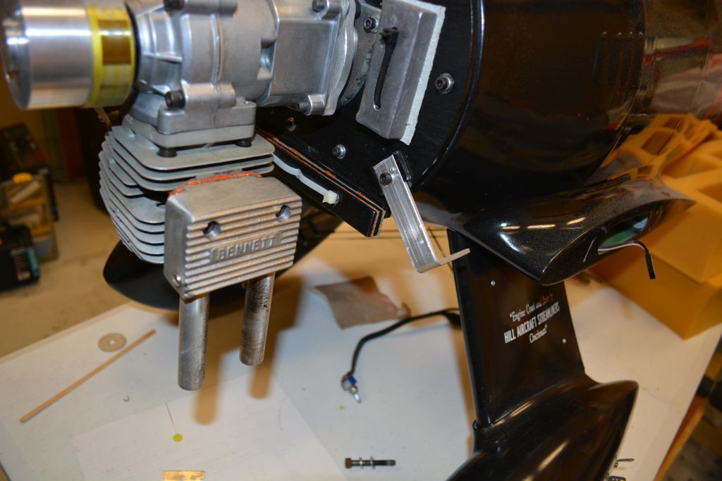

It's been awhile and I hope all had a good Thanksgiving. I got a PM today asking about the WWR as Space Cowboy just scored a NIB kit. Everything is here but I wanted to update. I found that the G62 was not giving me the performance I desired. I have G62's on two other aircraft and they scream. Both of those have Bennett Mufflers on them. So last year I did a test comparing rpm's with the Pitts and the Bennett using Xoar 22x10 and 23x8 props. I found the Bennett gave over 400rpm's better top end than the Pitts and the 22x10 was the better prop.
I fabricated a hatch to cover the part of the firewall removed for the Pitts muffler (post #106). I weighed the mufflers and added weight to the hatch to make up the difference for the lighter Bennett muffler. Will post some photo's tomorrow.
Pete

Here are the photo's of closing off the firewall opening where the Pitts muffler was located. I fabricated a hatch out of aircraft ply that has a tongue that extended up behind the firewall. two blind nuts were used so the hex head bolts could secure it. the hatch had to cover the cut away fiberglass. This also eliminated the pressurization of the fuselage that occurred in flight. I added an appropriate amount of weight to compensate for the lighter muffler. There is a layer of gasket material between the layers with some RTV silicone to keep it stable. With the cowl on this area and hatch is still accessible.
