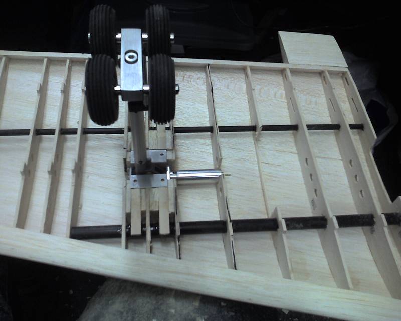

I did manage to get the retracts set in to place.
The first photo shows where I decided to cut in to the ribs and the second shows the retracts set in to place.
I still need to box it in and create a retract mount that grabs hold of the carbon fiber wing spars.

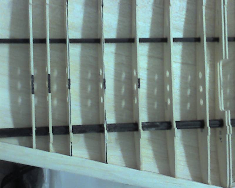

I didn't get too far tonight, but I did get the main retract fitted in to the left wing.
I wasn't sure how to secure the retracts, but it seems to me that the strongest structure in the wing are the carbon fiber wing spars.
I used 3/8" basswood to make a a couple of pieces similar in shape to center of the rib. I then made spacers of very light balsa and put them between the ribs and retract mount pieces. I epoxied the basswood pieces to the spars and used CA on the spacers. I think this is the only epoxy in the plane so far.
It didn't come out all that pretty, but it is very solid and should withstand a rough landing. It took quite a while to get it all fit in place. I still have to box in the rib area where I cut out for the oleo strut and wheels.
These are Century Jet retracts. In order to fit them in this slender wing, I had to rotate the retract cylinder 180 degrees. That means that one of the air fittings is between the cylinder and the retracted oleo strut. The nylon right angle air fitting was .4" tall. I only have .3" of space when the gear is retracted. Does anyone know where I can get a low profile right angle air fitting? I sent an email to Century Jet but they haven't answered back yet.

What you have done is tie the supports for the retracts to the spars but there is no structure, besides the wing skin, between the blocks at the front & the back. Any twisting motion by the retract will be carried by the wing skin.
Whilst the wing is open I'd suggest some extra good quality 1/8 ply ribs from the front to rear spars glued to the existing ribs to bridge the gap. Of course the inboard rib will need a slot for the leg & cylinder. With the rigid legs the retract mounts will take a real pounding. - John.

At first I was going to defend the way I mounted the main gear. There are 2 carbon fiber wing spars that that are the backbone for support. I created 1/2" basswood 'short ribs' to screw the retract mount to. I added balsa spacers to put between short ribs and the remaining portion of the wing ribs. I used epoxy and CA on each side of the retract mount blocks to make it solid. All of the wing ribs and the basswood short ribs are adhered to the wing spars. It all seemed very solid and I thought that I had done an alright job on it. So I decided to think about your comments before responding.
I still believe that I have created 2 solid pieces for mounting the main gear retracts, but I think you have a right about twisting. The pressure of a hard landing would cause the short ribs to try and twist the carbon fiber tubes. I doubt that the tubes would break, but I think it would cause them to break loose due to the twisting. If a mount breaks away from the wing spar there would be very little support and it could punch through the wing skin.
So I thank you for your feedback and I will add the plywood support as you suggest. This is my first design and my first scratch build so I will take help whenever it comes along.
Thanks again and feel free to add your constructive criticism. As you mention, it is best to make corrections while the wing is still open.

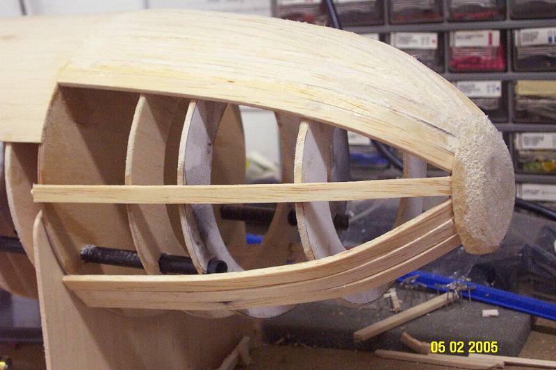

I promised to post some photos of the fuse build when I found them and I just found them. Most of the jpg photo files that I have are too large to post here. I will add them to a download file and provide a link for downloading. Perhaps I can figure out a way to reduce the file size so I can post more photos here. For now I have found 2 photos that are small enough to post here.
I have long days on the job this week so I didn't get much done. A little bit of work on the retracts, and I have a new plan for the wing mount.
Anyways, here are the 2 photos.....

They are certainly big beasts. It's interesting to see an alternative method of construction to the one I chose. It's looking good! - John.

Your B-36 looks good. I can only hope that mine will look as good.
I'm not sure about the alternate method of construction. My goal was to keep it light, because it is very large, it would be easy to get some weight. The fuse weighs exactly 3.0 pounds in the previously posted photo of me holding it. I believe that is an acceptable weight. I think the wing with retracts is currently between 3 - 4 pounds. I am using very light balsa whenever possible. Any thoughts? Is this light or not so light?
I will post a link to the fuse build photos later tonight. You will see more of my alternate method of building in those photos. Ignore the part of the photos that show a messy shop when I am building.
In an earlier post I showed the cad image of the tail section. There are photos showing the tail built prior to applying the skin that will be in the zip file tonight. I would send the photos now, but I am not at home.

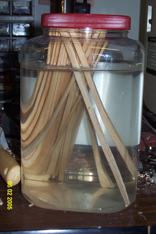

Here a link to the photos that I took while building fuse: http://rapidshare.com/files/95619462...hotos.zip.html
There is a button at the bottom of the page to download it for free.
It will ask you to type in the 4 letter code that is displayed. That stops automated downloads from overwhelming their site. The download will start about 2 minutes later... watch the timer.
I put the zip file together rather quickly. I just took a look and there are a couple of photos of a car part in the zip file. Ignore them. There are also a couple of photos of my first attempt to build the wing that didn't turn out. Soon I will start to organize the photos and add some descriptions.
For those who don't want to download the zip file of photos, I will show one here of how I did the fuselage nose. Originally this was going to be a XB-36 which has a different nose.

I found some of the photos of building the B-36 fuse. I will place a few posts with a couple of photos in each.
The first photo shows the fuselage framed up but not yet sheeted. You can see carbon fiber tubing used for fuse spars. The 2 spars on the bottom run the full length of the fuse. The top spar runs from the nose to wing saddle. Behind the wing saddle I switched to a pair or balsa spars that will straddle the leading edge of the fin.
In the second photo you can see that it was not possible to have the carbon fiber fuse spars support the 2 front fuse formers. My solution was to incorporate 4 notches in the 5 front fuse spars, and place 1/8 x 1/4 inch balsa sticks in the notches to hold it all in place until I could sheet the nose. You can see that one of the fuse formers does not have an opening in the center to lighten it up. This is a plywood former that will be used to support the front retracts. You can see that it is tied in to all 3 carbon fiber tubes. I have also built a temporary support that holds all 3 fuse spars during building so that this long cigar shaped fuse comes out straight.
That's it for this post. Mike

Here is the nose a bit further along. I used a Master Airscrew balsa stripper to make the strips and then soak them in a container of water for a few hours. They wouldn't break when bent and CA worked just fine.
