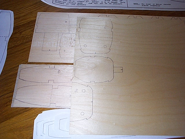

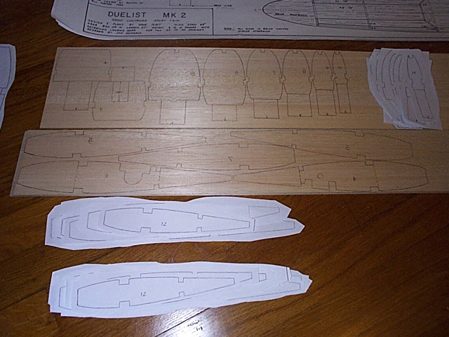

I usually start by making paper templates up of the parts to glue to the wood and then cut each piece out by hand. It takes a lot of time but I enjoy it. I like to have all the parts cut before starting to build Occasionally I find a part I want to modify so I will cut one orginal and one modified in case my idea is all wet.
Mike
Mike

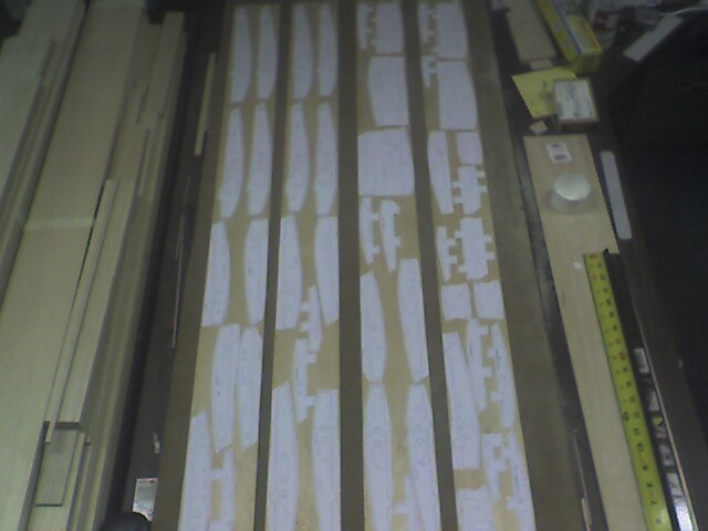

I have done the samething using laquer thinner instead of alcohol, but I still perfer using rubber cement to attach the paper templates. I do my cutting in multiple locations and I never have to worry about rubbing the lines off or being too light to see. Also I found I find I make few mistakes in the final sanding by having the paper glued on the piece. The templates are easy to remove and occasionally will release themselves after they have set awhile. I do cut the wing ribs in pairs so I only need one template per set.
Mike

Mike and Mike,
I was the one who mentioned transferring a photocopied image directly to wood using lacquer thinner. I go into more detail in my Duelist thread. Here's the link if interested:[link]http://www.rcuniverse.com/forum/m_7165436/tm.htm[/link]
Regards, Mike

Mike, Mike, Mike, .... Hmmmm
Anyways, great photos! First, I see that you place them REALLY close together. You probably get more parts per sheet, but my extra spacing allows me to stray a bit. My scroll saw sometimes takes an unexpected turn. For me, the wood is cheap and disk sander takes off excess wood very quickly.
I hadn't used rubber cement with my paper templates, I used photo adhesive. This adhesive made it easy to remove the paper templates if you get to them in an hour or two but if you wait a few days it can be rather difficult to get the paper off. I also noticed that if I sprayed the photo adhesive on both the balsa sheet and the paper, the paper would shrink. I recreated my ribs a second time and sprayed only on the balsa sheet.
I will take this opportunity to comment about a scroll saw blade that I just came across. It appears to be a blank scroll saw blade with no teeth that has had very durable sanding particles adhered to it. I purchased a set last weekend at Menards and they work rather slick to sand the inside edges of very small areas. For example it would work well on the notches that I saw in the parts shown in your photos. I just thought that I would mention it.
Mike

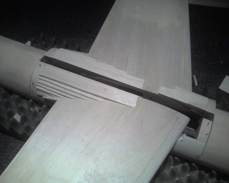

Next I started to build up the wing mount. Excuse the obvious, but I need to build up the area above the trailing edge of the wing, above the leading edge of the wing, below the trailing edge of the wing, and below the leading edge of the wing. Below the wing was not accessible so obviously I started on the top side. I decided to start on the trailing edge. In the design I had these areas hollow, with formers and a sheeted skin. It looked good in CAD but now that I need to build this area I just don't think that it will be strong enough. Some of you may think it is a bad idea but I decided to build these areas up as solid (very light) balsa. If needed, I can hollow it out later and skin over the hollow area.
Here are a set of photos that show the progress of building up the wing mount area above the trailing edge of the wing. This is where I am at now. It took about an hour to build this area up. I will move on to the leading edge area next. I will add posts as I get these areas built up.
I will update the build doc file once I get the wing mount area completed.
That's it for now.
Mike Roerig
[email protected]

Here are some photos of the front area of the wing mount filled in.
In the first photo I have one wing halve extended and you can see the carbon fiber wing joiners.
I will show the photos in 2 posts.
Here are the first set.
Mike Roerig
[email protected]
Mike Roerig
[email protected]

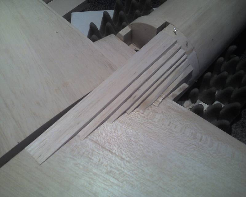

I have the top side of the wing mount area built up for the second wing half.
Here are a few photos showing it progressing.
Mike Roerig
[email protected]
Mike Roerig
[email protected]

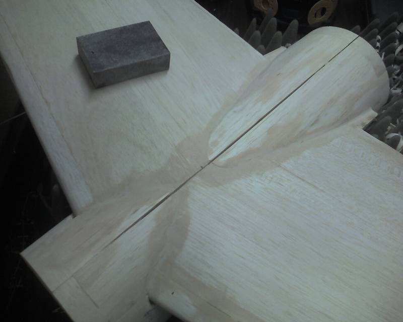

It's been a busy week so I haven't had much building time.
I did get a few minutes to start shaping the blocks of balsa in the wing mount area. I only have one photo to post for now, but I do hope to finish this up over the weekend and post additional photos.
It only took a few minutes to carve off enough balsa to start getting a round shape. Sanding it to the final shape may take longer than I had hoped. I will let you know.
I did manage to figure out how I am going to secure the wing to the fuselage with a short pieces of carbon fiber tubing. I will provide an update when I finish that up.
Mike Roerig
[email protected]

Here is a photo showing the wing mount area carved and sanded reasonably close to where they should be.

Mike I think you made the right decision on changing the wing mounting to this system. The old designed looked good on paper but I wasn't sure it was going to work out because of the complexity. You said you were at 5 lbs. 8 ozs, refresh our memories and confirm what motor, esc, and battery combination you were planing to use. You might check into Flight power for your batteries I have recently purchased their batteries and the cells are well matched and the price is very reasonable. My local shop is carrying them now.

There is a bit of humor (for me) in your question.
There are a couple of obvious questions that no one has asked and I was kind of waiting to see when someone would.
You are right. If you looked at the original design for the wing mount, it did look good on paper but when I was designing this plane, the plane didn't exist. Once I actually had a fuse and a wing built, I realized just how big this plane is and so I rethought the wing mount.
Once had the plane and wing in front of me I began to consider that 'the fuselage hangs from the wing' and I thought of it less that 'the fuse is holding up the wing'. It seems trivial, but if you take a moment to think it through it changes the requirements of the wing mount area.
On this plane:
- Both of the main gear will transfer their stress to the wing and much less to the fuselage.
- Although it hasn't been discussed, the LiPo batteries will be secured to the bottom side of the wing. They will not be attached to the fuse, so the stress of the battery weight will not be transferred through the wing mount
- My goal is to secure the radio, radio battery, air tank, and anything else to the underside of the wing
I should have the remainder of the wing mount done in a day or two so I will post photos then, and you can add your comments when you have photos to look at.
Your question about motors is one that I thought would have been asked early on.
I plan to use six of the E-Flite park 480 OutRunner 910 motors, with six ESCs (haven't chosen yet) and six Thunder Power Pro Lite 2100mah 11.1v battery packs. The batteries will be the last item purchased to I am open to suggestions. I haven't had LiPo's before so I want a battery pack and charger combination that work well together. Also, I have purchased Master Airscrew 9 x 7 three bladed pusher props.
I bought MotoCalc 8 and I am confident that I entered all of the info correctly, except that I may not be entering the cells correctly. Everything was rather straightforward to enter and select, except when it came to entering the cells. I used the wiring wizard to select 6 batts, 6 esc, 6 motors. But when I enter the cells, do I enter 3S6P (for 6 packs) or do I enter 3SP1 (for EACH pack)?
I don't recall my final selection, but if I did it right, it shows a 21mph stall speed and up to a 20 minute flight depending where you want to place the throttle. I would welcome assistance with this!
Here are my MotoCalc selections:
Eflite Park 480 OutRunner 910KV motors (brushless)
Thunder Power TP1320 cells
Prop Diam 9" Pitch 7 Blades 3
Parallel motors 6
ESC Castle Creations Phoenix 35
Wing span 114"
Wing area 1254 sq in
Empty weight (does not include motors or cells) 128 ounces
Airfoil: Clark Y
Fuse cross section: Circular
Surface finish: smooth
Landing gear: none or retractable
Protrusions: None
Well, hopefully that answers your questions. Let me know your thoughts on the MotoCalc entries, the motor, esd, and battery selections. I think that my 128 ounce empty weight is still attainable. Time will tell.
