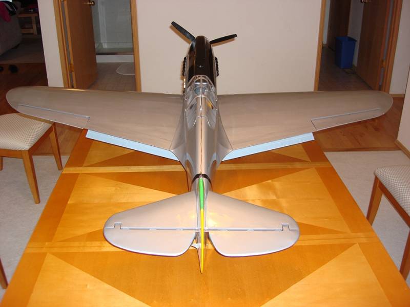

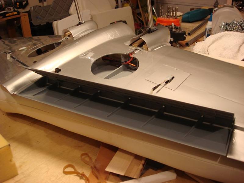

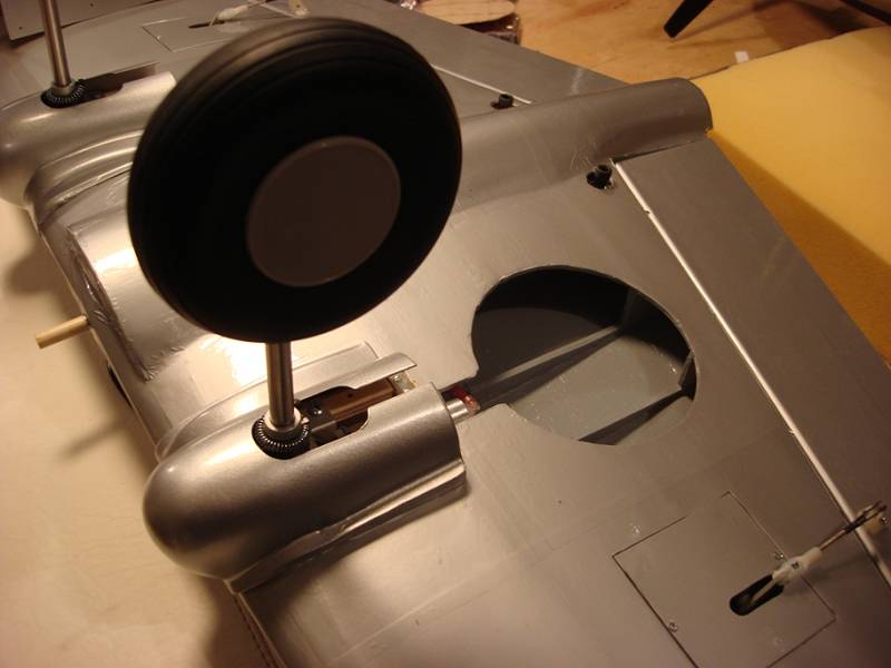

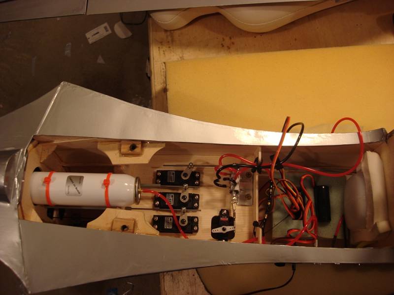

Just wanted to post some pics of the completed P40 I started in 2004.
Yes, after 4 years struggling with limited budget, is finally ready.
Comments will be appreciated as I have lots to learn. This is the first kit I built.
Kit: TopFlite P40 warhawk gold edition 64" wingspan
Engine: OS91 4 stroke
Retracts: Century jet P40 retract
Final weight: 11 lb 4oz
Prop: Master Airscrew 14x7 3-Blade
Finish: monokote

Nice job. First kit or first r/c airplane? In any case get someone else to maiden it for you. I can tell you have a lot invested financially and emotionally, both of which make for overly nervous first flights.

Great job! It looks awsome. The weight seems high to me, but I fly them electric. My P40 was 8 lbs and fly very fast. It did not like to slow down much on landings or it would tip stall hard.

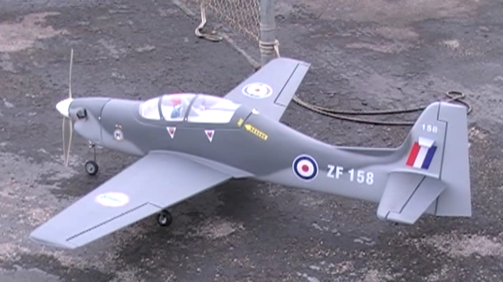

This P40 was my first kit.
Here are the other planes I fly.
Nilo

I have a Tucano slightly larger than that one. All electric again and 10 lbs. Great plane!

My is about 65" wingspan, with a Saito100 on it.
Where you got your from?

Must be the same plane then, so is mine. Yours just looked smaller. I got mine from Nitromodels. It's very fast and jet-like. Turns a lot of heads at the field too.

Nilo's tucano is from Juniaer, Brazil made with fiber glass it's more heavy than your

Mine is fiberglass fuze and fully sheeted wings and weighs 10 lbs.

with the .91 you'll find it a bit marginal with the 14x7 3 blade.
You will want to go to a 14x6 or 14x7 2 blade.
I have the same airplane with the same engine in the same weight range.
Make sure you fly it on the wing, long take off roll and shallow climb out, let it build up speed. The P-40 will tend to be snappy at slow speeds.

Yes, the os 91fs likes a 2 blade 14x6.
