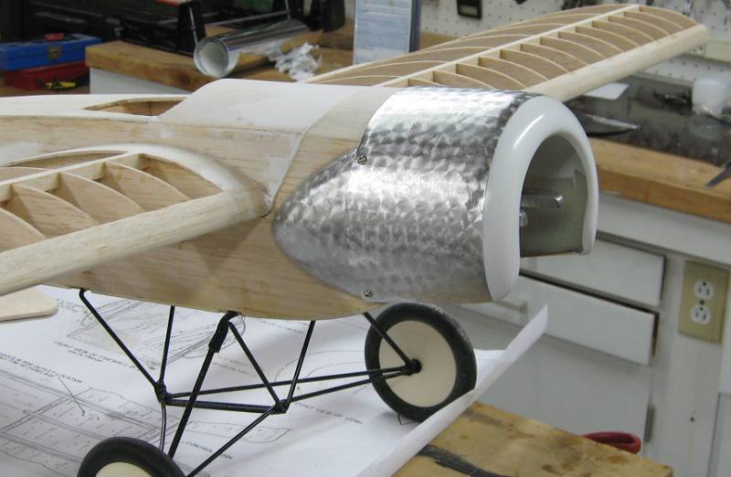

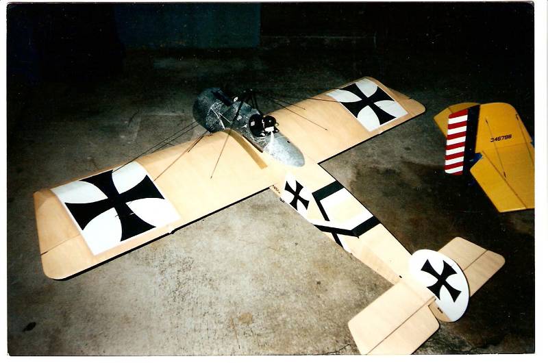

Bob, You need to check out the SR batteries web site. They have a step by step way to make the finish using aluminum boiler tape. Here's the way it really looked. Not really sworls.

Well I finally did it. I used the SR Battery method. It came out nice for a fun scale plane. I bought a Fiberglass Specialties cowl and SR's aluminum sheet tape. Thanks guys.
