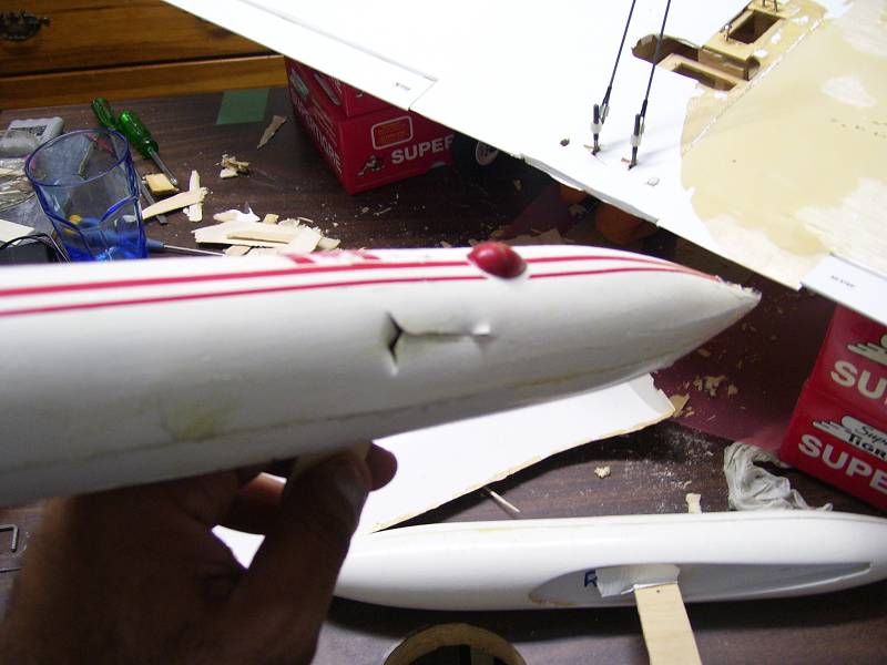

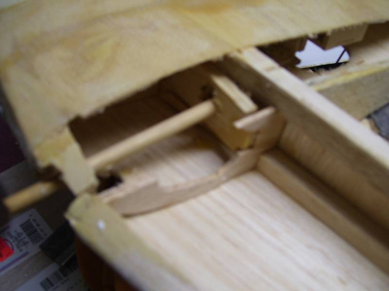

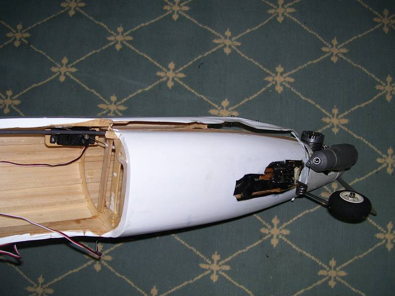

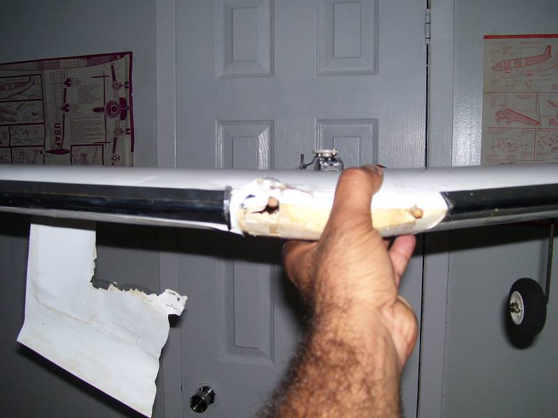

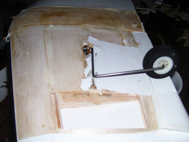

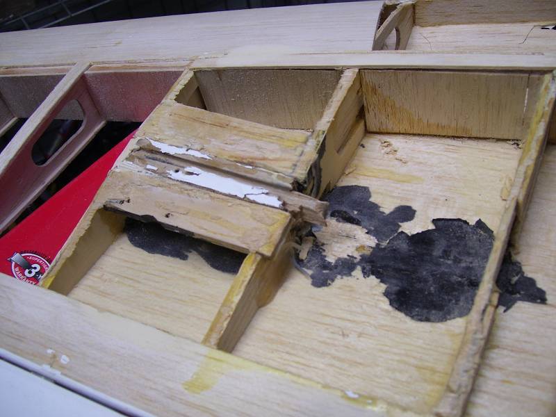

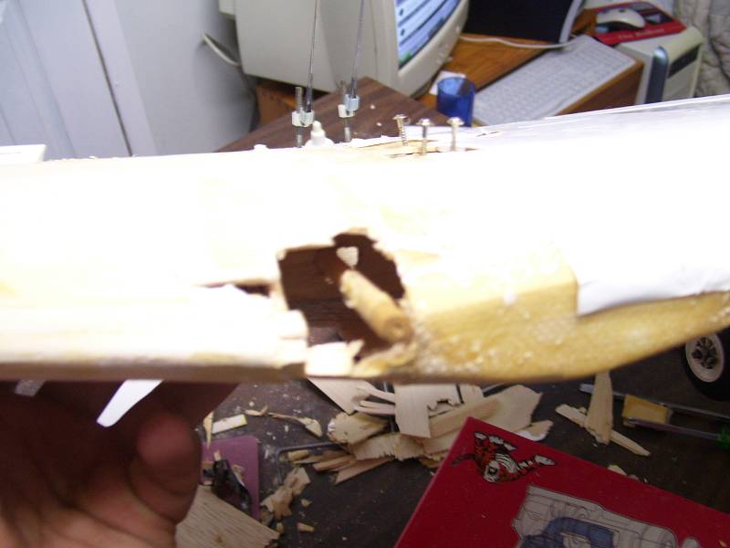

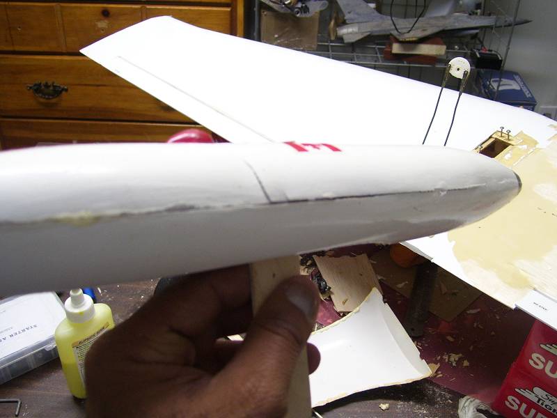

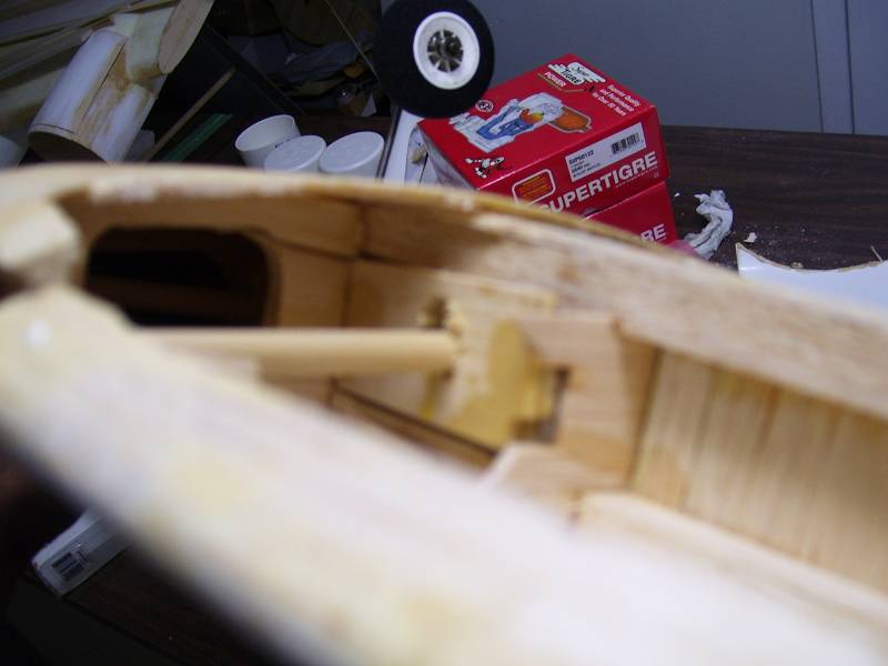

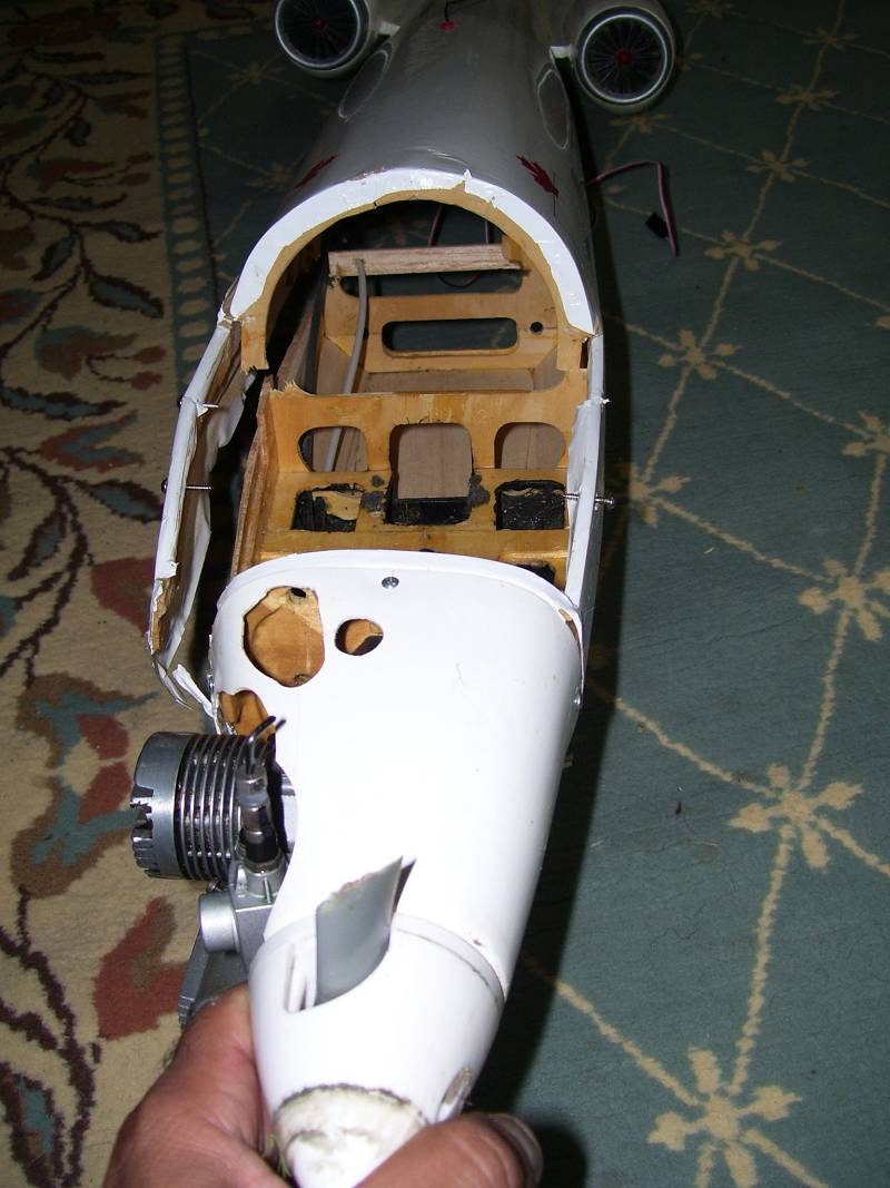

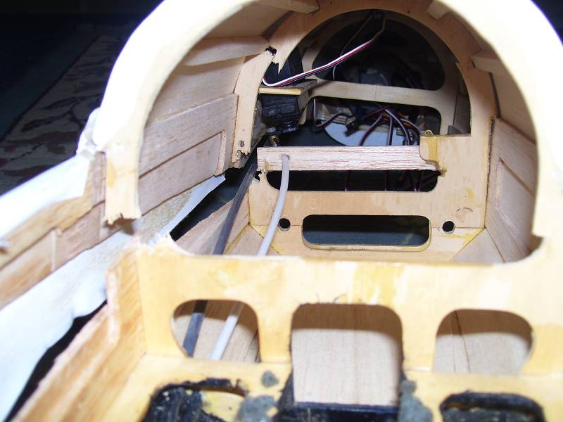

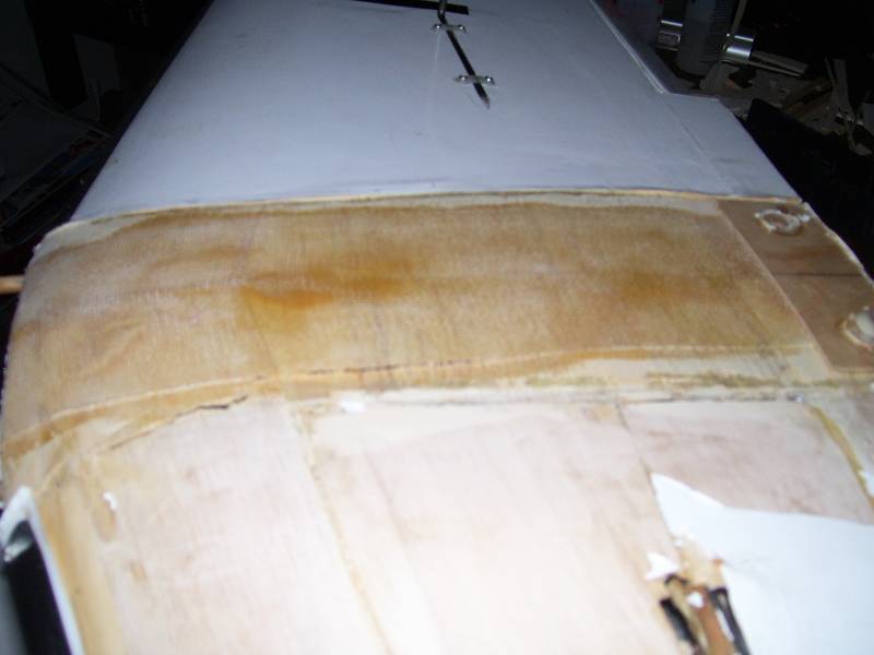

One of the fellow flier crashed my new Lear jet today. I didn't do CG check on it yet and told him repeatedly not to fly it but he thought it was ok and started to do long high speed runs across the runway. On one of the runs plane bounced off the runway as RT LG broke, stalled towards left, did 3 cart wheel rolls before coming to rest. Engine is OS 46 SF, prop was APC 10x8 but wasn't producing enough power to fly this model.
Weird thing about all this is, that he is very experienced model pilot, and have been flying at this flying field for over 10 years now, yet this all happened!!
Fuse is busted open from right side from firewall to back of wing saddle, formers are badly damaged, cowl is cracked, servo tray is damaged at back.
Wing sustained most damage as it got damaged from 3 areas, main lower right spar is damaged from wing root, right forward wing mounting dowel attachment on LE is broken off, root rib is cracked, another rib besides it is broken, rt LG block is broken, outer left tip tank is punctured from 2 spots, right tip tank is cracked open...
Now i need its plans and instruction manual from someone who wouldn't mind helping me out with rebuild of this bird. Let me know. Thanks

I've looked at your pictures, and it seems to me that you have plenty on hand with the wreckage to create any outlines necessary to make new parts from. I don't know how much rebuilding experience you have, but it's pretty normal to rebuild stuff by using the busted up pieces as templates. Hopefully, you haven't thrown anything away yet. Just a suggestion and good luck. Gary

I hear you, well the thing is that i have numerous rebuilds and ground up restorations under my belt, heck at time it seems that i have more of these then kits i put together..
In case of this Learjet, i really don't want to do patch job, i want to make sure i get right parts or plans to make right size parts specially ribs and the do the rebuild on it. This model is very special to me and that is why i'm bitter at the guy who did all this to it, trust me if it was any other model that i would have had many flights on , i wouldn't be like this with it. GPlanes replied that they do have some parts for it, yet i asked for die-cut ribs if those are also available, if they are then i won't mind getting all from them and it will justify paying high shipping for the parts and plans all together at that point. I'll wait on this rebuild..
