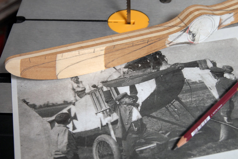

Very interesting! The one thing I haven't figured out how to do yet is to create the proper stepped forms to create the basic shape of the prop. I just end up laminating a large slab and then cutting away the extra. But this is not only wasteful of wood but, in terms of wooden propeller technology produces a weaker prop because the grain isn't ideally aligned (lengthwise) in each layer.
WWI era props used between 5 and 8 layers. In most cases slightly different woods were alternated for better strength but only rarely did that result in the strongely striated props we modelers love so. In fact, this seems to have been primarily a feature of German prop manufacturers.

Now I'm sure the diagram below contains all the information I'd need to create the stepped (pre-shaped) layers for this propeller but I can't for the life of me figure out how I'd go from these views to the shapes for each later.
Can anyone with better drafting skills (or a sharper mind for geometry) explain how I'd do this?

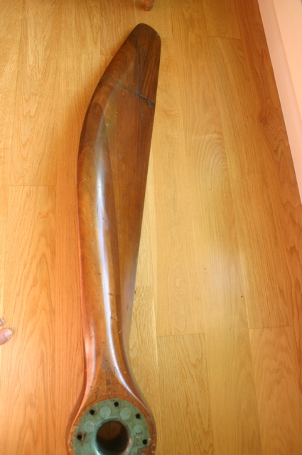

I just happen to have a full sized propeller from a Sopwith Camel laying on the floor next to my computer so I've grabbed a couple of shots to chew over.
A quick look at your diagram shows at the top, a side view of the prop, similar to the first picture.
You'll notice that the trailing edge is straight. Actually flat and the leading edge curves downwards along the whole length of the prop.
Next on the diagram is a top view, same as the second picture. Again see how the trailing edge is totally straight and flat against the floor.
The third picture, taken from a slight angle hopefully explains more.
What you have at the bottom of your diagram are sections through the props cord at the given points.
ie the small one on the left is the airfoil section at the tip cord an so on. Remembers these are sections through the prop viewed end on.
You'll notice that as you cut the prop the trailing edge remains flat as indicated in the diagram and the pictures.

David, thanks for posts, but I was actually looking for a different explanation. I've already tried my hand at carving wooden display props using a method similar to your drawings, i.e. laminate the wood, cut out an outline, cut down the profile, then carve in the curvature. I've posted a few pic of the results below (taken from the thread I linked to at the top of this discussion). I agree, by the way, that it's really quite easy and the shape emerges pretty naturally from the wood once you get your mind around the curves.
But what I was hoping for was a way to deduce the pre-cut layers as seen in the final photo below. As seen in this photo, original prop makers didn't follow the same method I used on my props. Instead they stacked pre-cut layers and then carved off the edges. This technique had two advantages: 1) it was less wasteful of wood and 2) it allowed each layer to have the wood grain running straight across the length for maximum strength.
The question is how to come up with the shape for each of the pre-cut layers. As I said, I'm sure the information for this lies buries in the views and sections somewhere but I can't figure out how to translate it into patterns for each layer.

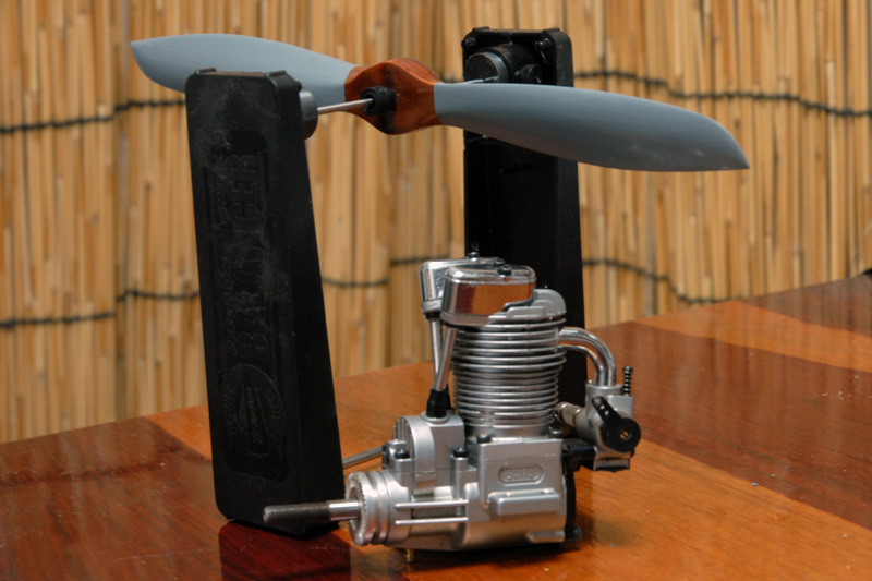

Too true! But then a stained and "gussied up" Zinger will have pretty much the same effect. Below are a dummy prop (of scale diameter and shape) and a prettied up flying prop I made for my Snipe. However, given that the original Snipe props were painted grey almost down to the hub, I guess an all grey APC prop wouldn't look too bad. Actually, I plan to use the same 13/6 APC prop I used for all my engine break-in on the maiden.
