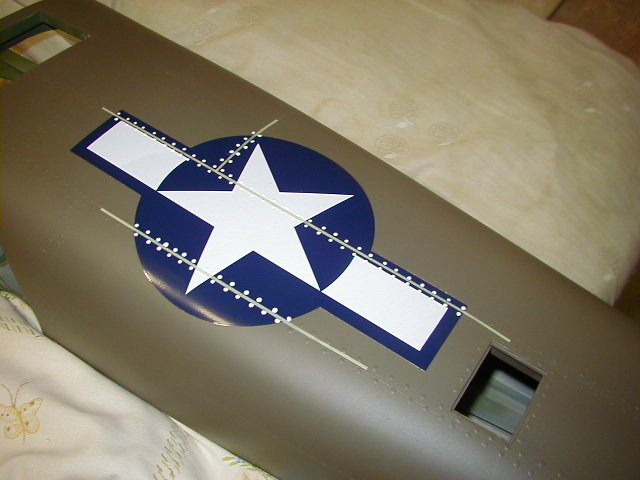

I was given a Pica Spit 1/5 scale half built. I already have a little spit that I completed as true to scale as I could.
My question is the kit has pressure sensitive decals and I was thinking of putting panel lines and rivets on this big spit. Has anyone tried to put decals over rivets?
If so was there a trick and did the decals lift around the rivets?
Or should I just airbrush them on like my little spit? On one hand I like to put lots of detail on my planes.............. but then I get too scared to fly them
. I thought if I try and keep the labor down and use the decals I might actually fly the thing more.
Thanks for your input. Peter

Peter, The Spit had flush rivets on the wing and raised on the fuse but the vinyl decals won't form to the panel lines and rivet detail. To do it right you have to use a high quality water slide or the best is to paint all of the markings on. It's not that hard to do and the results look real instead of something you just slapped on. Don
Peter, Don knows much more about your paticular project than I but I can show you how I used decals similar to yours on an airframe with lines and raised rivets.
Once the airframe is ready to start the panel line layout, tape your decals in place using a bit of masking tape. Do all of your panel line layout and then remove the decals leaving it smooth under them. Apply your rivets, again leaving it smooth under the decal areas.
Now paint the airframe, install decals, use some panel line tape for reffernce and apply glue rivets over the decals. Then remove tape. You will not notice the absence of panel lines on the decals and the transluscent glue rivets take on the color of the area that they are applied over. I then flat cleared the entire airframe.
While not dead to scale, the end results are good enough for all but the most rigid scale enthusiasts. Here are a couple of photos and a lot more can be seen on my B-25 page that is attached to my homepage below.

Thanks Don & Randy;
I might try that idea. I thought of trying to pluck the rivets off where the decal goes, but thought I would chip too much paint. I can see this already......... I am going to spend too much time on this plane and have another wall hanger
Thanks guy's Peter

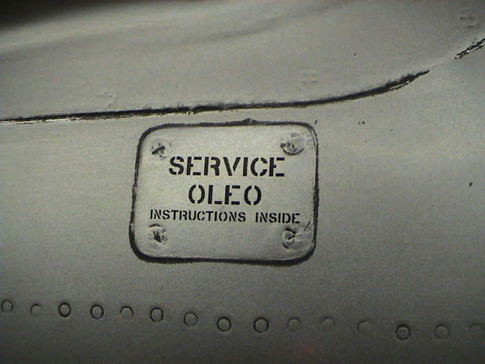

I tried custom made waterslide decals on my fiberclassics Mustang recently. I also had to apply some decals over flush rivets. I brushed some softener (Micro-SOL) on the wet decal which sunk into every irregularity. Of course the dried decal must be clear coated. See the pic below. There is decal material over the row of flush rivets between the two text blocks and as you can see you see nothing, no bubbles or something else. From now on the waterslide decal method is my favorite method.

It seems to me that the decals are printed on sheets from http://www.microscale.com/trimfilm.html
As I mentioned earlier I do not make them by my own. The decals are made by a one man enterprise in germany. But is is definitely stuff from the US. The decals come on sheets in US-letter format which is totally uncommon here in europe. So the url above might help.
That's the way I do it:
1. create all the graphics and labels and signs (not the insignias, too big) with CorelDraw or something similar
2. send the file to the manufacturer and check with him if everything is okay and looks the same as well as on his computer as on yours (then order, wait, receive....)
3. cut out the decal close to the border of the graphics/labels
4. apply some Micro-Set liquit with a soft brush to the place you want to place the decal
5. hold the cut out decal into hand warm water for about 10 sec
6. slide the decal to the place with the Mirco-set and align it
7. use a paper towel to remove excessive water/Micro-set
8. apply some Micro-Sol to the decal with a soft brush (you can also do that to a decal which is already dry), the decal will wrinkle horrible, but it will sink into every irregularities and will be flat after few hours. That step can be repeated several time. DO NOT touch the decal while it is wrinkled
9. when dry, it's time to apply the clear coat of your choice. I use 2 component automotive clear paint (glossy or dull). After that step the edges of the decal actually becomes invisible.
10. weathering/scratching of a decal: rub the coated decal with a polishing/rubbing paste (it feels like mashed potatoes) and stop rubbing with your fingers when the decal looks as desired. At last a final clear coating is necessary.
Granted, many steps, but the result is really cool. See the elevator of my Mustang below and a service hatch in the next posting.
