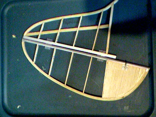

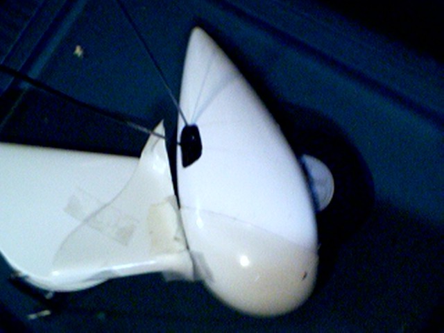

Hi there! I have an old Sig Ryan STA kit in the box and have laminated the wing tips, and fin tips, etc. Solid planked the fuse. I've spent more time trying to figure out how I'm going to put together and install the plastic stuff especially the wheel pants.. consider this an antique. I have posted another string about it - with a few pics. I now have the electronics installled, the fuel tank positioned and an OS 61SF engine mounted. Flaps are now operational. I am trying to use the original kit plastic pieces--except for hinges. Aelerons are to be adjusted so that they only move downward as designed. The flying wires were soldered to electrical post connectors having screw holes on one end. I am trying to submit some pics, but haven't figured out this new formatting.

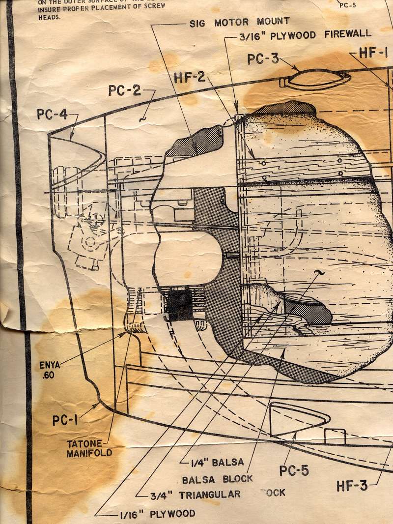

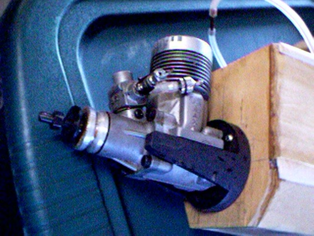

Some one above asked for a pic of the engine mounting. This drawing shows an Enya 60 on a Sig Motor mount. The second is a photo of my mounting of the OS 60. I would appreciate comments on the prop choice.

Nitehawk on your picture of your engine mount. For better air flow and cooling of the engine cut at an angle from just below the engine mount and taper back to the fuse blocks. I did this to my ST-Ryan and it worked out just fine for my SuperTiger 61. She's five years old and still going strong. Of course I converted her to a bipe and everone likes the looks. [8D] I've also got one with a Fox 75 on it and it pulls it just fine too.

good idea, thx. I'm going to have to add more attachment rails to that block to hold the plastic cowl.= and split the cowl for the muffler. What about prop size? Do you have a pic of the bipe? I'm getting an ASP 75 repaired after an uncontrolled run-in with some ground rock.

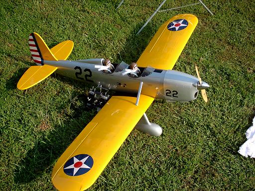

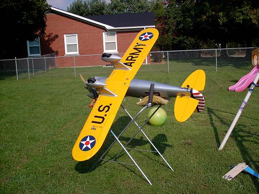

Hi: Flo
Here is my Ryan STA-M. IT's a G/P ARF kit with a G-38 an a smoke system. Flys great. I have to sale it to make funds for a jet i have.
wayne.............
