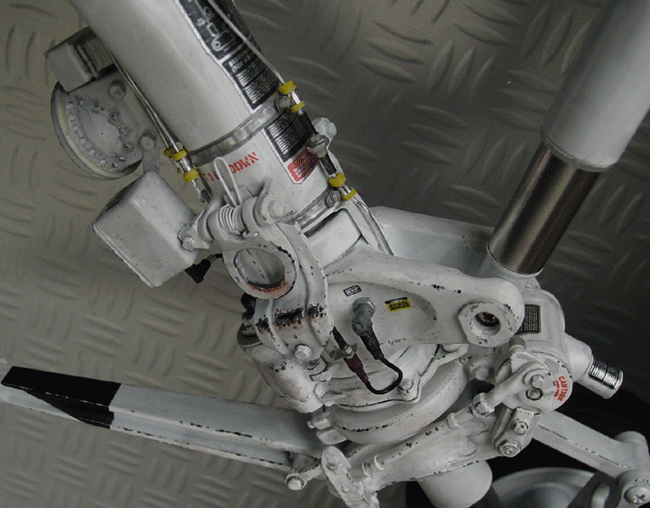

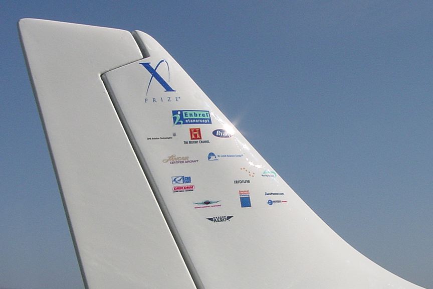

ORIGINAL: bps
Is the Krylon fuel resistant?
The Krylon is not fuel safe.
When I do inkjet printed decals, I use Krylon Crystal Clear on the entire sheet after printing and before cutting out individual decal footprints, otherwise the water would disolve the ink.
The Krylon simply protects the ink for the water slide application.
After the decals are applied, I use two-part automotive clear over the entire model (PPG).
I've only done relatively small decals, so can't comment on larger surface area applications, although all the small logos on the tail of my "New Spirit" Lancair is one big decal.
Paul

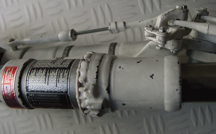

Old 08-19-2009 | 01:30 PM
My Feedback: (43)
Posts: 2,297
From: Carrollton, VA
Default RE: Laser decals
i dont care how many times i see that gear, I always find something else to drool over. To the uninitiated, that gear might as well come from a full scale Hornet. Heck, I bet you could fool more than one Bug driver/mechanic with just a quick glance... The ONLY thing in picture number 2 that gives it away is the phillips screw on the scissor link.
AMAZING work!

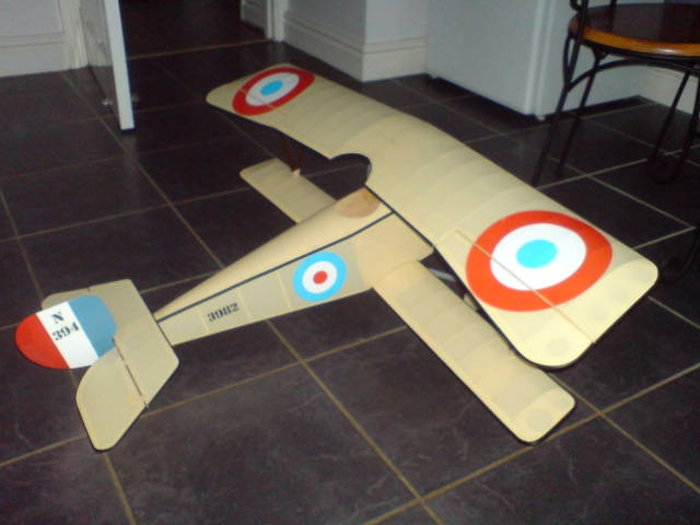

Old 08-21-2009 | 06:51 AM
Joined: Nov 2006
Posts: 13
From: huntingdon, UNITED KINGDOM
Abu, you will need white paper for anything that has white as a colour (roundels etc) clear is better for other colours, I used white laser decal paper to make the roundels on my Nieuport 11 and clear inkjet for the lettering, gave the clear a good coat of spray matt fuel proofer to seal them. I will give the whole lot a spray of matt fuel proofer to seal them to the plane. You may be able to get the paper cheaper from Ebay
