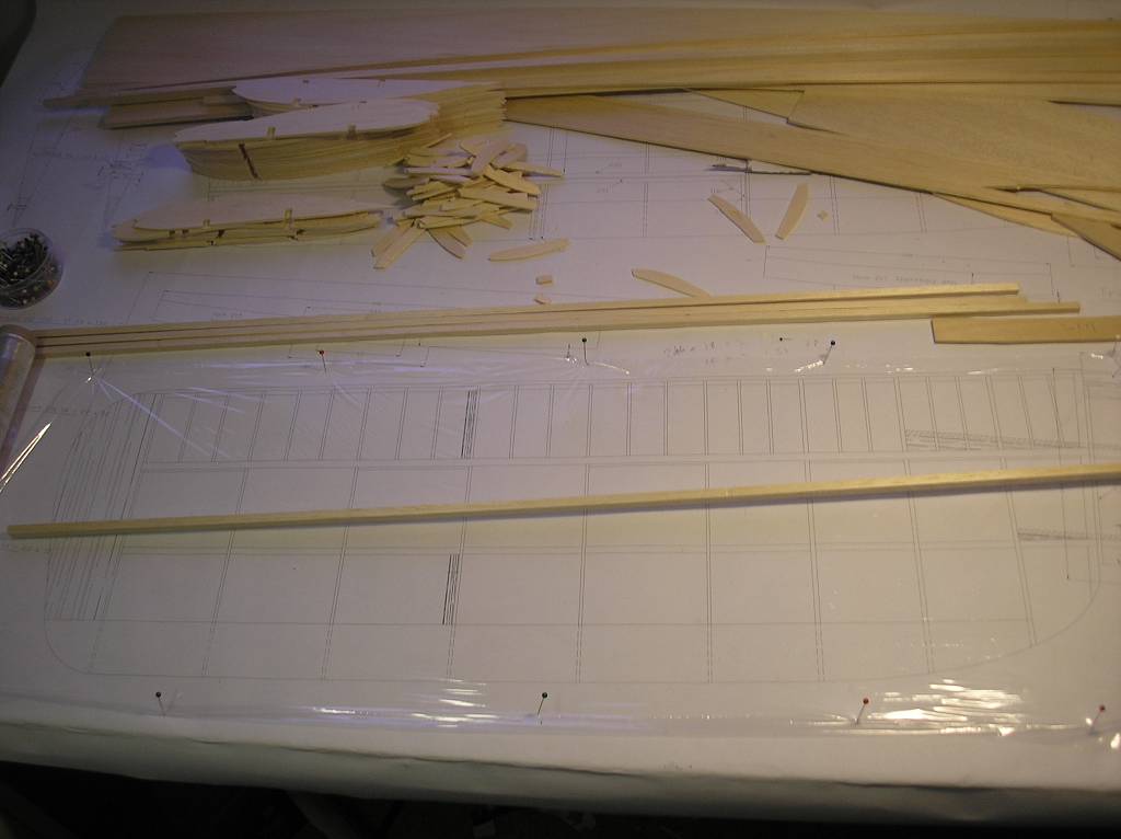

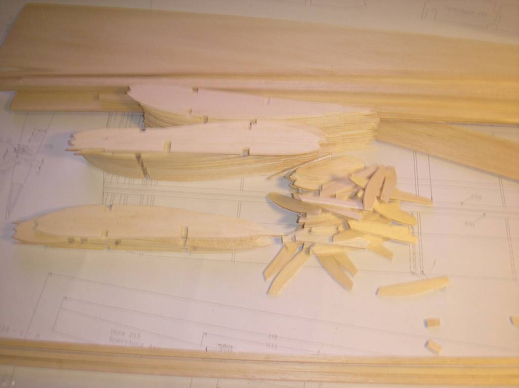

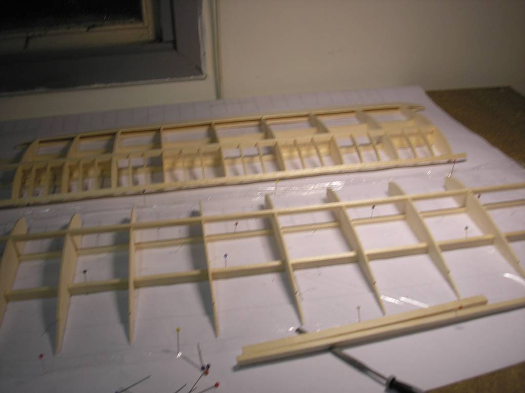

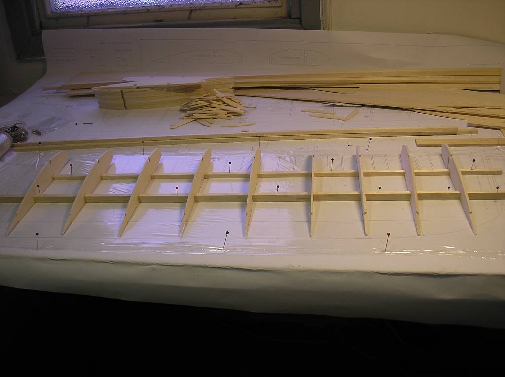

Embarking on this project I thought I might as well share it with the world, hoping to get some comments, hint and tips and (hopefully) praise
I'm building a Tiger Moth from plans found on the web. They're free, at least they're available to download, I really tried to track down whoever made them in the first place but I haven't been able to.
First off, the plans were printed, and I went out and bought a scroll saw. I'm building this thing in my shed on the lawn. I have no clue how to actually do some of the final fittings seeing as the space isn't quite enough to fit the entire wing span on the workbench. Also, being a geek I've installed a computer here for documentation and music purposes.
I've cut the ribs and half-ribs and I'm just about to start on the top wing, as that's the easiest one without any control surfaces. Wood was ordered form Heerdegen Balsaholz in Germany, and I've been very pleased with the quality so far. The plans doesn't always say what wood is being used so I'm making up as I go.
Attached are some photos of current progress. I'll do my best to update this regularly - and yelling at me to do it will improve on update speed. I'll really try to make this a thread that I myself would have loved to read.

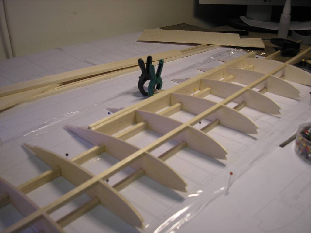

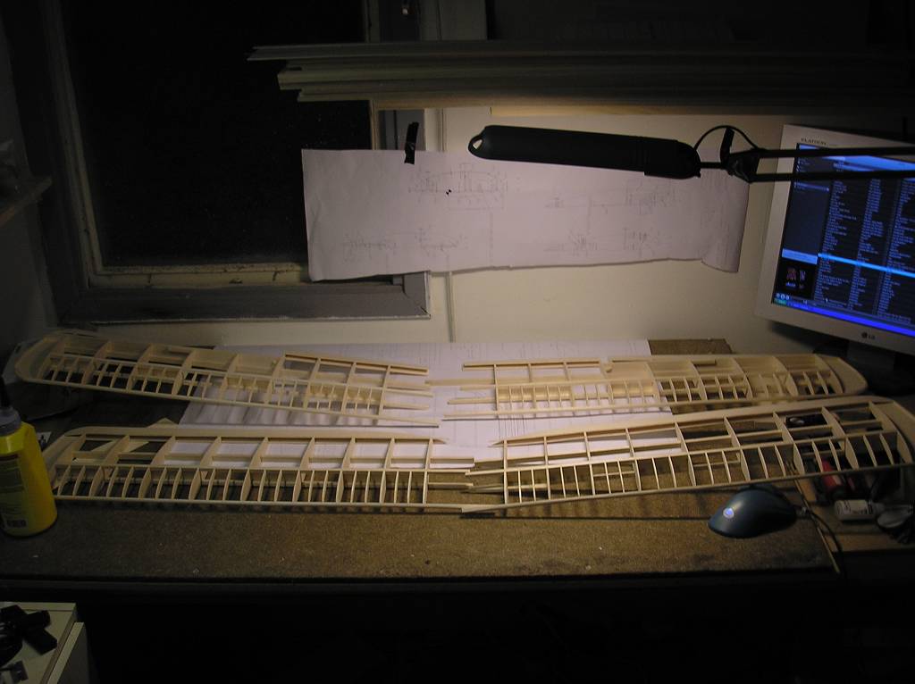

Halfway through the first left upper wing panel. Things of note here is that I have honestly no clue what the designer thought was the wing tip. The plans shows some solid thing there, if that is a solid piece of balsa or a flat piece perpendicular to the wing, I don't know. I figured I best cut a flat piece of 6mm balsa and try that, i can always add on later. And it's not glued in yet either
Here's a question for you guys, do you really think that the wing isn't supposed to have shear webbing between every rib? The plans are quite clear that the pattern you can see in my image is the one to use, but for me it seems sort of silly to not put shear webbing between every rib, the added weight must be minimal and the strength added tremendous. Any way, I made it according to plan and if you guys have any input on this, I'd greatly appreciate it.

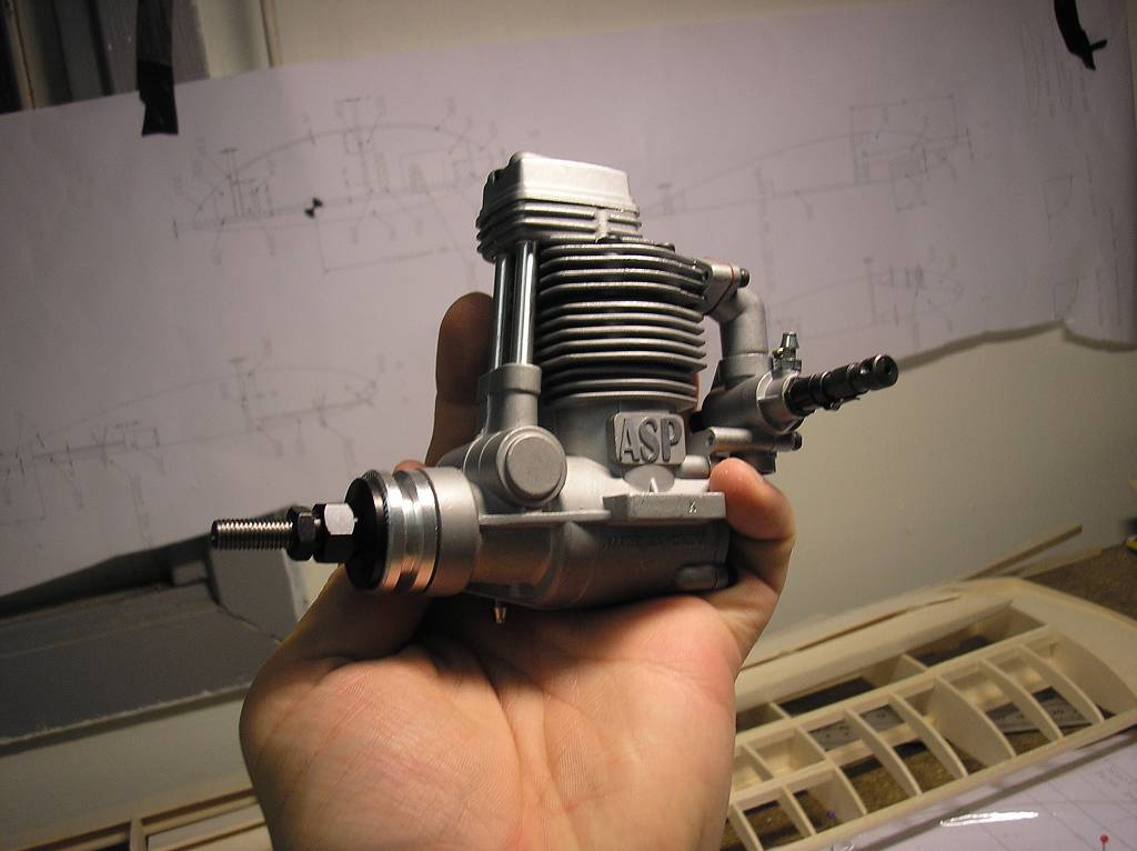

I thought I'd add a few more things. My intent is to power this bird with a suitable four stroke nitro engine. I'm not sure if a .90 will be too big or not. Colour scheme will most likely be that of the Swedish airforce from when the moth was used as a trainer. I hope there's a museum airplane around here somewhere for me to take photos of.
Yeah. I'm swedish. I blame any and all mistakes on terms and spelling on that simple fact
Also, if anyone has built a moth before this size, I'm wondering if it's a good idea to implement the same control system for the ailerons as on a full scale. As far as I can tell the full scale plane has a system with cables running inside the wing to actuate the ailerons with the wing having a short pushrod out to the control surface. I'm thinking about simply dropping a servo in each wings and if there are any visible wires that would have been used for this purpose to just model them as dummies to complete the look.

For a biplane with only a 59'' wingspan (1.5m), I'd say a 90 FS is way too big. Something like the Saito 56 (or the 62) would fly it beautifully.

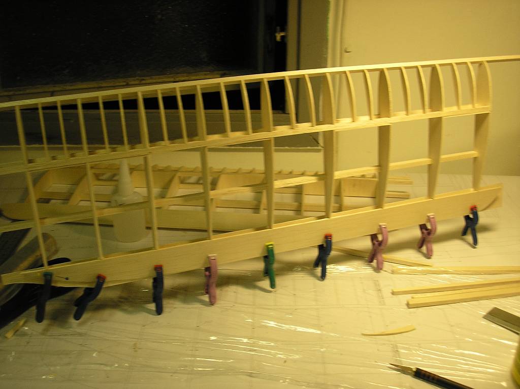

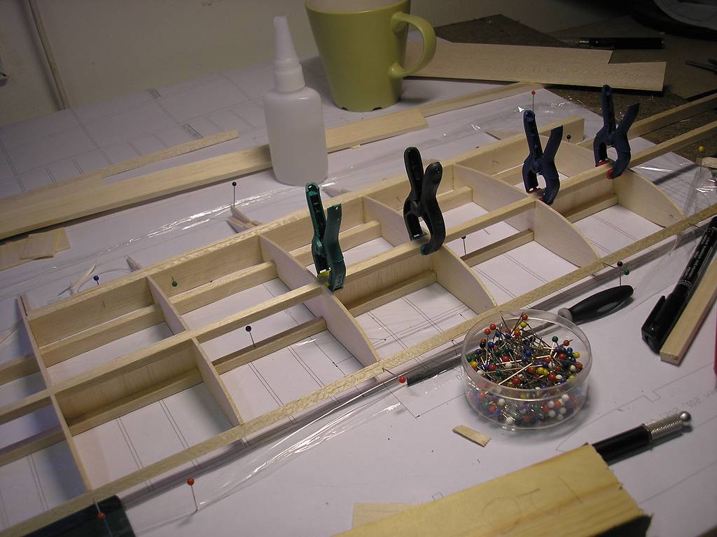

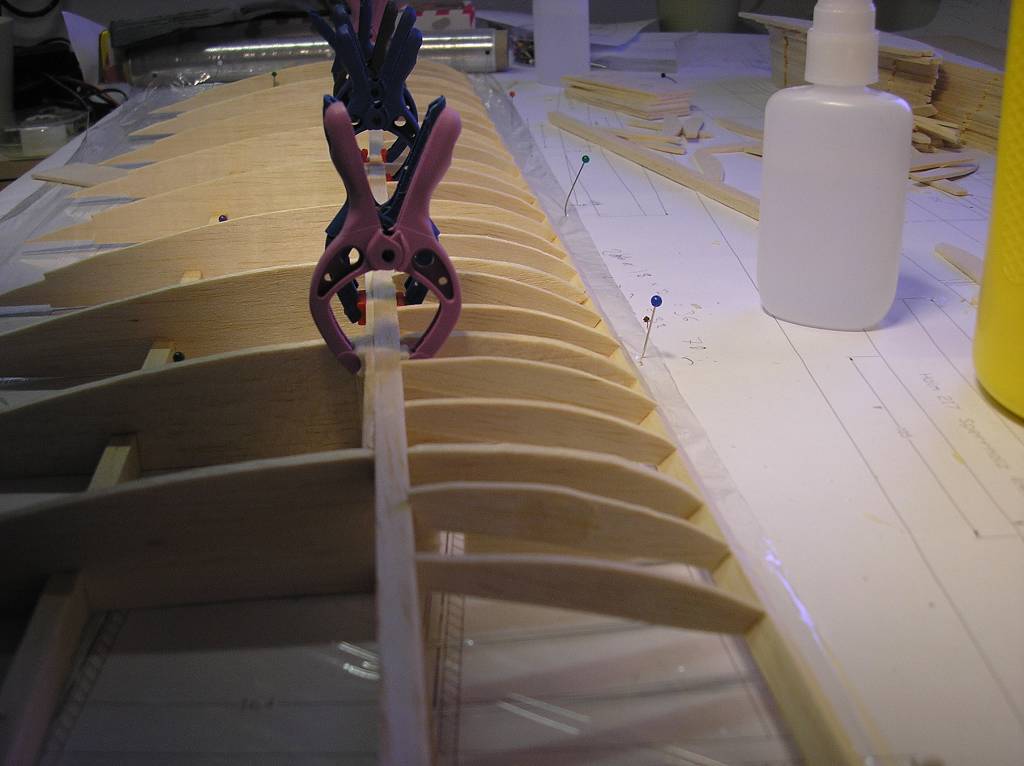

Yesterdays progress.

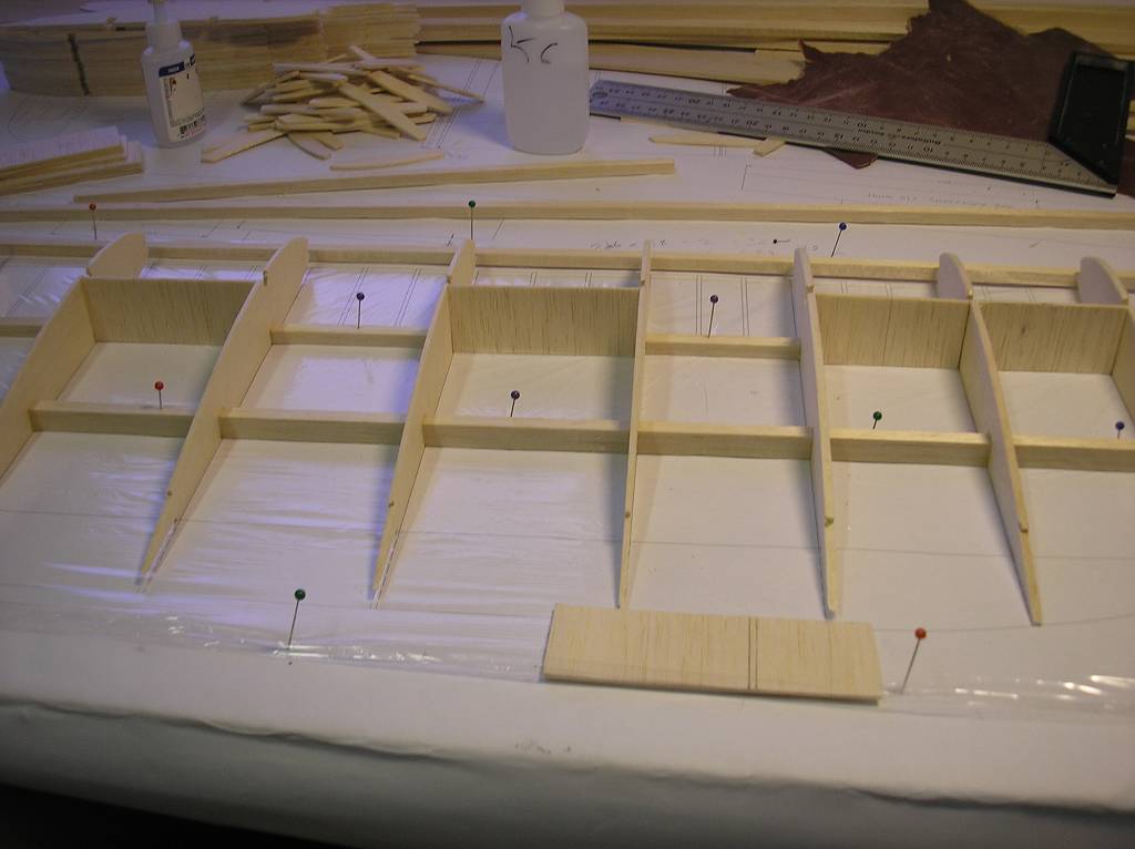

Trailing edge sheeting fitted. Looking pretty good, though I could have been a little more careful with my rib cutting, I have some smallish gaps to fill. Nothing much, but I promise the other panels will be much better.
Upper left wing half removed from building board. Decided to use 2mm sheet to construct the wingtip reinforced by some extra balsa at the tip of the tip structure and a few fillets. Should look nice. I've decided to put off sanding and shaping until the other half is done so I can get an idea of how the entire thing will look like.
Next up is the right half of the upper wing. As of right now it's dry fitted to my building board and I'm manufacturing the shear webs from some 2mm balsa sheeting that was previously cut.
I'm sorry about the sometimes quite crappy photography. I'm in this little shed without any real outside lighting, since my window is one of those bathroom window types with a textured glass surface and its also tinted with some unremovable film material. It is also cracked and needs to be replaced, but I'm a lazy man sometimes..

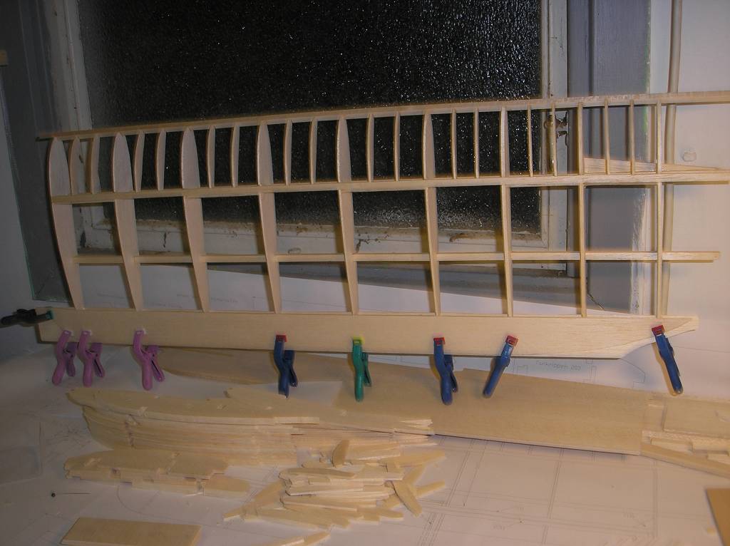

Todays and some of yesterdays progress: Second upper wing panel glued together. Decided on thin sheet with reinfoced edges for the wingtips, which will hopefully get built tomorrow.

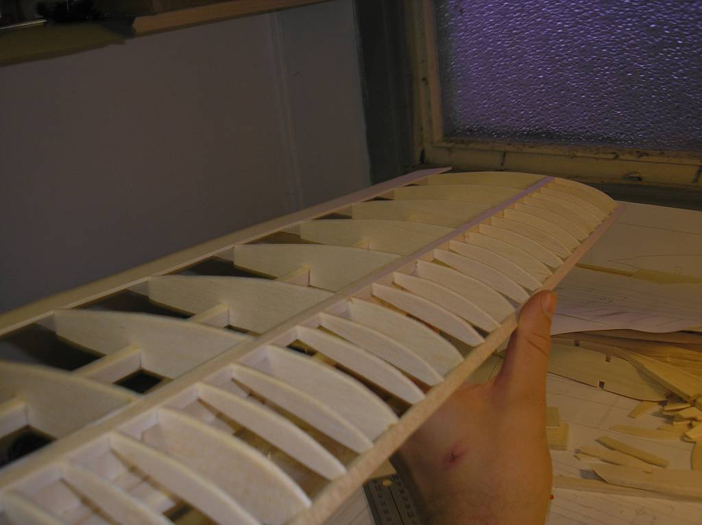

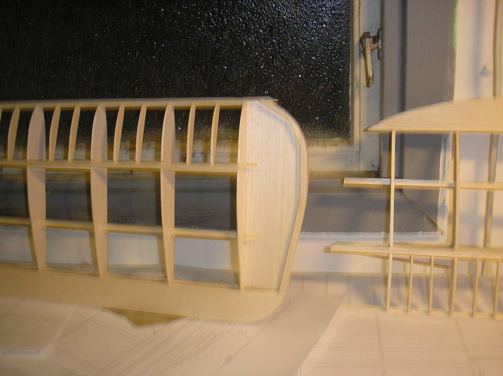

Right, I promised updates and a good build thread, I'm going to deliver. I got a bit distracted today, there was a dead calm and I flew four flights with my tiny Zoot Scoot. I realized I need a bigger LiPO for that one too.
I begun on the wing tips today, not quite finished yet, but getting there. They are build from a 2mm balsa base with 6mm stock reinfocements that will be sanded to shape later. Sort of a fiddly job. I used the old method of "glue logs together and carve away what does not look like a wingtip" with the reinforcements. I need to make a new sanding block now and I'm out of both good #11 blades and 80 grit sandpaper.
I think the next step is going to be some of the details I left out. I need to cut some slots into the right wing panel to accomodate the dihedral braces. I did it for the left wing but forgot the right one... There are also two reinfocement beams which should hold the fasteners for the wing supports. Those should go in soon. Then I'm going for the center section, i.e. the tank on this kind of plane.
I thought I should add - I'm in no way a master builder. In fact, this is my first large scratch build and my third overall plane. So sometimes this is a learning experience for me, and I hope to inspire someone reading that building from scratch isn't so intimidating.

Well, I have shaped the leading edge and wingtip on one of the wings, then I got a bit sick of the sanding and began to plan ahead for the tank/wing joiner. I have noticed something odd, the plans doesn't really match up. One of the wing center beans is too wide and one is not present in the cross section.. hmm.. Also the tank bit either needs to be elevated a bit to get the proper scale look of a fuel tank sticking up or the plans depict a model of the tiger moth which had a tank that isnt sticking up. I have decided to put that on hold in order to not get stalled on the build progress. I will shape the wing tips and leading edge of the other wing and move on the the lower wing pairs probably.

My advice would be if the 90 engine will fit in the cowl go ahead & use it.
With a smaller lighter engine you may end up stuiffing useless lead in the nose to get the balance right so if the bigger engine fits just use that. You will be able to spin a bigger propeller & the engine will be just chugging along & sounding much more scale like than a smaller engine running flat out. Plus you will have a bit of extra power when you need it.
I have a DH 60 Moth at 1.5 me span with an Enya 80 four stroke (twice the size recommended) and the combination is ideal. I use Sig Koverall on fabric covered models & I'm very happy with it. - John.

I'm not sure, but I think the ASP engines are marketed as Magnum in the US. I've had a couple and, yeah, you can't beat the price on the Magnum. But there are quality control issues. It you get a good one, it's as good as any OS engine. On the other hand, you might also get a dud. One of mine was great. One was pretty hopeless (poor compression, difficult to start, lots of deadsticks). So you pays your money and takes your chances.
I'll report once the thing has been broken in, which will probably take quite a while before I get there.
