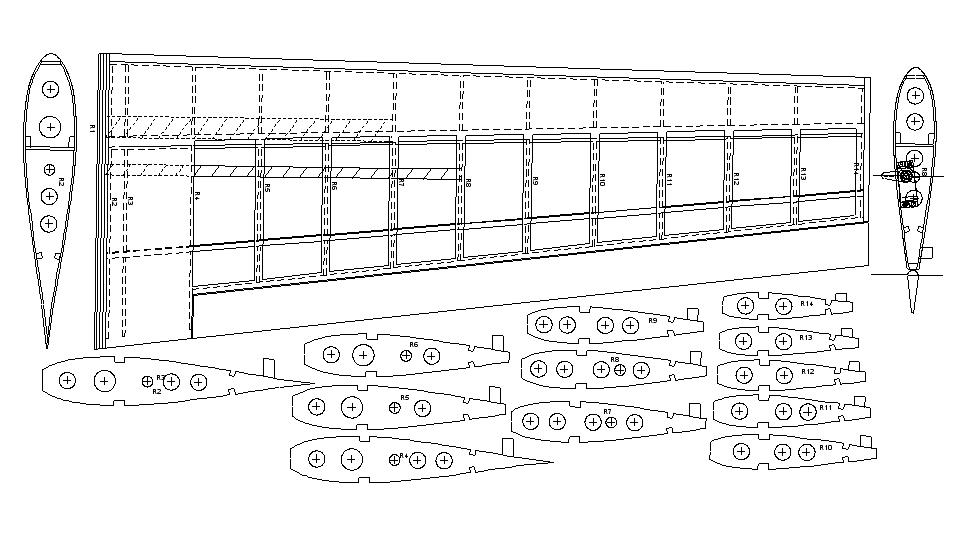

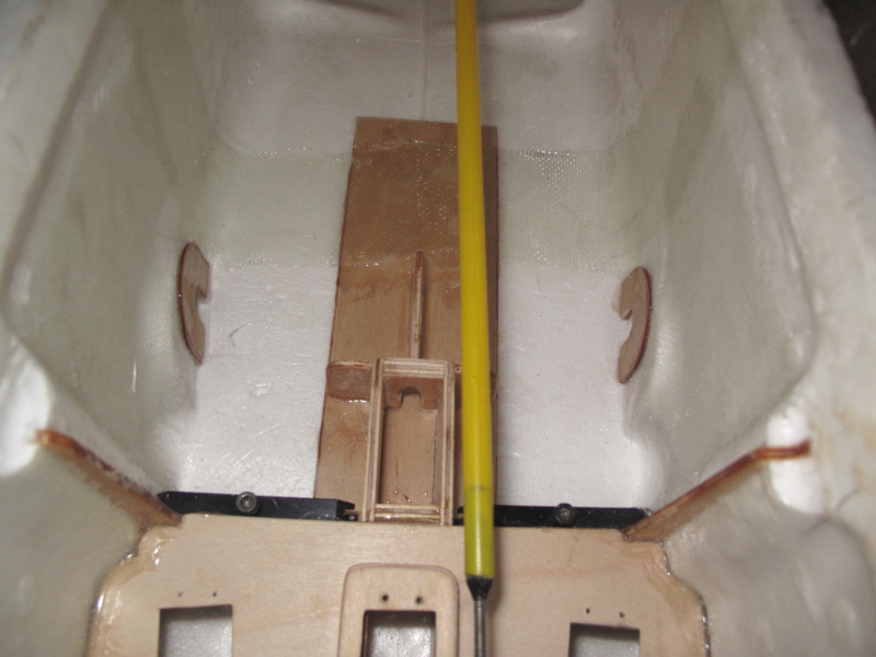

After selling my fleet to fund a move and career change, I was looking for a good sport/aerobatic plane to get myself back into the hobby. I found this kit up in the attic while moving and thought this would be a good plane to fit the role. I bought this kit in 1999 for a steal to use as a test bed for a prototype engine. I started building it, but never finished it. I did get far enough to ruin the wing panels trying to fiberglass them. So I am starting out this time around by redesigning the wing. I am hoping I can fix the nasty tip stall known to this plane at the same time. I also plan to skin the fuse and tail with 1/16 " balsa before finishing the whole plane with Monokote. I plan to use a Zenoah G-26 for power. I am a scale builder/flyer, not a 3D guy so I think this should be enough power.
The first picture shows the current state of the fuse. The second shows the new wing plan which I have been drawing. I'm hoping to have the plan done and to start cutting wing pieces this coming week.

I am abit concerned about the G-26 having enough power. I think if I can keep the finished weight under 15 lbs. I'll be ok. The flaps are an interesting idea. One set of 3-views I found for the 21 actually shows flaps on the full scale. I might have to give them a try.

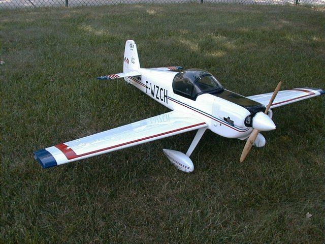

Beauty cap, drifter!
Good to see another Cap build! I'm looking forward to seein' your complete set-up too.
Do you notice the same twist in the fuse as I do when you hold the front and move the t' deck side to side? Watch where the back of the cockpit and turtle deck meet. Is this a concern? Does the 'glassing help or should we figure out a solution?

The original owner crashed on his first flight. The gasoline tank burst and the gasoline ate the foam from the firewall back to near the end of the canopy.
He threw the remains in the field trash can. I went dumpster diving and salvaged the remains.
I rebuilt the fuse from the rear of the wing forward out of 1/2" balsa. I figured the forward weight would help. I used some parts (canopy, cowl, etc) from a kit I had on hand.
The new front section was glassed onto the old rear. Thus no twisting. I would glass the inside of a new kit at that turtle deck - rear wing junction.
I have the remaining kit parts stored somewhere. Just have to remember where and dig them out.
The control setup was per the manual. It flew fine.

The plans for the new wing are printed. I am out of town for the holiday and will start cutting ribs when I return.

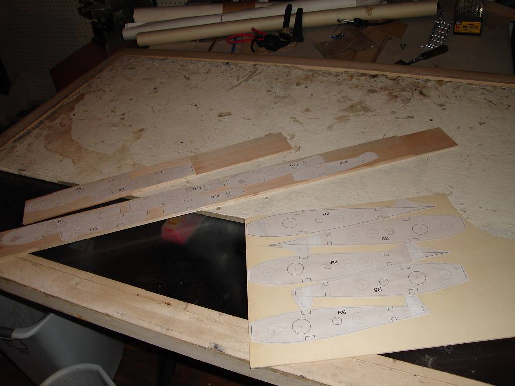

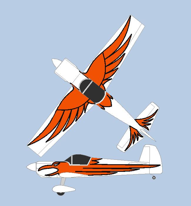

Well I haven't been as productive in the last week as I hoped. I did get the rib templates glued to the wood and ready to start cutting, but that's all the farther I got.
On another note, got the color scheme figured out thanks to some help from Dynamic Decals. They drew up a couple designs based on some ideas I had and emailed them over to me with some color options. Attached is their sketch of what it should look like when finished. The orange color in reality will have a heavy metal flake finish to it. They are starting to work on the vinyl graphics and I would expect to have them shortly.

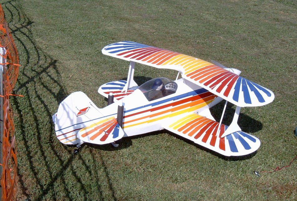

Scale schemes can be hard to see. I've built two P-51's with the Flying Undertaker scheme. As much as I like the colors, everything but the yellow spinner would disappear in the sky while making the turn from base to upwind. Its been a few years since I've finished a plane without a scale color scheme, even my foamys. I've always told myself that if I built a model of a homebuilt or aerobat then its still scale if I finish it the same way I'd paint the full scale :-). As for competition, I will leave that to the Flair Stearman that's still new-in-box. Revy, if you are looking for a cool scale color scheme, I found one that's pretty cool. I will post a pic when I am not net surfing on my phone.
Tom, when our head hind is west to east, I get that sinking feeling with the Edge, lol. The whole thing disappears for a sec. Blends right in.
I am trying for my first scale look but if I can't see it then what's the point. I'd be taking the "walk", lol!
I am looking forward to that other scheme, F-T, as I'm still on the fence. This is the hardest part, I think, picking a color!

Reds, Yellows and oranges have a similar contrast to white and they can blend together. This and shilouetting happens to people with even perfect vision.

With the holidays going on, I haven't had much time to build. I did get the wing panels framed up, but that's about it.
