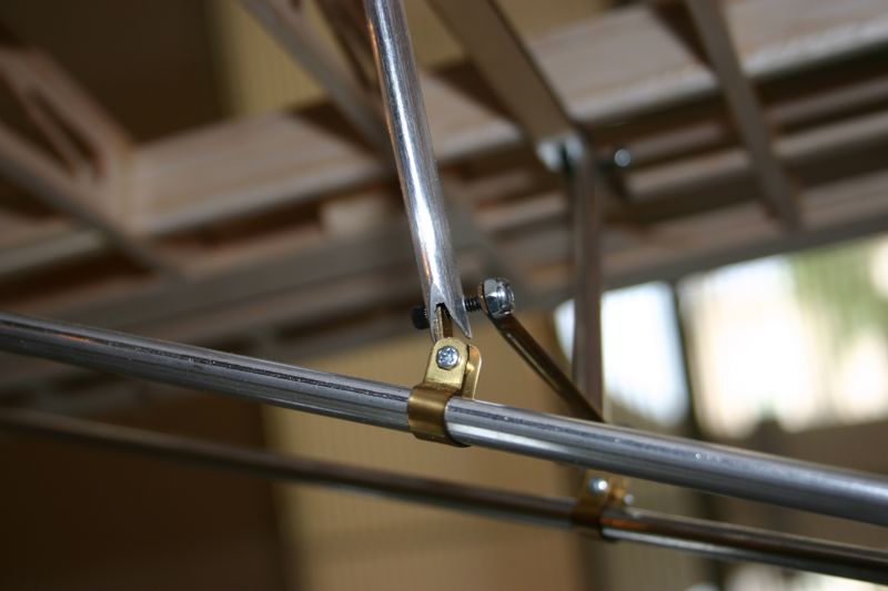

I received the great planes 40 size cub kit. I am wanting to clip the wings. It seems the kit does not offer the vertical support struts whether building the full span or clpped wing. Do most builders add these? This is what I'm looking to duplicate instead of the usual clipped wing color design...
The vertical struts are called "Jury Struts". Their purpose is to prevent the main struts from bending or folding in the middle under load (Negative G's). They are easy to add and I wouldn't think of flying a larger model without them. Some of the smaller planes omit the jury struts due to the strength of the main strut and their relatively short length.
Another consideration with struts is are they functional? Many models had the struts for appearance only. On my Sig 1/5 Scale Cub the struts are functional. Without them the wings would fold immediately. The two wing halves are in no way connected to one another. Like the real Cub this use of the struts creates an extremely strong airframe. The stress of the wings lift is spread out around the fuselage instead of concentrated into the middle of the wing.
Good luck with your projects,

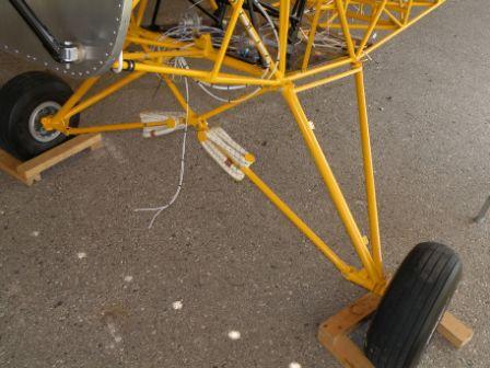

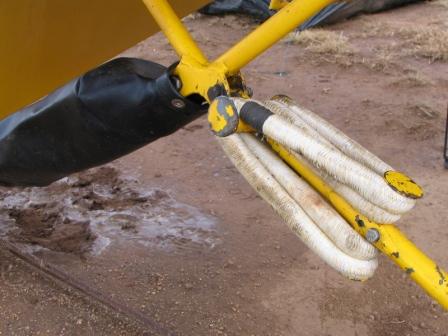

I'll dblecheck the plans, etc as I got it for Christmas and haven't thoroughly looked it over. Either way I'm using the struts and will add the Jury struts. 142 is a lot of beans for gear... definately making my own. Hinged at the top and bungee allows the sliding "in and out" of the tube over the rod as weight is applied and removed on landing.
courtesy of steve barker on rcscalebuiler.com

As an alternative to a bungee, I use two large "O rings" attached to each side. Work great, too.

Did you solder the brass couplings to what looks like aluminum or is it just crimped tightly? Is there anything inside the faired aluminum struts to increase stiffness?

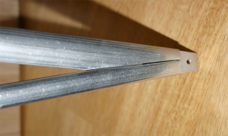

The struts are hollow aluminum, nothing inside. They came out plenty strong for the 1/5th Scale model and I plan on using the same material for my 1/4 Cub. The brass couplers for the jury struts were made in such a way when the bolt passing through them is tightened the brass tightens around the strut. I also JB Welded them on to make sure they didn't move.
The ends of the main struts consist of flat aluminum I cut to fit within the airfoiled struts. These pieces were roughed up and "barbed" along the edges in direct contact with the struts interior to prevent them from pulling out. They were ultimately JB Welded into the struts. Attached is the attachment point for the strut where it meets the fuselage, prior to it being JB Welded. Not a very scale attachment but they work great.
If you look really close at the seam of the strut you can see the aluminum plate inside. This plate is "V" shaped end extends down each strut past the joint several inches.

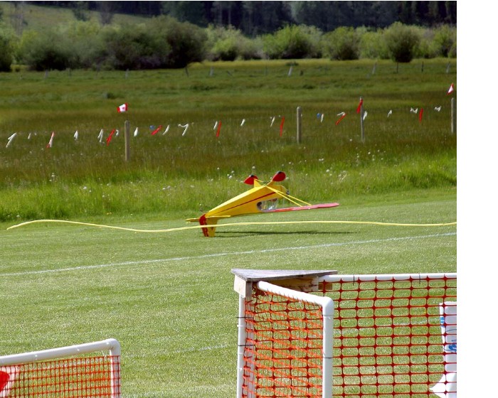

I have never seen anyone try to drag a cubbie's tail down the middle of the runway.
Now you have!
The ending was not pretty, though......
