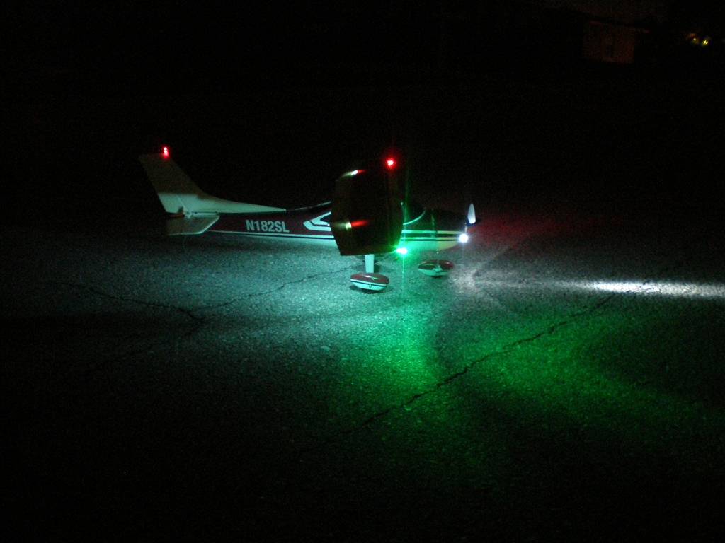

Here are a few pictures of mine. Sorry for the quality of the pictures. As soon as I get my Lancair done I'll post pictures of it also. I'll probably cut the wing tips out for the wing lights and install clear covers over them so they look as scale as possible.
ID:	1350595   Click image for larger version
ID:	1350596   Click image for larger version
ID:	1350597   Click image for larger version

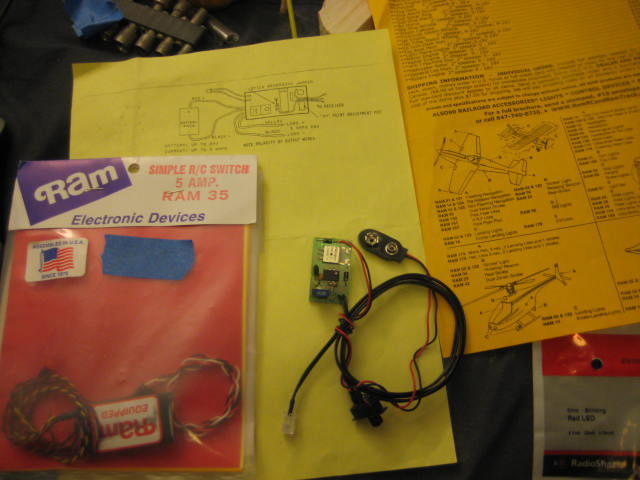

Old 01-20-2010 | 08:04 PM
Joined: May 2008
Posts: 86
From: High Point, N.C. USA GA
Default RE: Navigation Lights
Hello,
Try giving "Dreamworks Model Products " [link=http://www.dreamworksrc.com]Dreamworks Model Products[/link] they have differant Kits and light Dia.
Also check with " [link=http://www.RAMRCandRAMTrack.com]RAM R/C LIGHTS[/link] , they have several simple E-switches / kits for NAV. lights
Or last resort,,, Build your own From a electronics store / suppy house , Radio Shack Eg..............
Hope this helps,
Mark K.

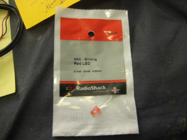

ID:	1360457   Click image for larger version
