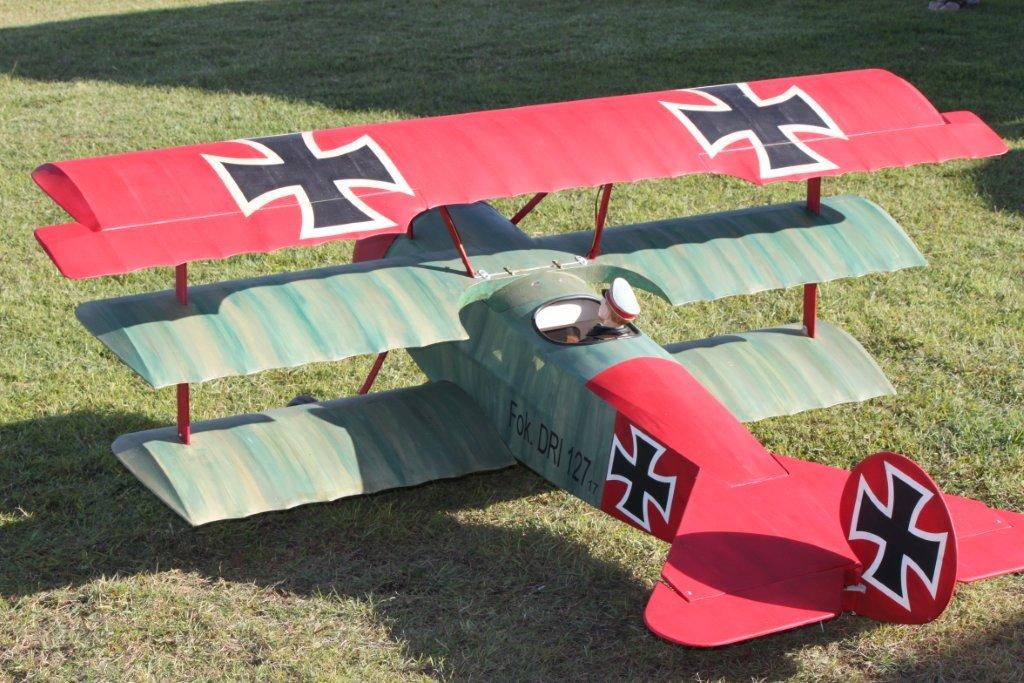

I've finally finished painting my Tridecker and it's being assembled. I settled on the camouflage colour with the light blue under the wings and the messy, streaky green on the fuse and middle and lower wing tops and really enjoyed the process. It is covered in SIG coverall so rather than stickers which would have looked too shiny I cut masks for the iron crosses and lettering and it looks great, even if I do say so myself
Now I have to finish Richthofen to go in it and I'm really looking forward to getting back to pilot making. I'll have some pics soon I hope of the progress.

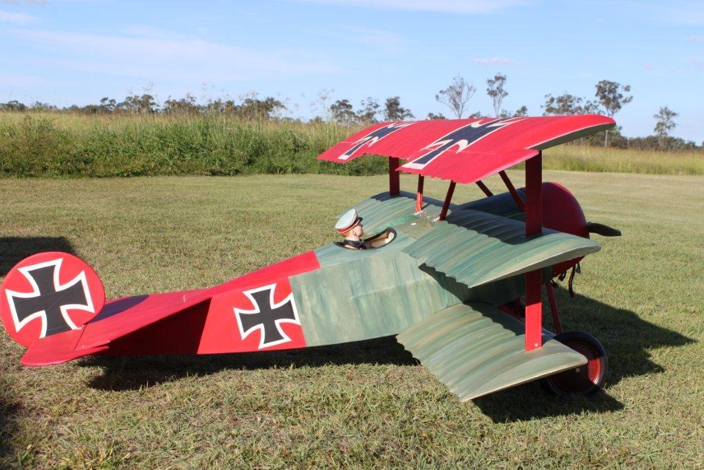

Hi again, just a couple of pics of the Fokker all painted up and it has now had 4 flights! It came in at 17lb so Richard was a bit nervous before the maiden but it flies beautifully. After the first 2 flights a very unscale tail wheel was added but at least now it's manoeuvrable on the ground. There are still lots of little things to be done - the machine guns mounted, Manfred needs a better seat belt so he sits up a bit higher and he needs a proper flying outfit. Just to have something in the cockpit I got his head and put it onto the body with Stew's uniform as it had the leather jacket and looked somewhat decent!

Looking great there Patti!!

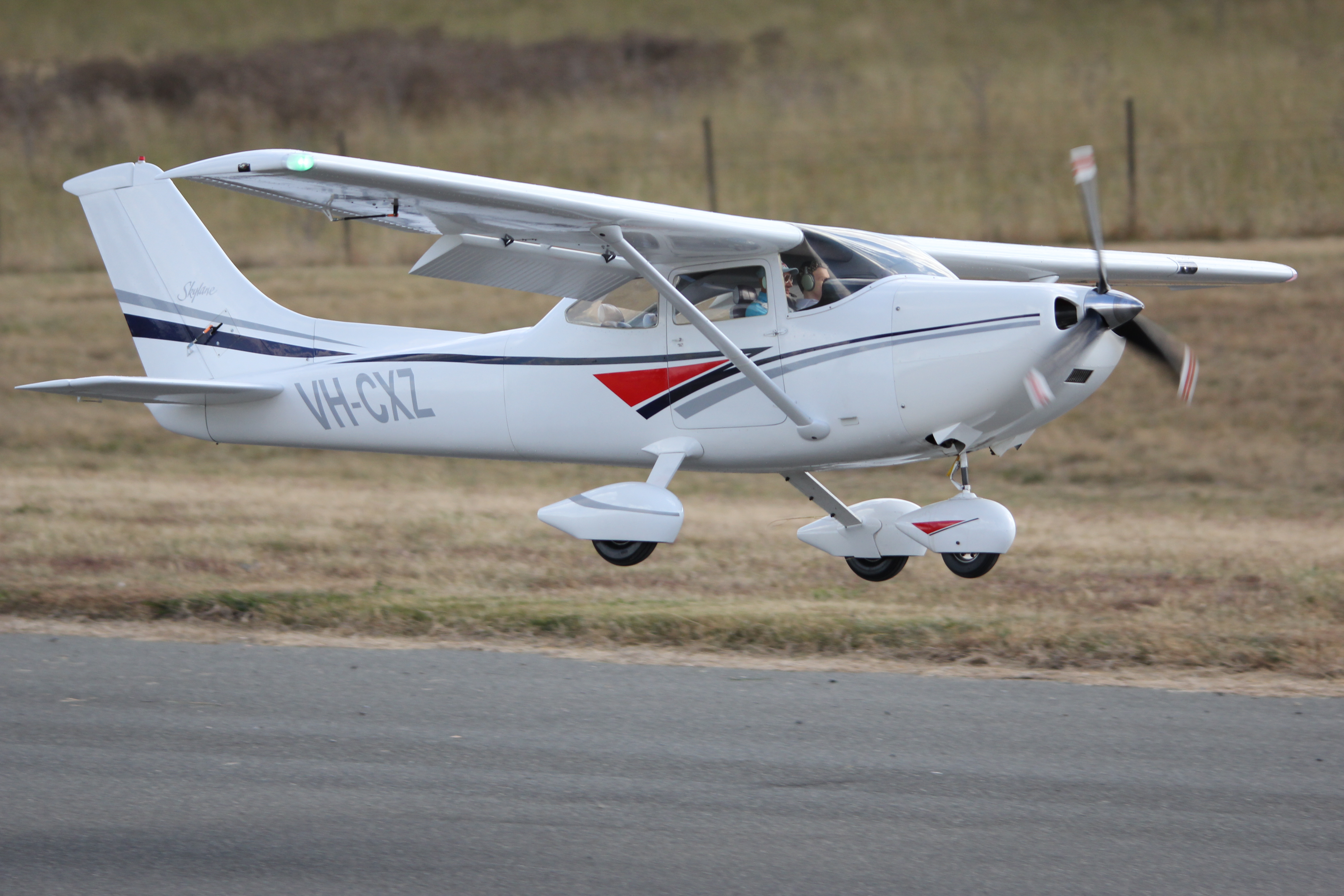

Was flying at Twin Cities this weekend for their club event. I had both Cessna's present with mini and micro Steve's.
They both really do look the part even if I may say so myself.
Thanks again for all your efforts in making my pilots.

It looks so real and I can recognize you even in that photo! Glad to hear you're all having fun
There's a lot to do on the Fokker still as you can see from the pics, no cockpit yet. For Manfred I'm making the big outer leather jacket with the fur collar first as that is all you'll see while he's in the plane and I'll probably do another head with a flying cap instead of the service cap although I rather like the look of the green and red cap!
Just for your interest, the 17lb Fokker is flying on 24 x A123 batteries arranged as a 12S -2P giving 40 volts and 4600 mAh. That gives 12 minute flights with a 20 minute recharge for under $200 of batteries and just the one pack charged in the plane. The A123's are way more robust and forgiving than lipos.

Very nicely rendered Tripe Patti, congrats. Mine will be Nr 152/17 which is done in a scheme very similar to your Nr 127/17. Hope it turns out half as good as yours..........John

Thanks John, I'm probably biased but I think they look great in the air and so easy to see in that colour scheme. Have fun with your build.

Hey Patti, The Tripe looks GREAT! and Manfred looks right at home in the cockpit. I know you will agree, no matter how good looking the model, they look like a model UNLESS the pilot is convincingly realistic. With the photos posted of your Tripe and your customer's Cessna, one has to do a double-take and look very carefully to see if they aren't an actual aircraft. That is because the pilots look so REAL!
Great job by you and your customers!

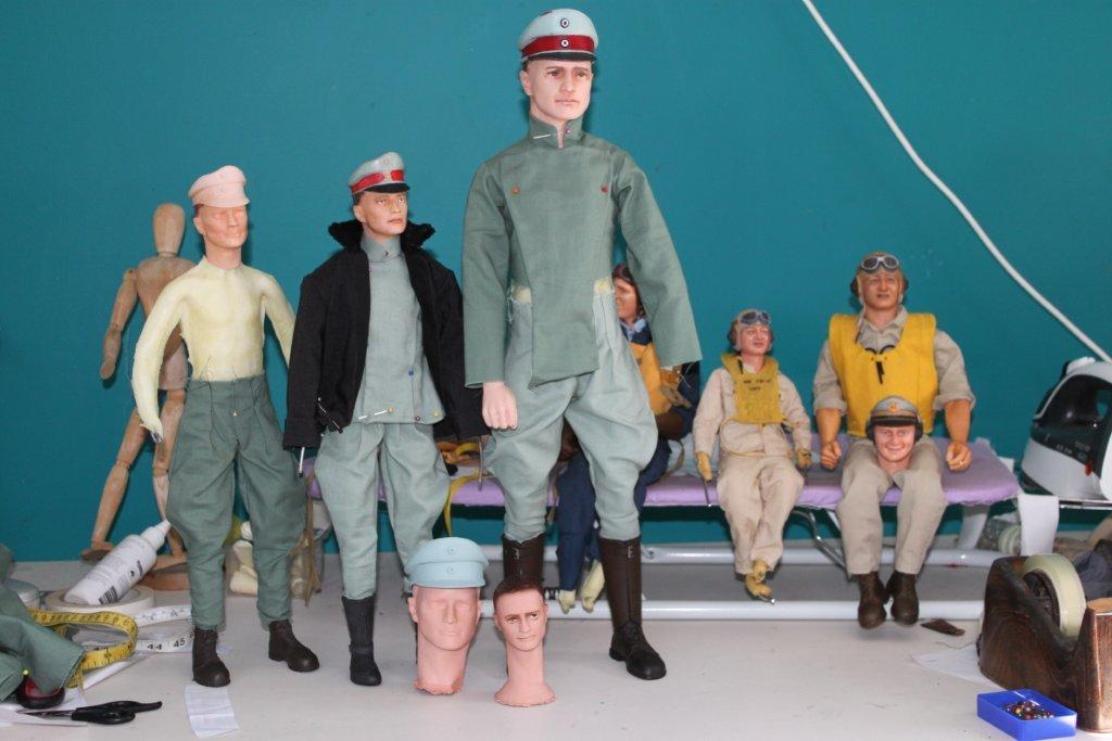

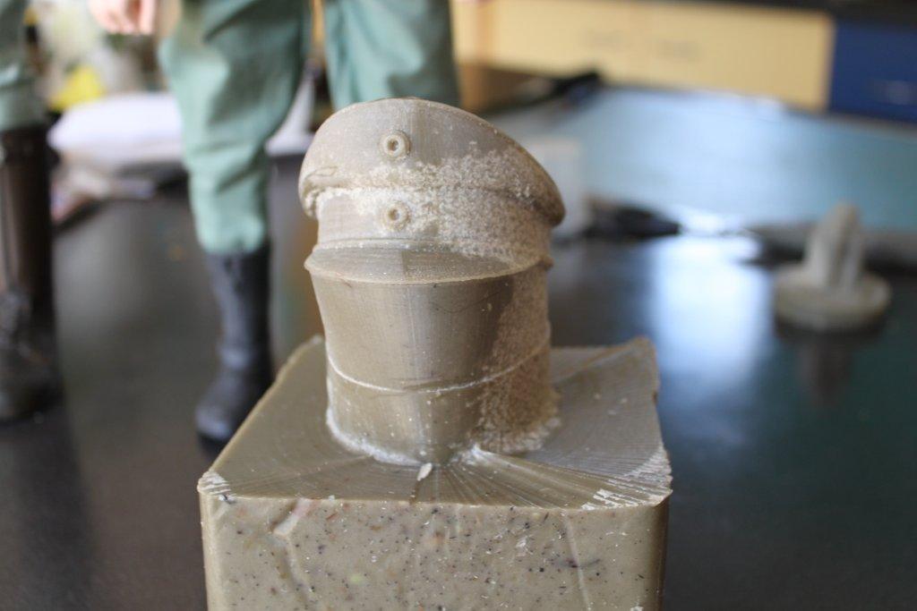

On the pilot front, Manfred von Richthofen in both 1/4 and 1/3 are substantially finished. The service jacket has proven to be somewhat of a challenge to make and I’m at the final post just trying to get the collar to fit properly and meet in the middle and after several attempts have put it in the cupboard for a few days! Sometimes you just need a break and come back to it fresh.

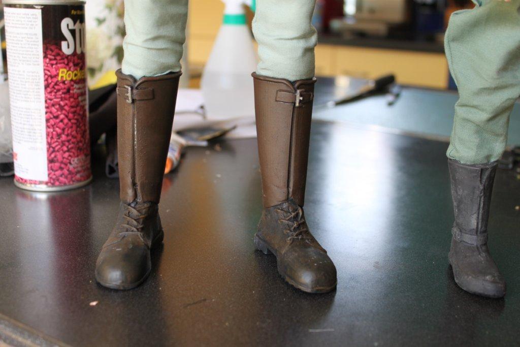

The boots with the gaiters look terrific but they have taken time as they were cut as 2 separate parts – the boot itself and the long gaiter and then joined together. It was easier to machine them like this than the right angled shape of a long boot but it meant 4 cuts for each size. Then the wax has to be tidied, joined, re-tidied then moulded.
I made a flight jacket and on the quarter scale the leather looks good but a little bit stiff for the size to look great so I tried several different types of fabric to see if something else looks convincing and falls better. I haven’t made the 1/3 scale in the leather as yet, that will be interesting. Moulds for the buttons for the service uniform in both 1/4 and 1/3 have been made along with the iron cross, the pilots badge and the German Blue Max medal (Pour le Merite).
I have some pics taken a while ago, it shows the two scales of Manfred side by side. Big difference isn’t there?! There are actually 2 different heads and neither are finished - the big one looks like a zombie with those white eyes but that is the head we have decided to go with and has a separate service cap. The other head was a bit too lean and mean looking and had the cap moulded in all as one. With the larger scales like 1/4 and particularly 1/3, it is possible to make a flying cap and I’ve experimented using stretchy fabric for a better fit. The boots on the 1/4 scale are not the correct ones, they’re the RAF spitfire ones just put on for the moment. The 1/3 cap is in the foreground cut into the wax block and a closer picture shows some detail. The brim had to be carved out by hand. With something as thin as a brim it’s too easy to break or chip the wax so I moulded and cast the rough cap and then worked on this as a new plug. Far easier to sand and work the one cast from urethane.

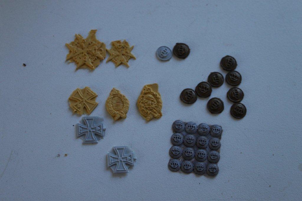

I’ve just taken some pics of the moulded badges etc, all untrimmed and unpainted and there’s a line up of various stages of Manfreds – to prove something is still happening!!
Hopefully now that we have some help and a new machine on the way things will continue to progress.

Thanks John, but he'll look better when he's painted
Also once the red piping detail goes onto that service jacket it will make a huge difference. The collar has come out of the cupboard again! I've thought of a way to keep it perfectly in place thanks to another look at a photo of an original.

You need to take a sewing machine in to work for when it's quiet! I'm having a training session with my daughter Katherine in the morning to help her with the sewing. She has a late start at work so is coming round for a lesson. It's much easier to show someone than try and explain it all in writing.
I also found half a 1/6 body that was cut in wax ages ago, just the front half. It'd be good to have the right size body as the Dragon/BBI etc accessories are a bit short in the body. We're just a little concerned that the legs and arms of our model are so thin that our 3mm wire may not embed properly. Perhaps we could thicken them up a smidge.
The mill arrived and will be fantastic but unfortunately there's about a 6 week wait to get the cnc kit to go on it. Then it has to be installed so patience is the order of the day I'm afraid.
The oxygen mask is proving to be a real challenge. After producing one perfect one the first time we have not been able to repeat it again. The first one was too big, more like 13/ size so Richard recut the wax plug and so far I think I've made about 1/2 a dozen moulds. The silicon material we're using will no longer release from the mould and some of the earlier attempts I did use the wrong release agent but after waiting about 3 weeks to get the recommended release agent, even that didn't work! It means throwing away the stuck mould and starting again every time but we'll get there eventually.
