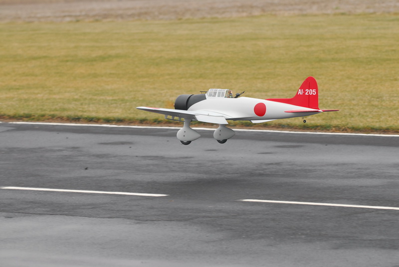

I won the same Airtronics radio you have at a contest last Fall and have installed it in a Val dive bomber. The flap setup is a bad deal with this radio. On my JR radios I can use two channels for flaps with one the master and the other as slave. The slave is set to run opposite to the master and the flaps deploy normally. This cannot be doone on the RDS 8000 because, as you have learned, the normal flap channel does not allow you to define a slave channel. If you pick another channel to be the flap master, then you are limited to two-position flaps. So I reworked my initial installation of the flap servos so they are installed in the same orientation, rather than mirror images as usually done. Then they work OK off a "Y" harness. A reversing Y ought to work with mirror image servos, but I have never used one.
I then followed the manual for setting the center and endpoints, and took what I got for "half flaps". My JR radios are set up with a knob for proportional control of the flaps on those models.
I use forward switch (towards the top of the transmitter) for flaps up. Others' brains probably work with different logics and use the reverse.

That's a bit of a bummer, but since mostly I do WWI stuff this hasn't been a problem. Anyway, thanks for the tips and tricks. The "same orientation" trick works fine and all I needed to do was turn the servo hatch around, flip the servo over, and realign the control horn. On an ARF, this is no problem, but would be a serious annoyance on a serious scale model.
I think for me (and my left-handed brain) pushing the switch DOWN for DOWN flaps seems the most intuitive. In one of the MAN publications there's an article by Roy Clough (Jr.) titled "The Merry Modeler's Mindset" and it's all about how setting up switches and such on a model in a consistent "mental orientation" can save the your model. For example, switches are "on" if upward or forward.
Nice Val, BTW. [sm=thumbs_up.gif]
